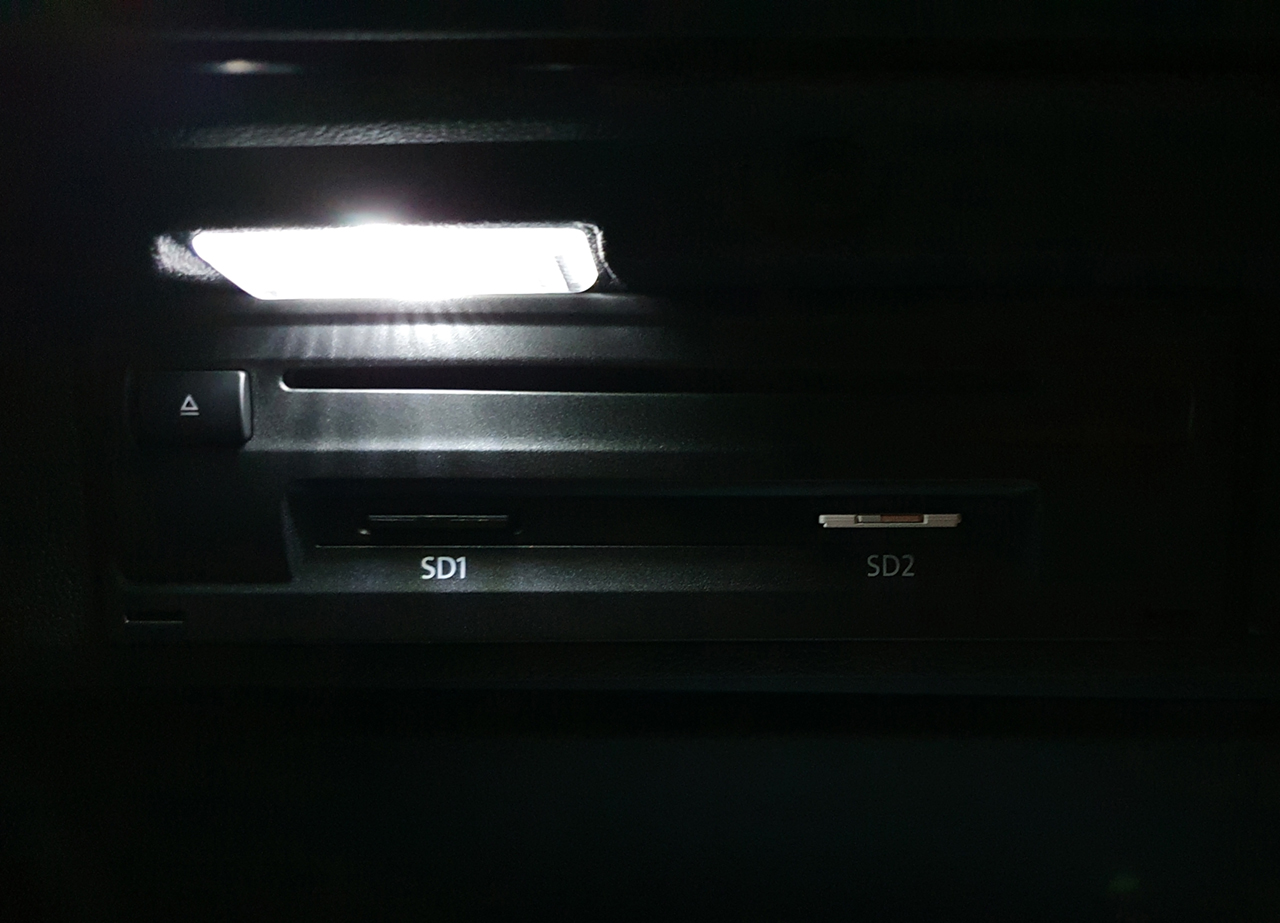

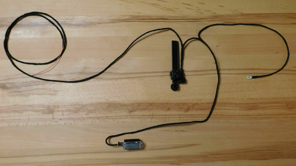

Yesterday the remaining parts finally arrived, today was the day to put them in the car.
Small upgrade but I'm satisfied with the final result.
The idea was to create something like this...
But I want to thank the user J+silva for his magnificent idea of connecting to a battery, because I didn't really feel comfortable working on the car's wiring. :(

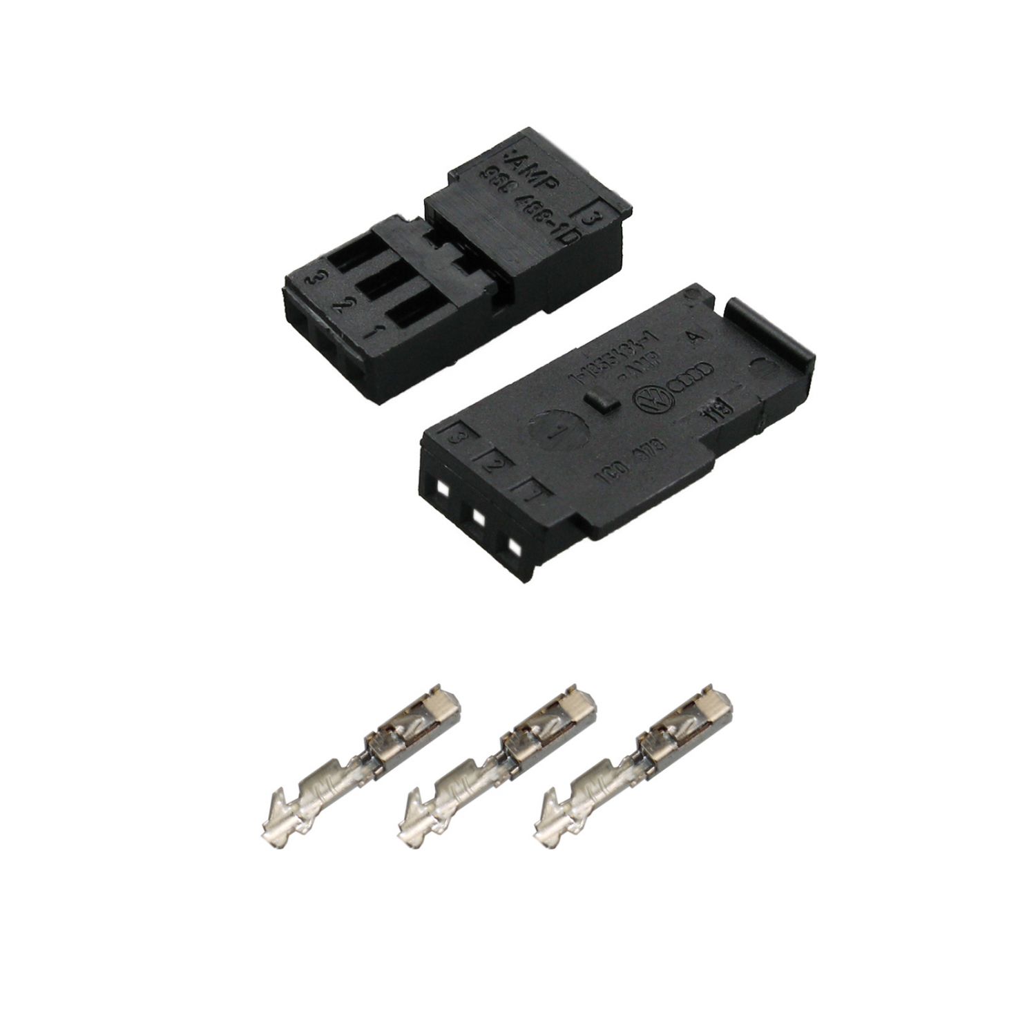

In addition to the part already mentioned 5G1858309 and a Luggage Lamp 8J0 947 409 and the wiring that I had from my previous VW Golf, I also used...
1 plug 1C0 973 119 B
2 connectors N 907 649.02
And wire to make the rest of the cabling, and lots of fabric tape. :lol:
This was the result... :D
It wasn't difficult, I just wasted some time passing the wires because I didn’t disassemble anything.
I hope with this I can help future interested in doing this simple upgrade.

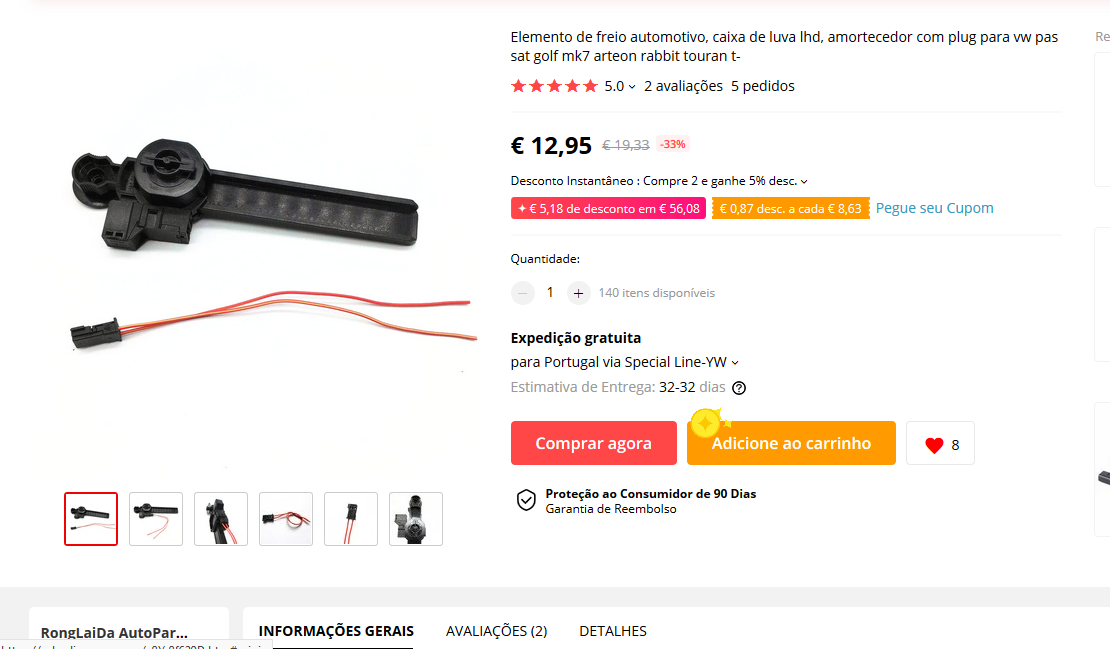

Hi you can buy it with the plug i found it in aliexpress. A small improvement that makes all the difference.

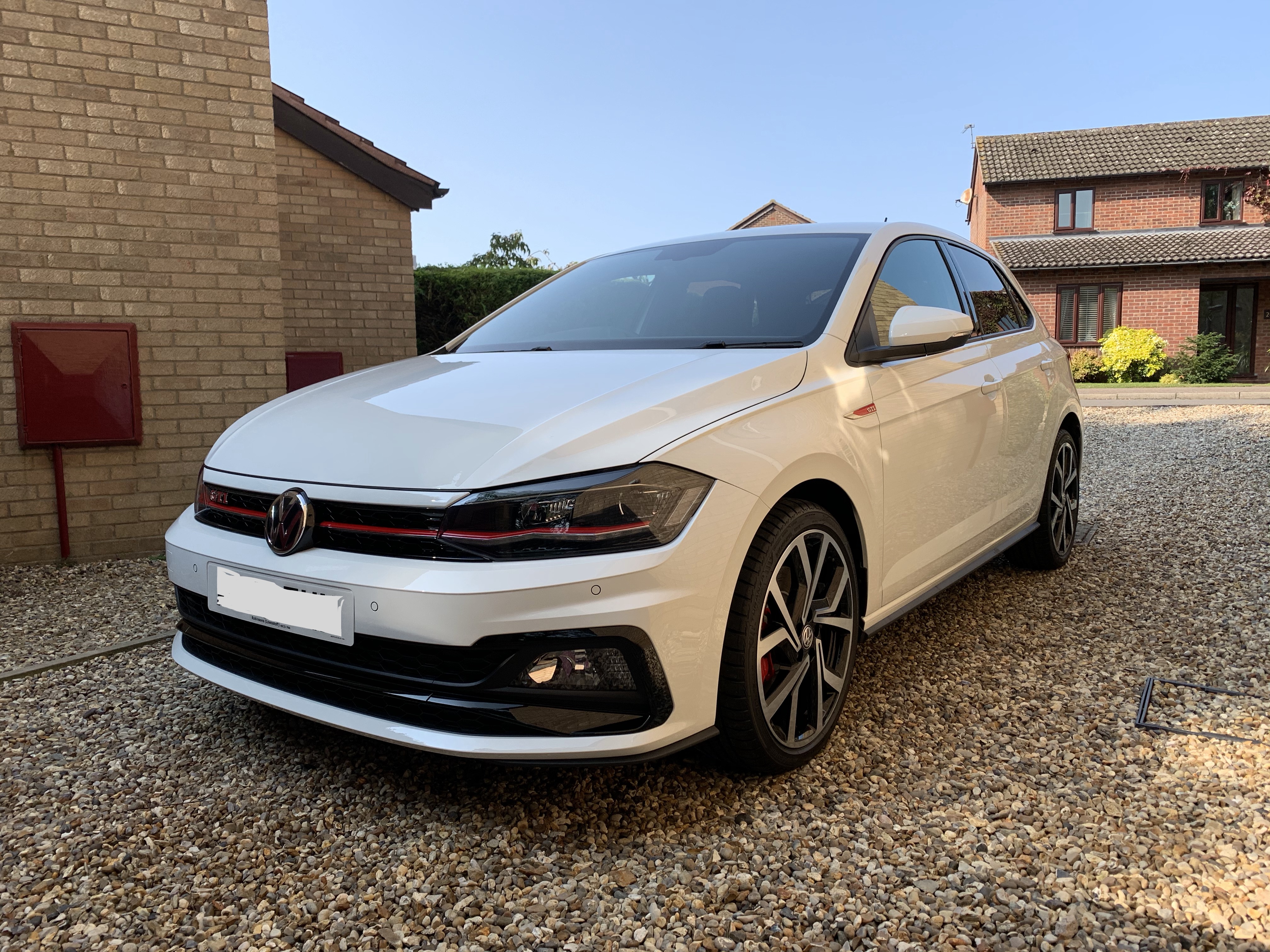

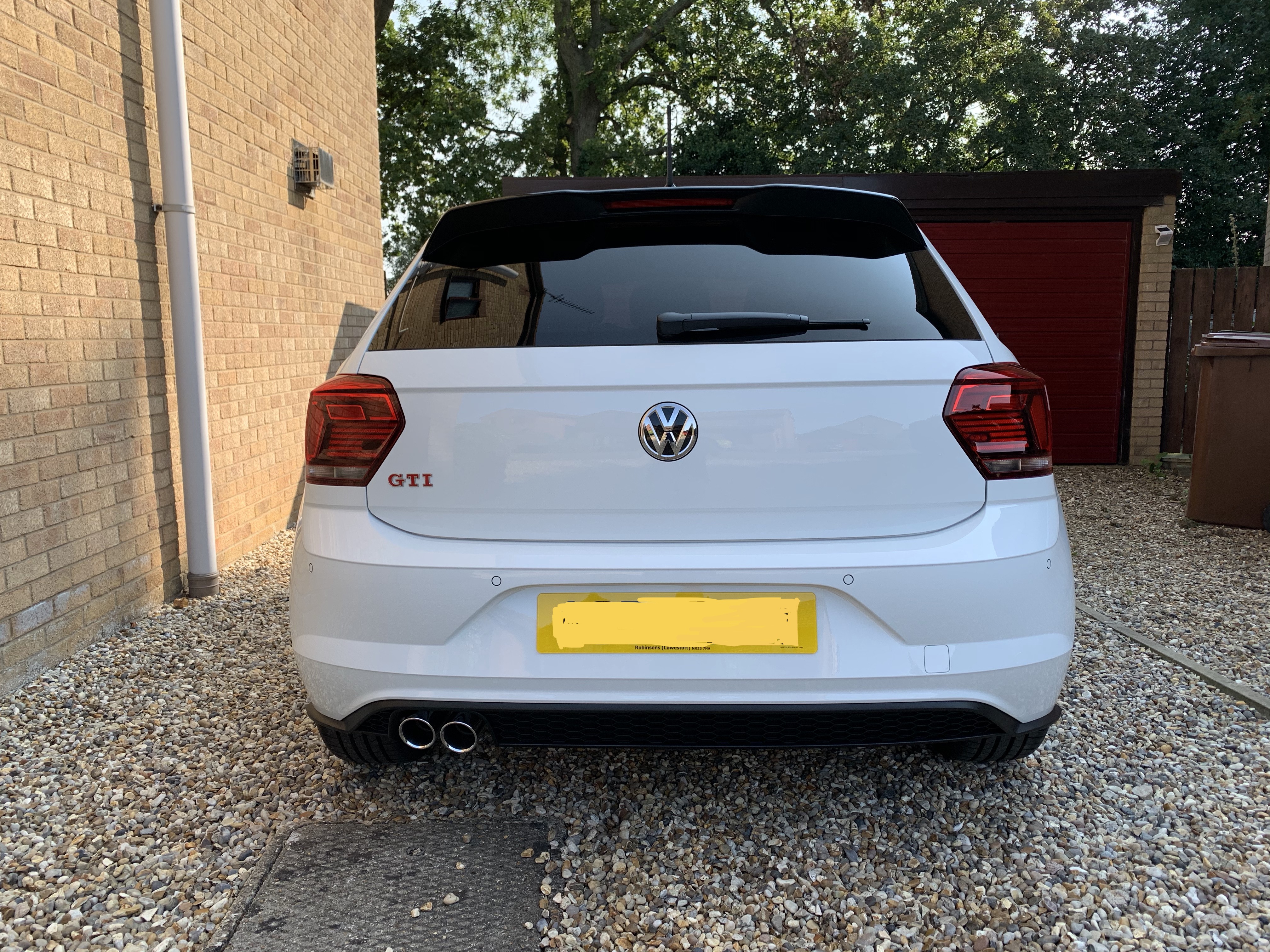

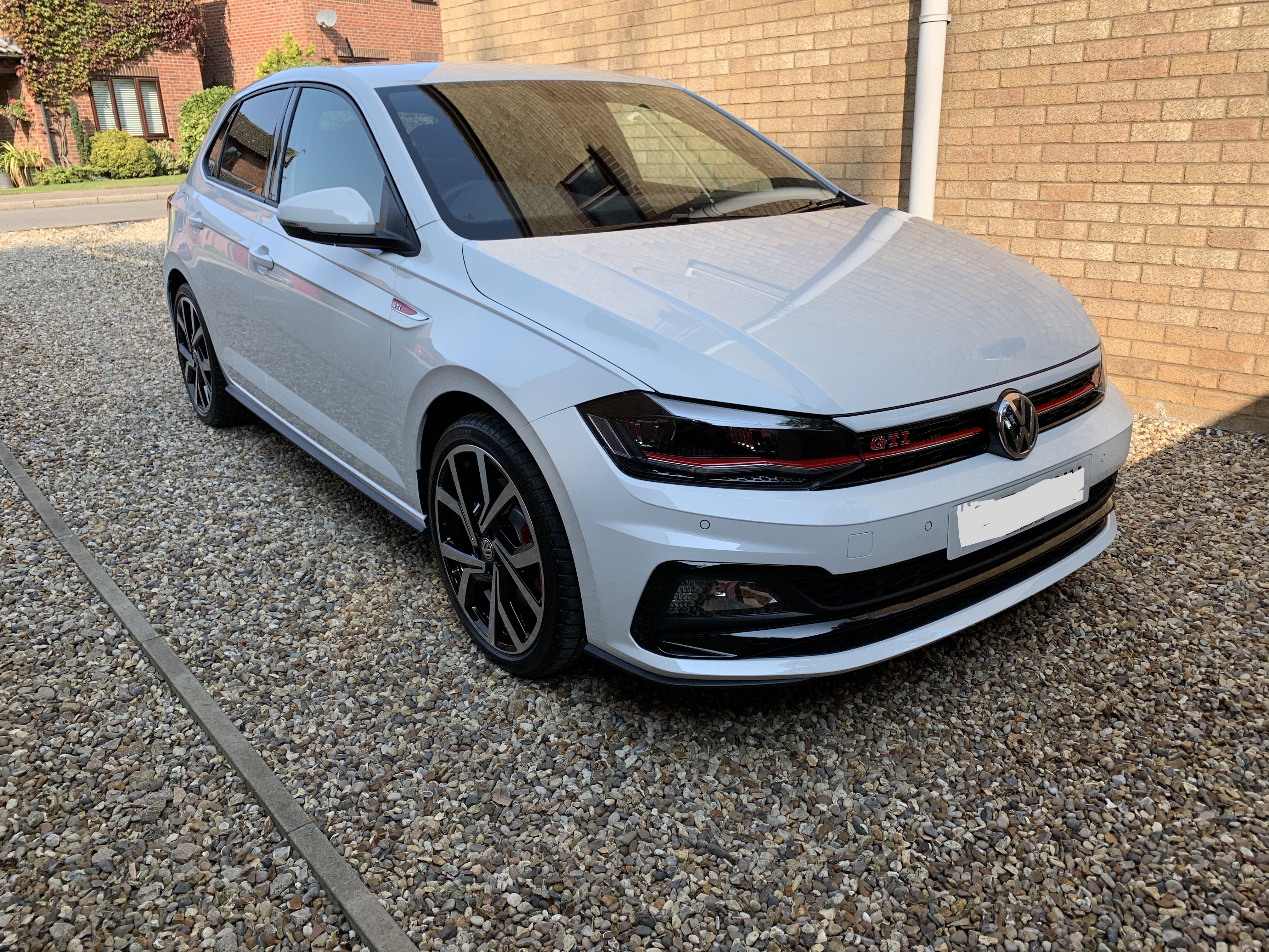

Not today, but over the weekend - gave my GTI Plus it’s first good clean, decontamination and a couple of coats of wax (a synthetic wax, so I suppose really, it’s a sealant 🙂). I used Fusso Light Coat 12 Month’s Wax. There’s a dark and light version of this product and used the dark version on my previous car and was very impressed with the durability and it seems to be highly hydrophobic. Water was still beading up pretty well on my last car nearly a year after applying it.
Things I noticed when cleaning this car compared to my previous generation GTI;
  • It is noticeably larger than the previous generation Polo.
  • the 18” Brescia alloys have an annoying ridge that runs around the circumference of the wheel behind the spokes which collects water. I was able to blast it out with my Metro Vac Sidekick Blaster warm air dryer though! 😀
  • The honeycomb lower section on the rear bumper looks as if it’ll be a dirt trap in the winter and will need cleaning with a small detailing brush to effectively remove the dirt.
  • There doesn’t seem to be as many annoying water traps that continue to drip after you think you’ve finished drying the car.
  • When washing the car, the door mirrors have an annoying habit of unfolding and the folding if you have the key fob with you. Even hosing the car down, they kept doing this when a water jet made contact with the door handle. I solved it by taking the key fob indoors out of range of the car.
Here are the results;
Oh, and here was the final stage of the cleaning process - for me, not for the car!

Looks brilliant mate! 8)
Posts: 3850
S_94 wrote: Mon Sep 14, 2020 11:49 am Looks brilliant mate! 8)
The beer or the car? 😀.
Thanks, I’m pleased with it. Still getting used to the DSG. Some say that DSG ‘learns’ your driving style after a while - I’m not sure it does, or if it’s just that I may have adjusted my driving style a little, but it doesn’t seem to be in as much of a rush to get into 6th gear at low speeds as it did last week when I picked it up.
Looking forward to many miles of driving 🙂.

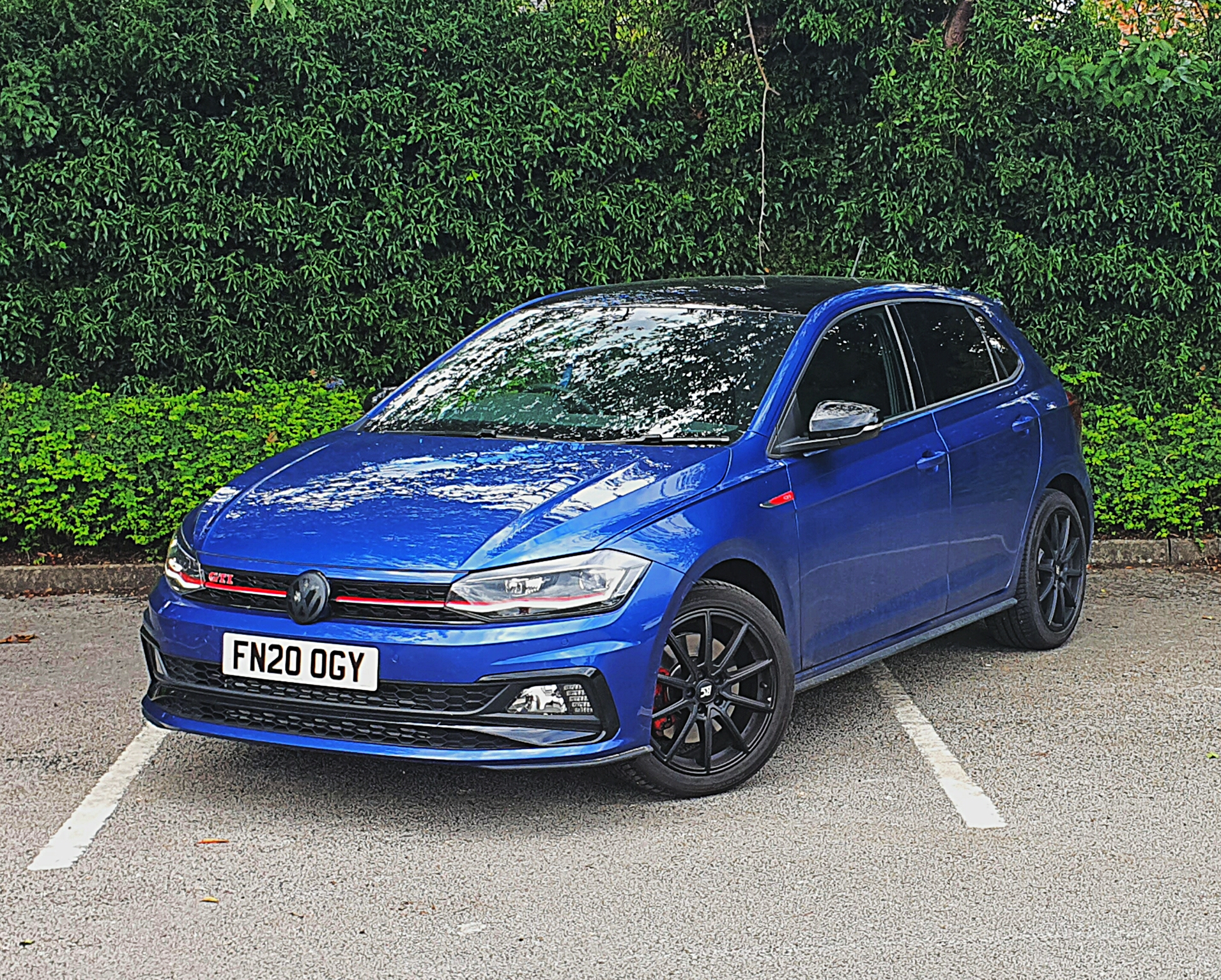

Those are exactly the wheels I have in a matt black except mine are 17's not 18's. Had them for 3 months+ and they still look incredible.

Stuart, yes I agree, they do look good.
There was another forum member on here (sorry, can’t remember their forum name) who got the diamond cut version fitted to their white GTI - maybe a couple of years ago. I think this is their car in the photo gallery over on brock.de website;
https://www.brock.de/felgen/vw-polo-gti/
It was then that I decided if I ever got a current model GTI+, it would be those wheels I’d get in grey, but not the diamond cut version.
I see that you have the RC Design centre caps on yours. Do you know whether or not VW centre caps will fit?
