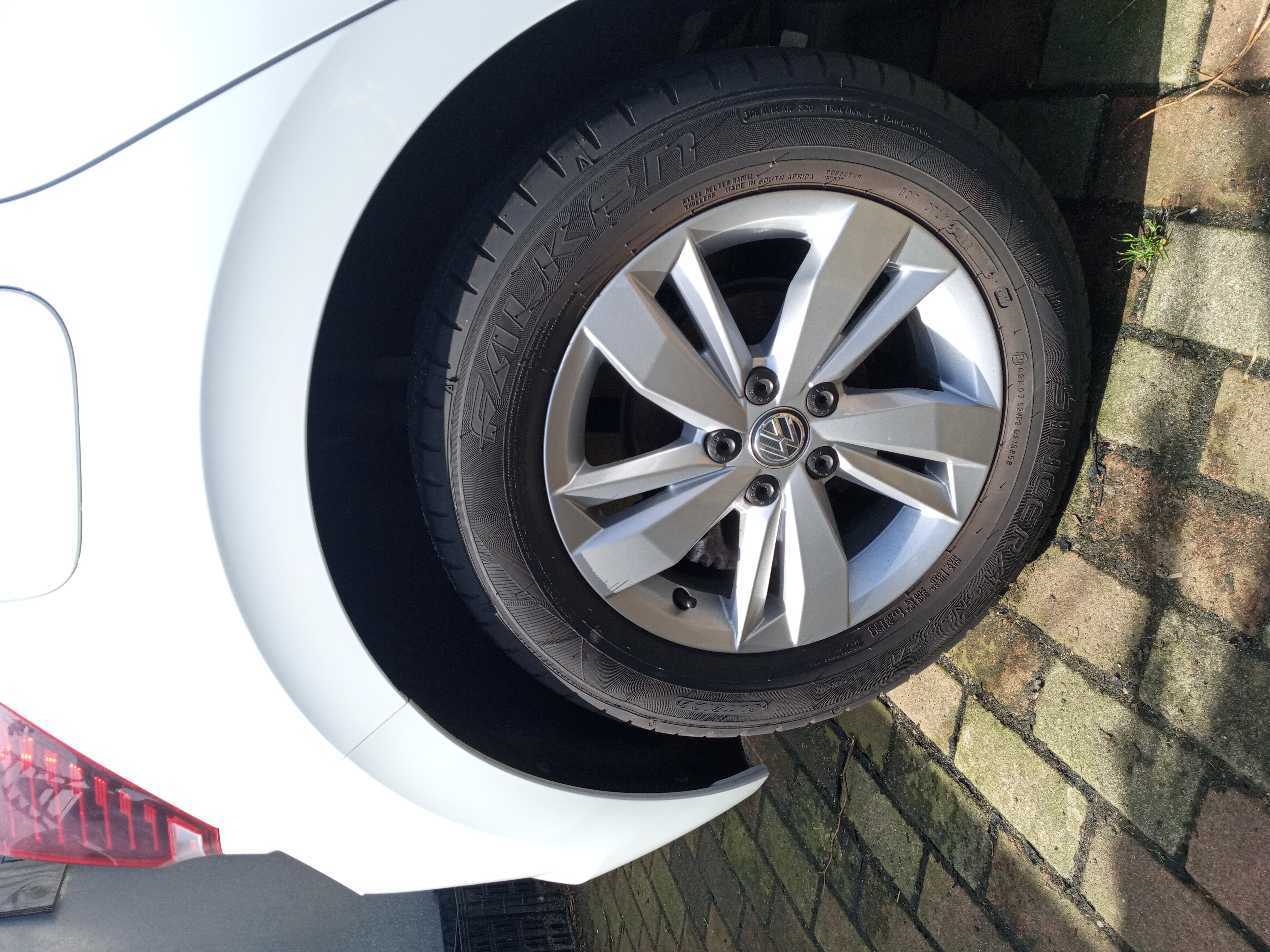

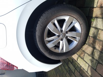

Is this "mooing" noise only happen with GTi?
I have a 1.6 Conceptline Polo (5-Speed Manual) that comes with rear brake disc (Solid Disc), it didn't make the "mooing" noise:

ho8882000 wrote: Thu Sep 03, 2020 1:40 pm Is this "mooing" noise only happen with GTi?
I think it just affects the GTI.
