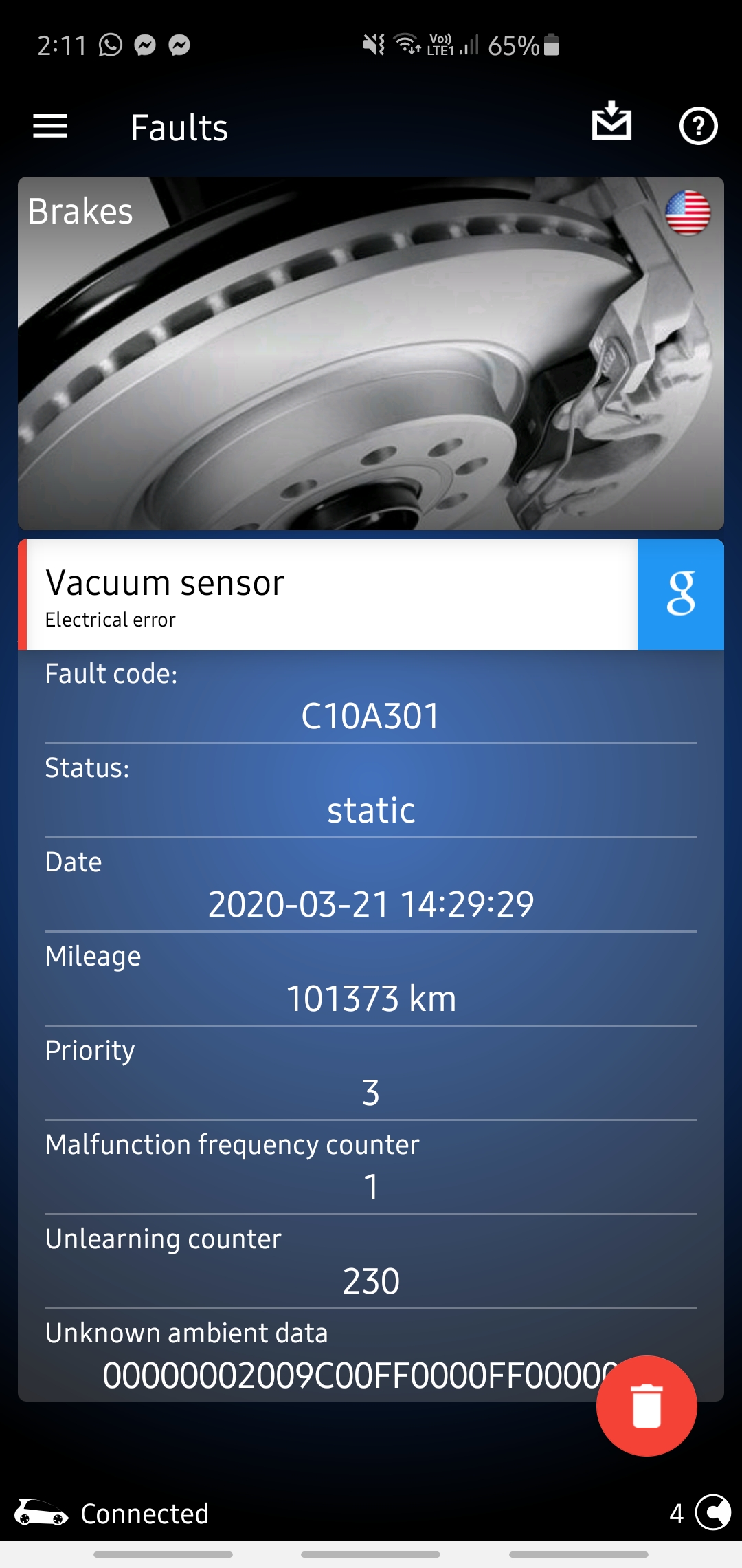

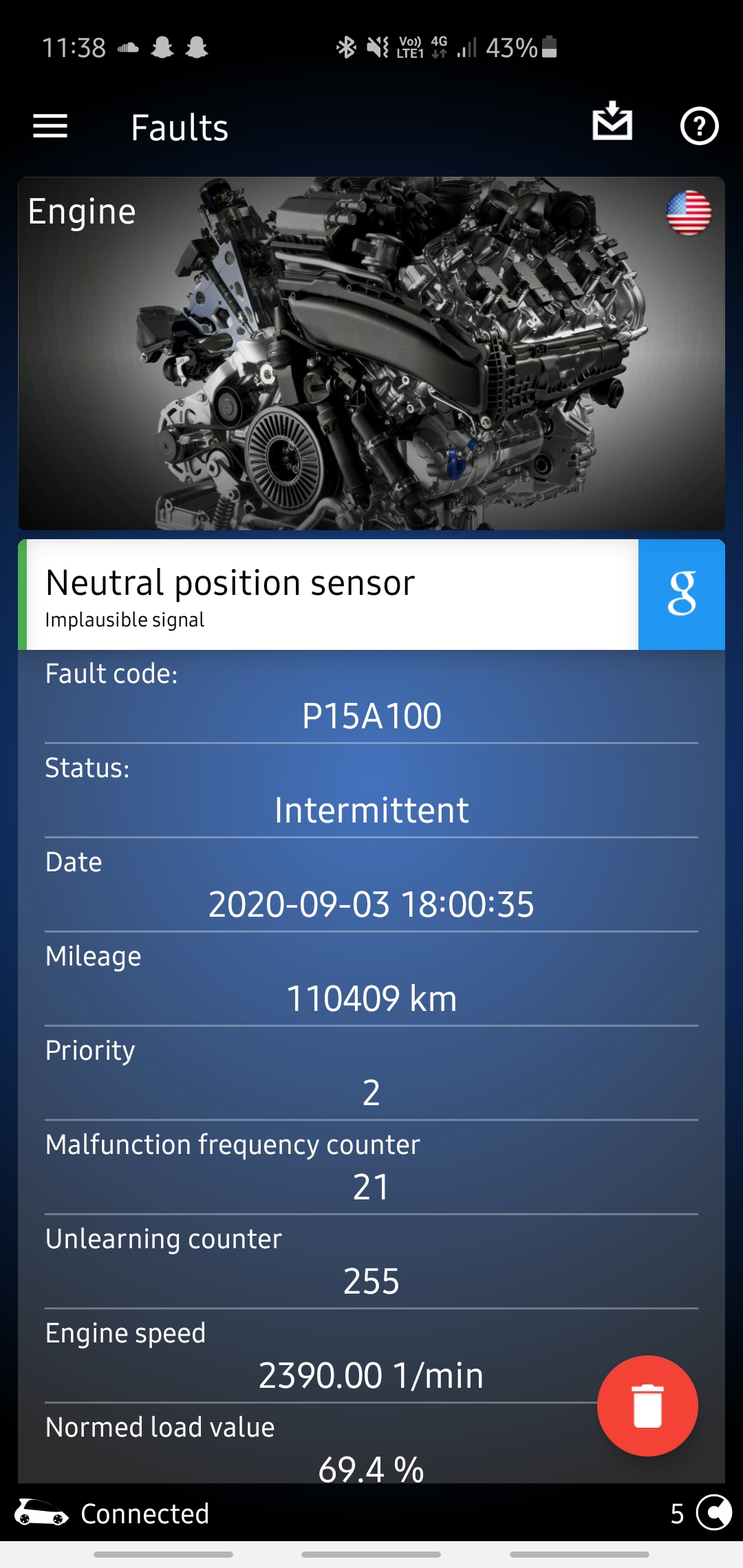

Auto Start-Stop Error displayed on start-up
Engine warning light on
3 Faults found when scanning with OBDeleven device (screenshots attached);
Vacuum Sensor (C10A301), Neutral Position Sensor (P15A100) and Invalid Data Received From Vehicle Dynamics Control Module (U041600)

I'd start with fixing the two static errors and clear all DTCs. If the intermittent error also returns for the neutral sensor, replace that one as well.
