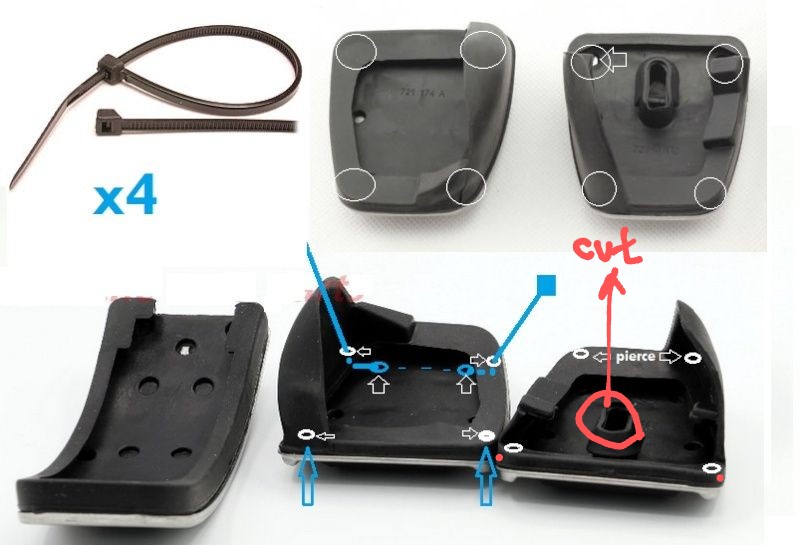

Hi guys, I need a suggestion please
for the second time I got from AE rubbish metal pads like which are impossible to fix properly with plastic clamps because on the rear there are a lot of holes and rubber is so fragile which break when I try to push the plastic clamps behind it. General quality is also horrible!
Do you know where can I get good pedals cap like the one of ciclo's post? Thanks

- Posts: 8994
Re: Franciswat's Polo 6R 1.6 Bifuel
Logically, the purchase links no longer work and I don't think it is possible to recommend a place to buy. Look on Aliexpress in stores that have a good reputation in terms of product quality (there are 3 or 4 stores on Ali that sell items that we could say are totally VW OEM), they are dedicated entirely to items of VW Group.
I don't know if the ones I bought are of good or bad quality (as you know, OEM does not exist for the 6R with 6C shape/style), I had no problem with these pedal caps when inserting the plastic zip ties.
- Only FYI, and surprisingly, the pedal caps that I installed remain fixed in position perfectly since then (6 years
), without any strange movement.

- Platinum Member
- Posts: 1305
- Location: budget build
Dont overtighten the zip ties, and dont pierce the rubber holes too high. I used a small drill bit in my setup, and i used MK7 golf GTI pedals.
Also, cut the middle piece that sticks out
You wont be able to see the zip ties ( black on black) and it gives you more thickness if you pierce holes with a drill bit lower like on thenred dots that i marked

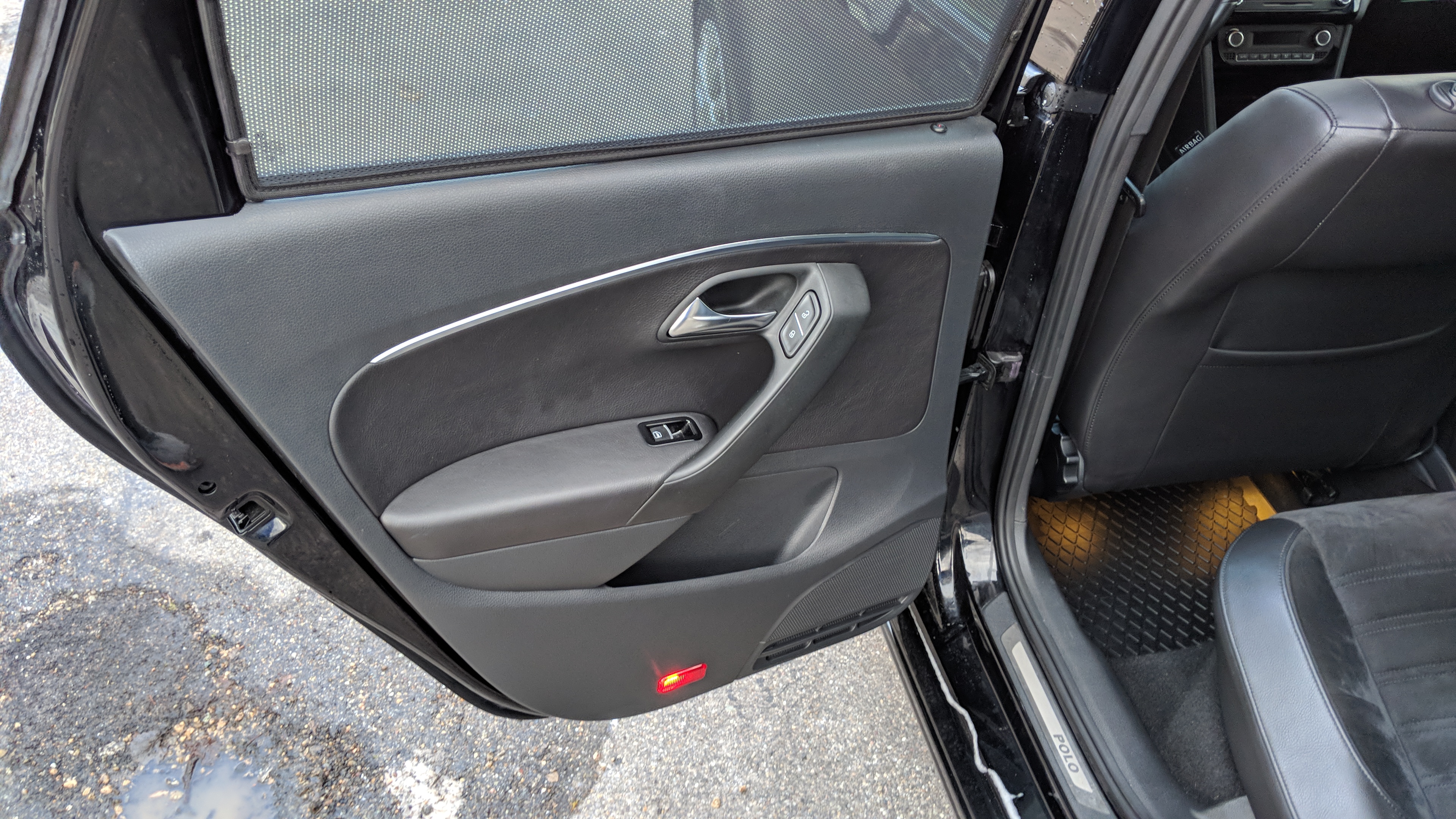

Anyway I want to share my last project: door's courtesy lights (white) + warning lights (red).
After long thinking about I found this was the best solution for me. What you think?

- Posts: 8994
Good morning Francesco!
The warning and puddle lights on the doors look really good. Without a doubt one has to meditate on this installation before doing it.
Nice job!!
You will have to review the electrical installation for the RLS, point by point of connection according to elsa, erwin. (the fuse should protect the RLS)
It is definitely not normal what happens with all the RLS that you have bought, ... of all the years that we have been with these stories no one reported such a circumstance with their RLS.
About the pedals ... no comment, you know.
Nice job!!
- Posts: 6694
Looks very good francesco, I did mine in a similar way. The red one on a different spot but the yellow one on the same place.
