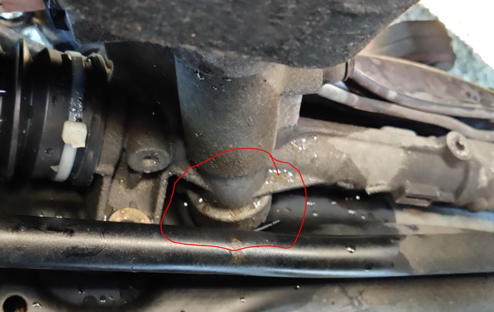

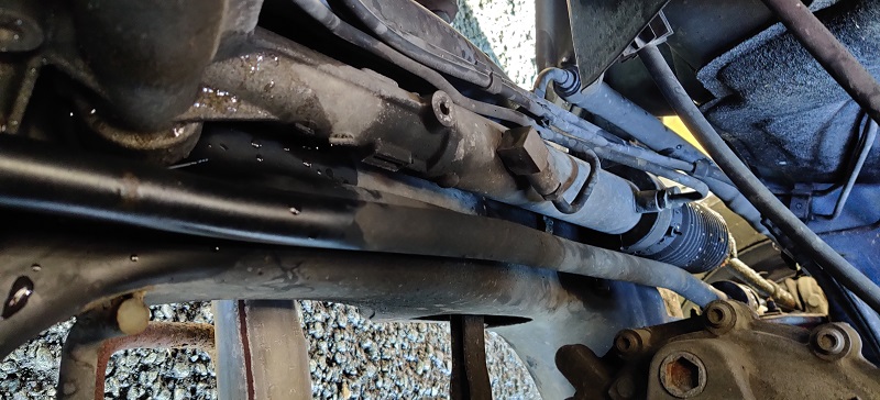

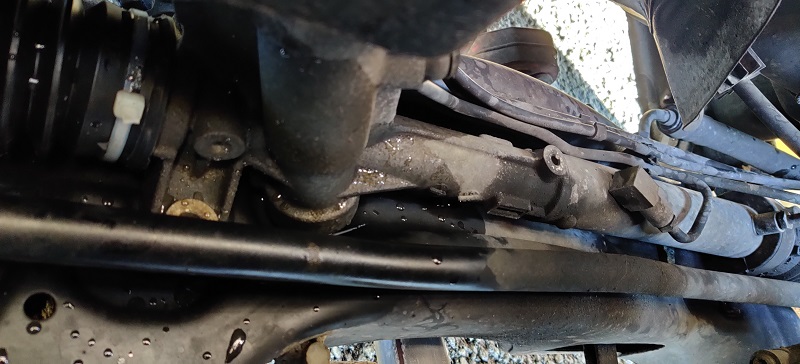

Folks
I had a search through loads of topics on steering rack leaks here and Im still a little confused
My 2008 polo N93 has a leak
the Driver side tie rod boot fills with steering fluid and then leaks out
The old Rubber boot was damaged so I replaced it trying to slow the leak to give me time to get it sorted the garage cant fit it in for another 3 weeks but no joy
It emptied the reservoir in 3 days of just going down to the town
So Im on ebay trying to find a replacement rack ( not just a seal )
Is there a way to find the part number from the Vin but when I go on the eKTA site and put in the Vin it says not found
Is there anyone can tell me the part number from the following
I was just out under the car to see if I could find a part number on it but its pretty awkward
wvwzzz9Nz8Y157369
9N3 1W4
Polo A04 comfo
51 4v M5F
BZG- JUS
Any of the Racks i have seen on ebay look similar but seem to lean more of an angle where the motor housing is ( where it goes in to the car
Steering rack.jpg (134.21 KiB) Viewed 4658 times
Steering Rack 2.jpg (107.47 KiB) Viewed 4658 times
Many thanks for any replies
J

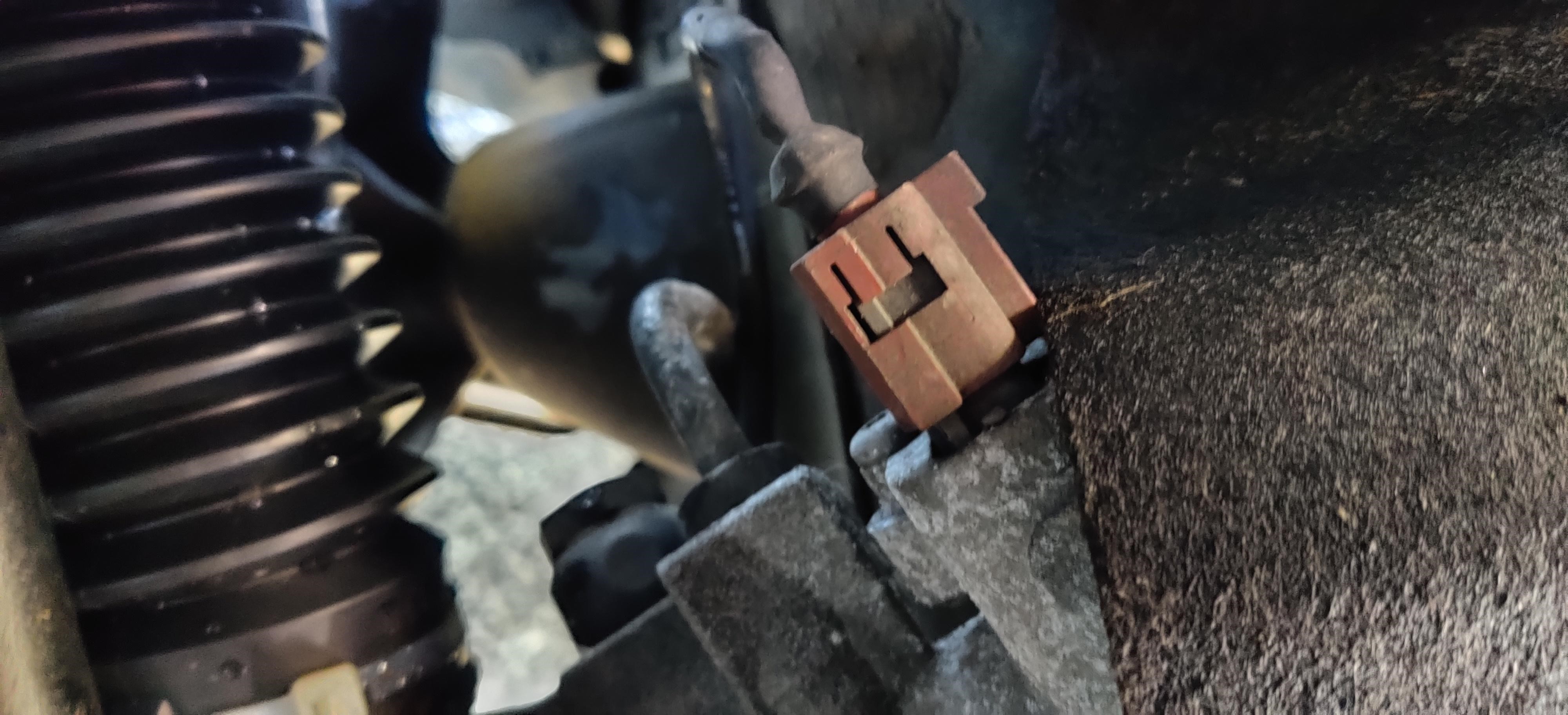

A 3 pot 1.2 12V BZG
Sure the Rack is the TRW one with the green cap pretty sure I remember taking it off When I bought some fluid couple years ago
And rack has the Brown plug on it
rack 3.jpg (895.47 KiB) Viewed 4638 times

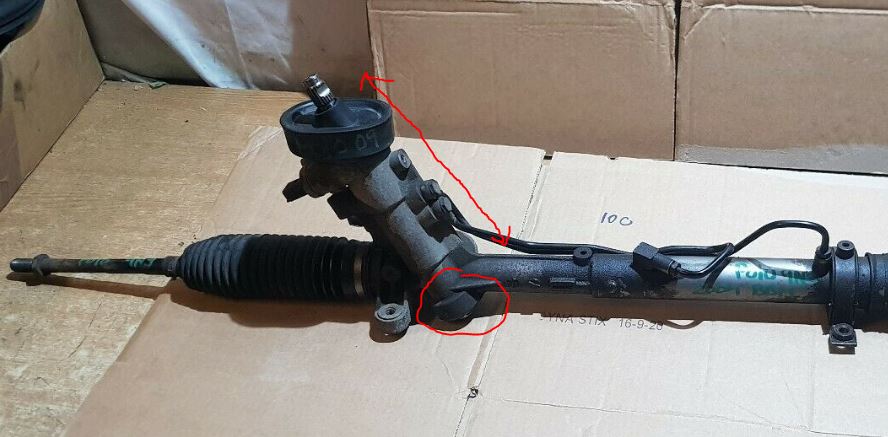

I had a look on ebay and there was one for a 2009 but the part of the rack that has the motor / pump attached looked like it was at more of an angle if that makes sense than the one in the car
https://www.ebay.ie/itm/VW-POLO-9N3-FAB ... Sw7k9eIHOY
This one looks in good condition but wanted to be sure as the cost of trying to return it from Ireland would be quite expensive
Ebay Rack.JPG (67.64 KiB) Viewed 4638 times
Rack 5.JPG (81.39 KiB) Viewed 4638 times
Is it just the picture or is the ebay one leaning over more at an angle ?
Only other difference is that the ebay one came from a 3 door car where I have a 5 door 2008
Thanks again for your input :-)
J
