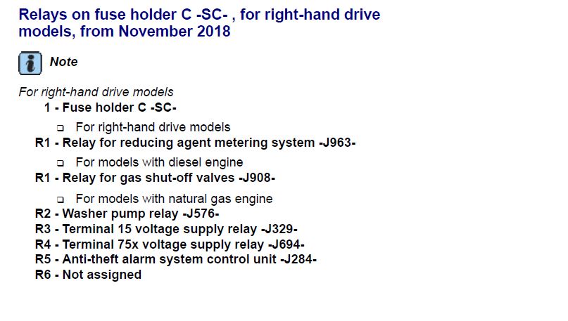

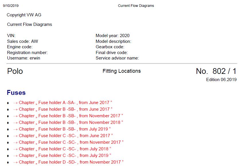

I have the VW original workshop Fuse & Relay diagrams of the AW Polo (MY20 or before), it is in pdf file format, so I can't upload it onto this forum.
If you interested, PM me your email address, I can email them to you.

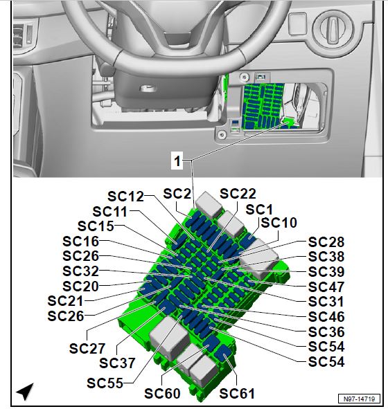

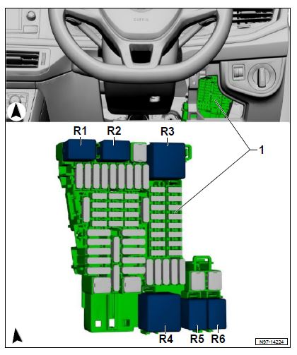

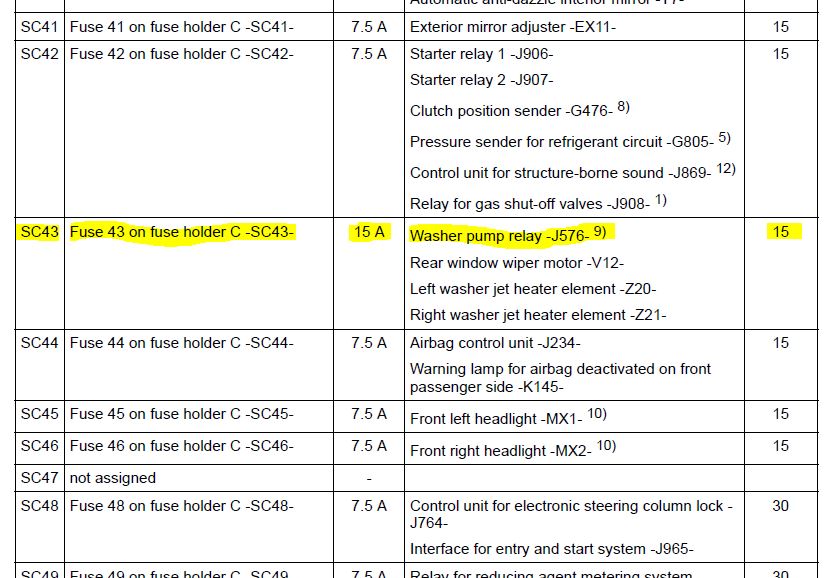

However , looking at your screenshots you've highlighted fuse 43 on fuse holder C, in location SC43. Yet the exploded view key doesn't show where SC43 is. Then, there's reference to relay R2 in another view. Confusing, or am I being thick?

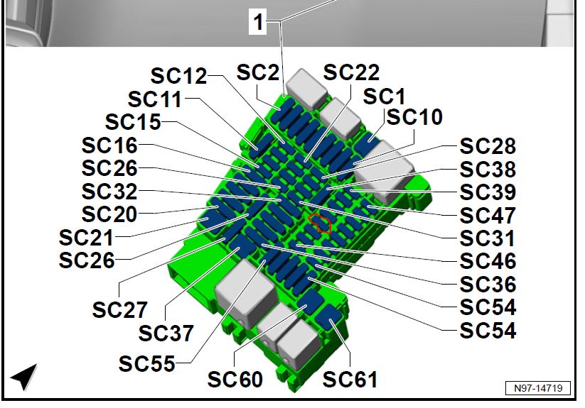

The picture show you the position of SC39 and SC46, from here onward you will have to count which one is SC43.
Because of the size of the picture, they can't possibility label every single fuse number on it.
But I circled SC43 in RED below:

Right, got it - many thanks. 15A mini blade.

I changed the 15A fuse in slot SC43 but nothing changed, so it looks like a trip to the dealer to see if its the pump itself.
