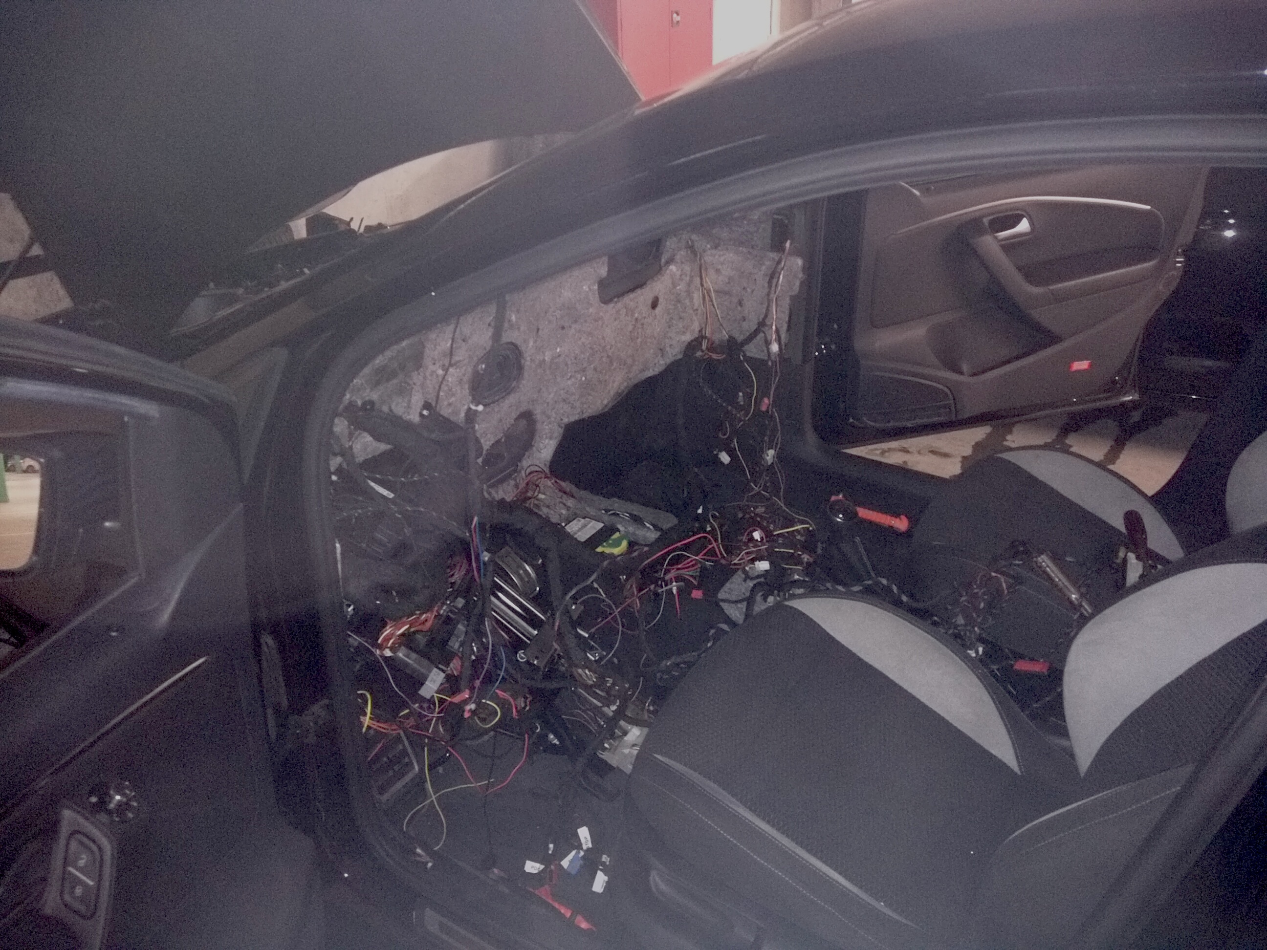

Oh man. You do not wanna see the current state of my polo. I removed the dash.
I’ve answered my own question. There is a 3rd clip on the underside that literally releases the stalks. Man that thing held the stalks on there good.

All this to get to the defrost flap motor/sensor. And I’m still a long way off.

i feel your pain regarding the dashboard. i once did my climatronic retrofit and it really requires all of the dash to go..
but you're replacing the defroster flap, which one is that? the flap that regulates recirculation? or windshield flow?
for the recirculation flap you do not need to remove the dashboard, just the fan and glove box and you can reach it.
