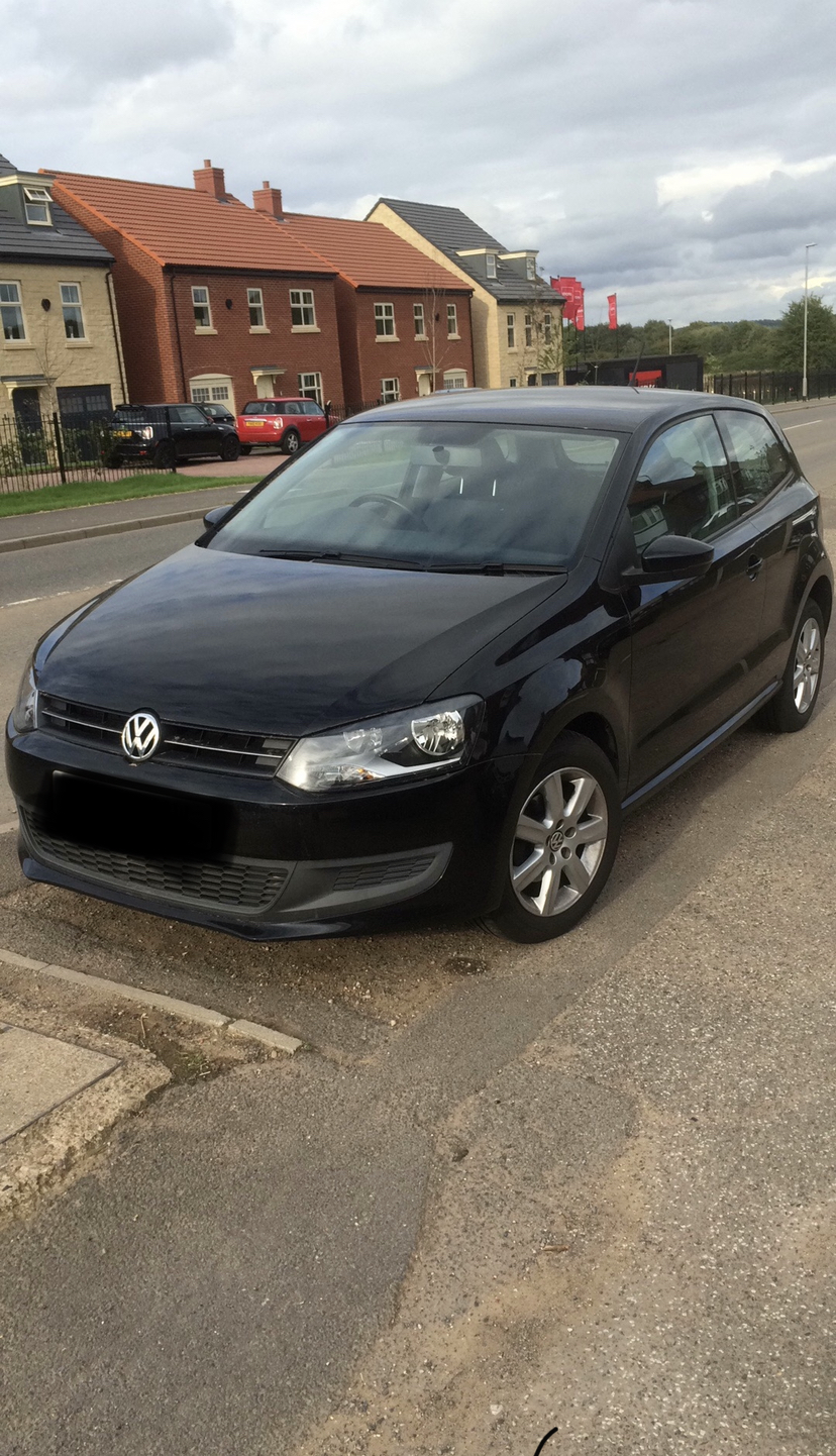

[img][img]Hey, I’m very clueless when it comes to car parts and stuff. Anyway I’m looking to do my first car mod on my polo SE 2010 or at least I’m pretty sure that’s the model, I wanted to replace the stock headlamps with those LED ones with the dynamic indicators. They look the same shape as the stock ones and says it’s a plug and play mod, but it says that it doesn’t fit my car model for some reason.
So I wanted to ask if it would or wouldn’t fit my car? cuz they are kinda expensive. If they don’t fit then why not, is it to do with the wiring? If that is the case would it be possible to jank the mod is someway so it does work?
I’ve attached a picture of my car idk if you’ll be able to just identify the model from it, along with a picture of the head lamps I wanted to fit

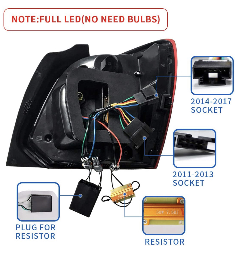

Thanks for the help I really appreciate it. And it looks like the tail lights have connectors for both. I hope that won’t cause any problems

Dont mount resistor to plastic part of the car, only metal

Where would you recommend to mount it?

Any metal part of a car is perfect. Those resistors can get hot.
