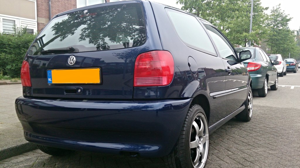

Maybe I still have some pictures somewhere
Trimming is needed for the screwhole towards the center of the car. The screwpart has to go into the hole that was made bigger. Then use washers before fitting the nut on.
In the back of the units you have to trim back the inner part that touches the car.
Pinout I have to dive in my archives. Both sides need 2 wires to change. On one side you have to trim back to 2 notches on the plug.
On 6N1 the plugs are mirrored, in the 6N2 they are Both sides the same
1=black/green
2=black/red
3=red/grey
4=grey
5=brown
My result back in the day
