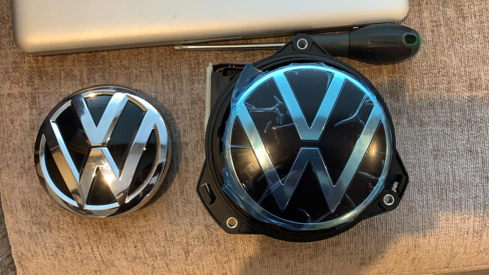

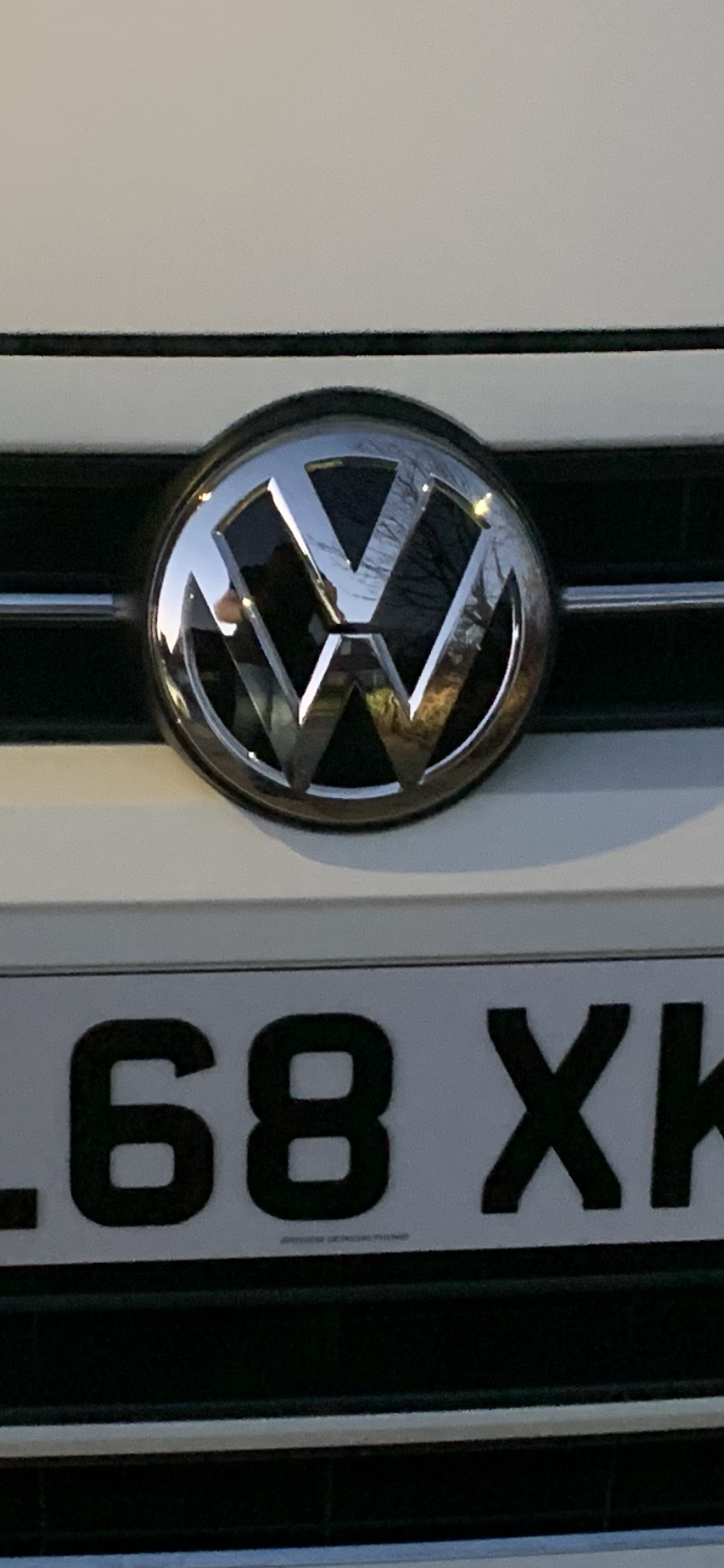

Today I added the new Style front & rear Badges to my polo.

Scott, Will you be changing the centre caps on your alloys and the emblem on the steering wheel centre boss to the new style too?

Yes i will be if they are available to buy but the airbag would be a lot to buy just to replace the emblem so not too sure about that!!!

I'm not 100% sure but plastic cover around airbag could be separate part

There are some of the new style centre caps for sale on various websites - part number 5H0601171FOD; inner diameter 55mm, outer diameter 65mm. Couldn’t see any on UK based seller’s websites, and buying them from an EU seller if they ship to the UK would probably make them expensive after post-Brexit import duty / import taxes have been applied.

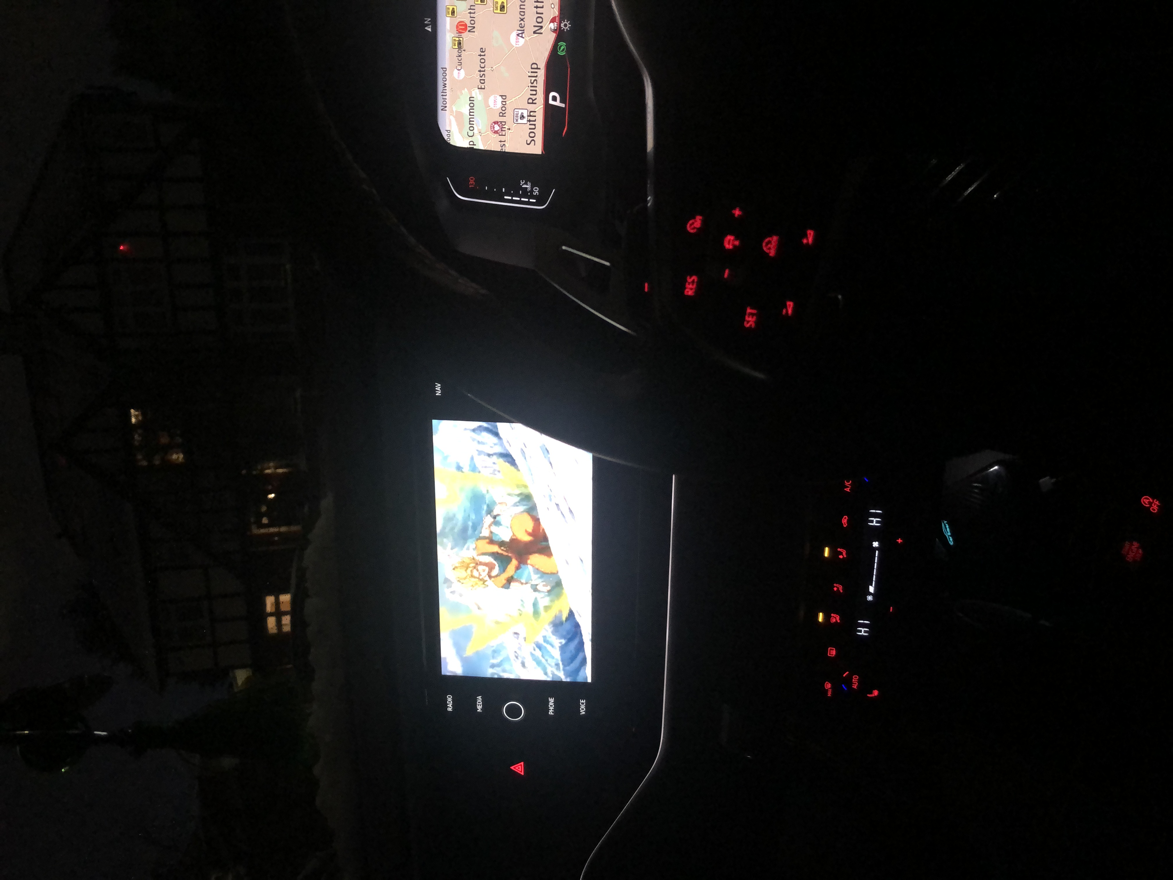

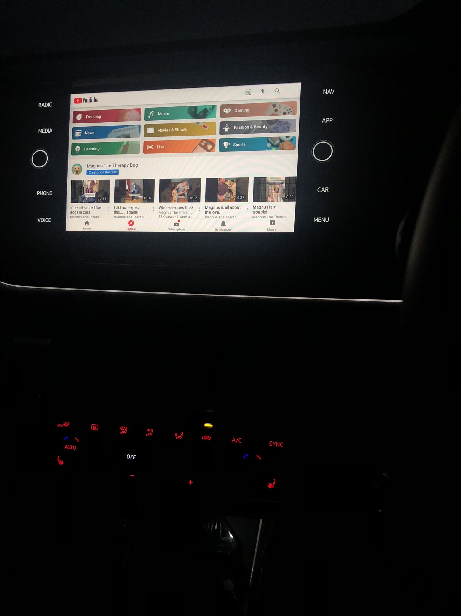

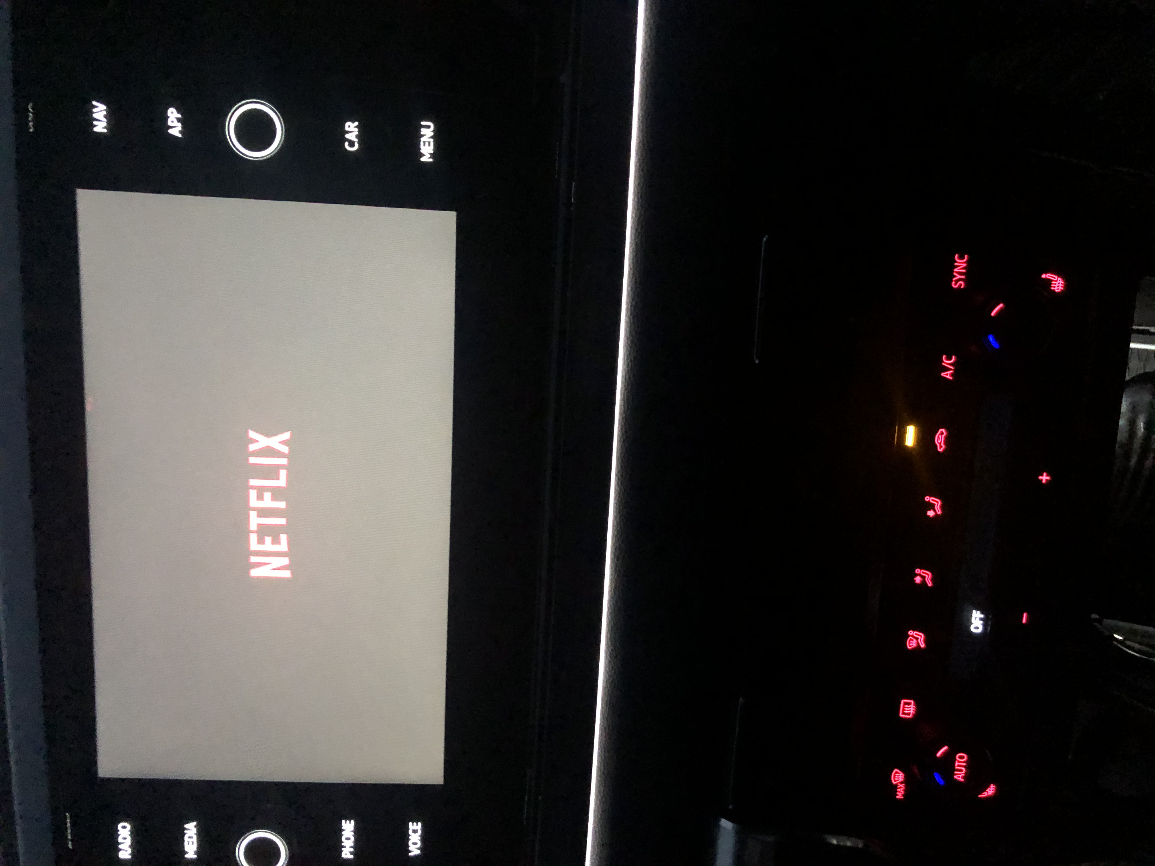

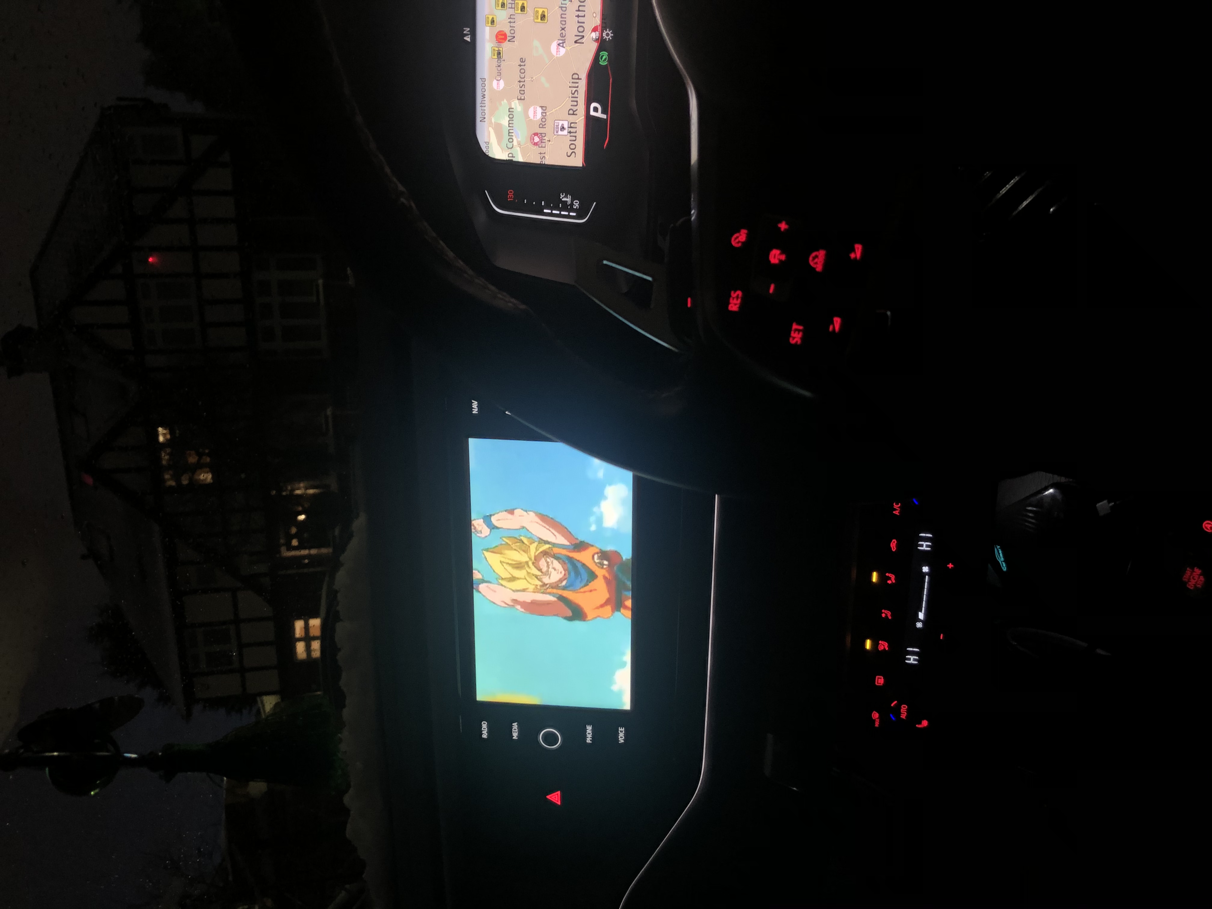

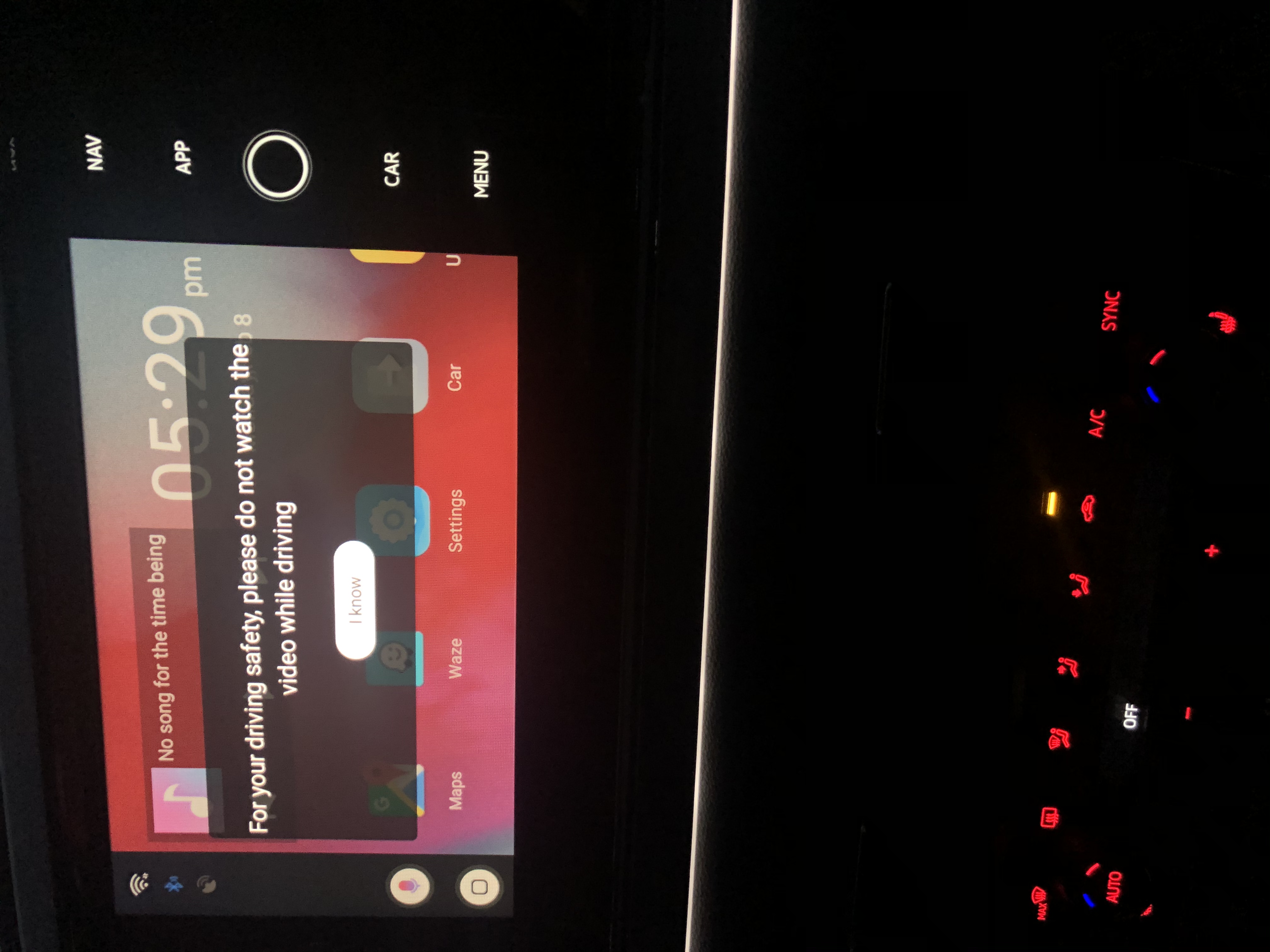

I installed a plug and play android/ CarPlay Ai box today. If your not familiar with this type of device here’s a link to a review by MR-fix on YouTube to give you a better understanding of what I’m talking about.
https://youtu.be/XzcF6wKH-wM
Overall I’m happy with the box, it’s definitely exceeded my expectations regarding responsiveness, sound and picture quality are relatively good for a basic car screen to.
Also it’s not a good idea to watch boxsets/ videos or movies while driving before anyone mentions it, You could get points and a fine if you’re caught doing so or even worse kill someone while being distracted and be sent to prison.

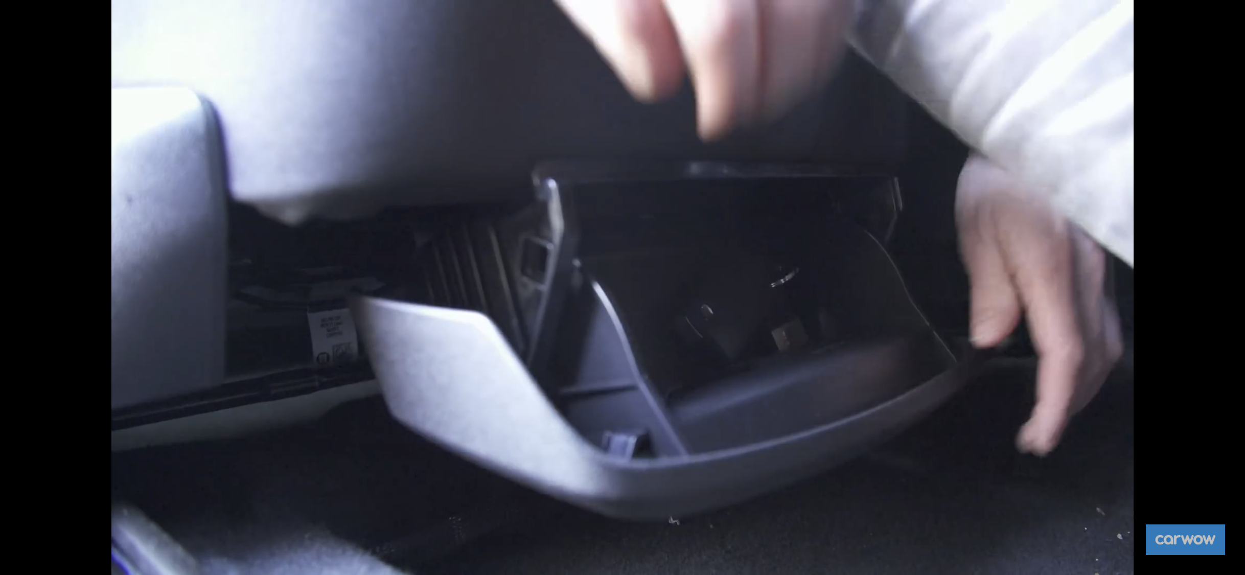

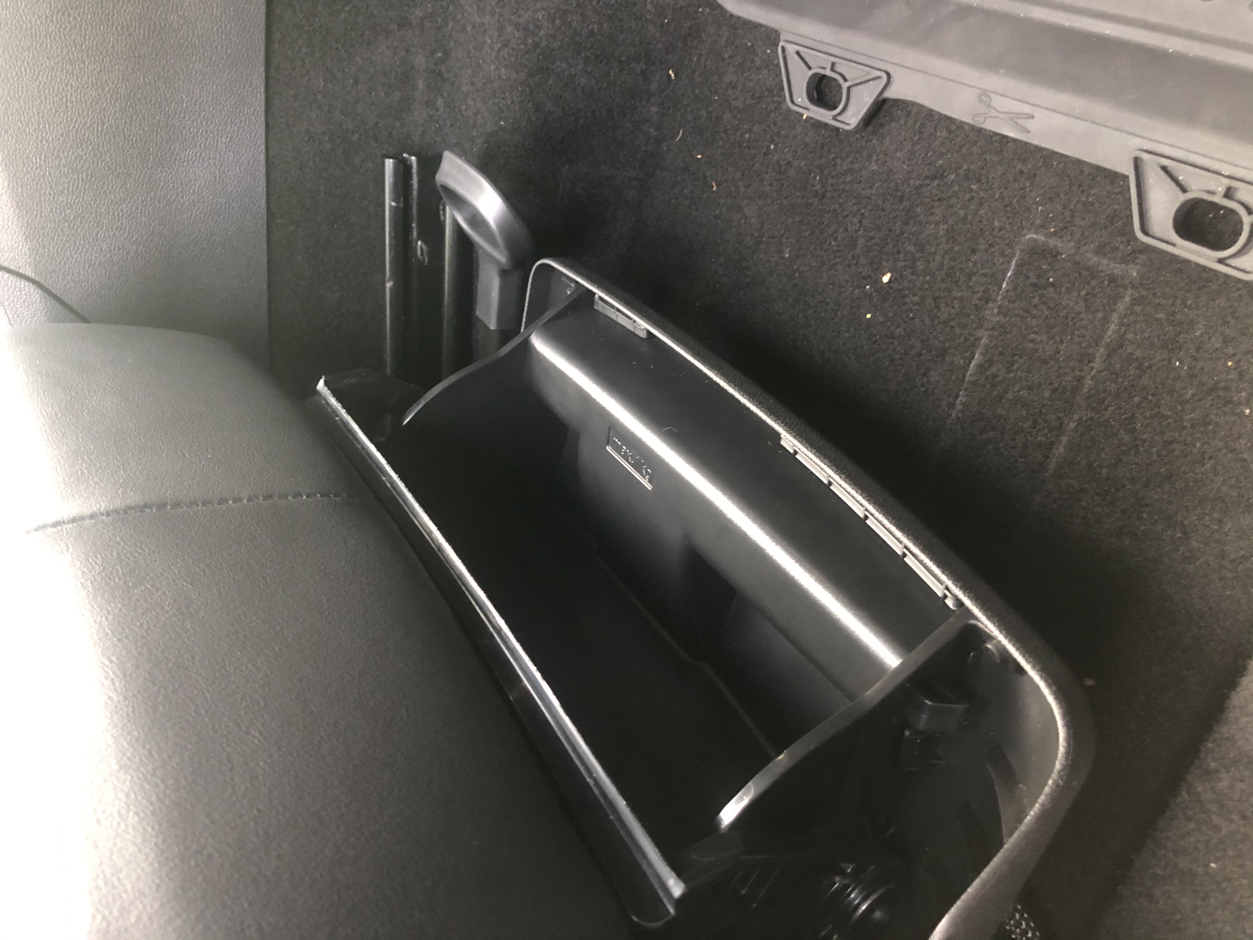

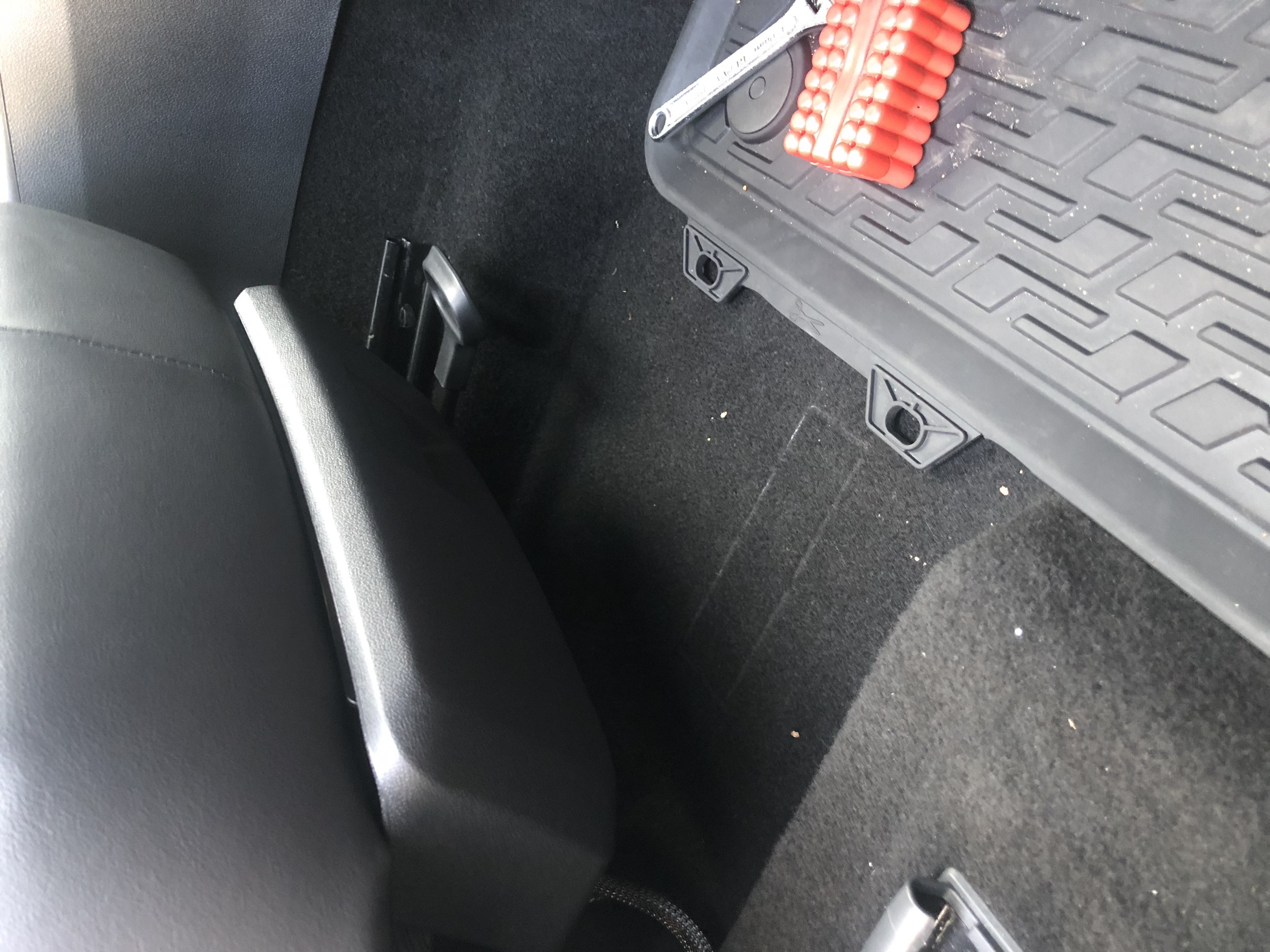

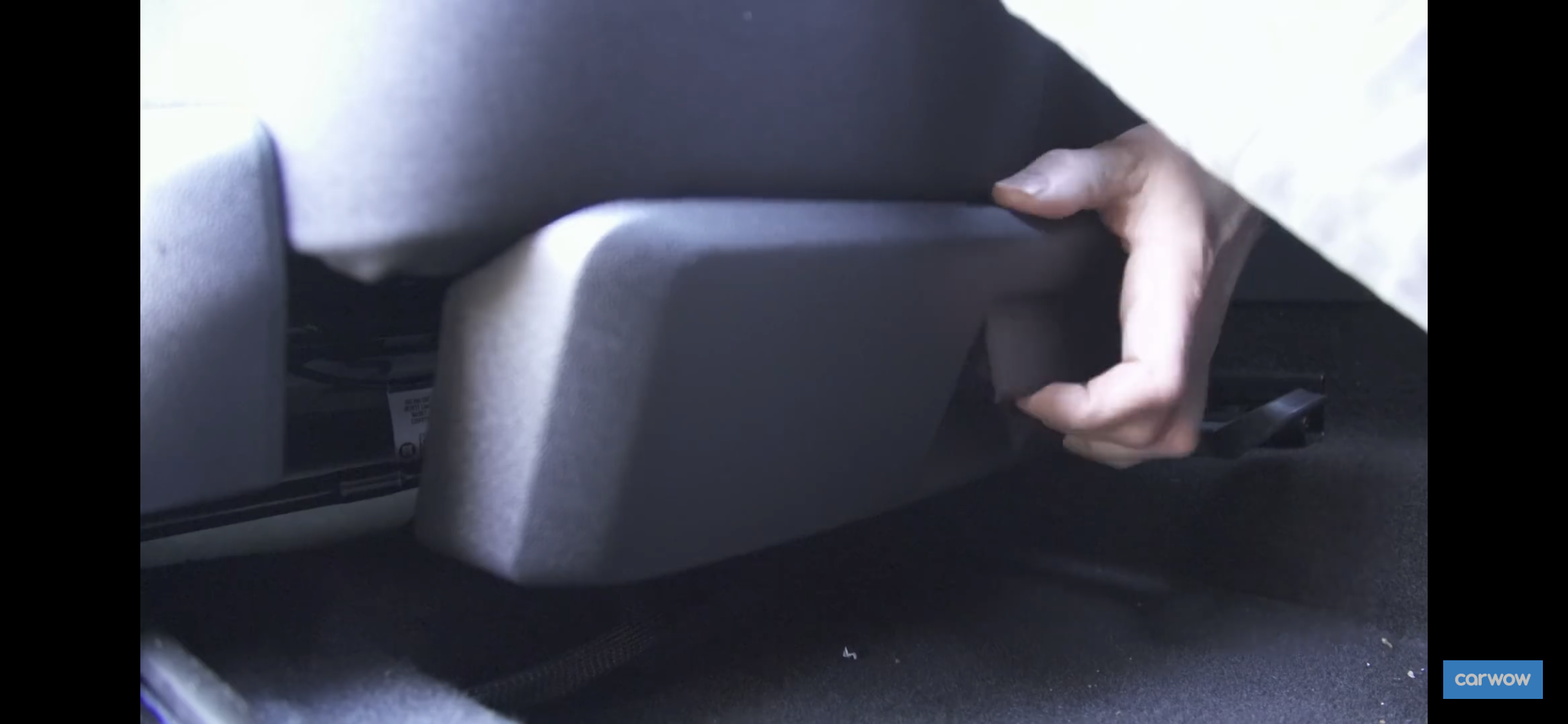

Today I installed a under seat storage box it’s originally from a Audi a1 or seat Arona & possibly other cars. after a bit of digging around I came to realise the metal structures/skeleton under the seats on these cars are the same but the foam cushions are different. The box is Probably not as big as I’d like but it’s better then nothing. Overall I’m happy to have extra storage to keep things out of site.
Images below are from car wows review of the seat arona.
Part numbers:
Storage box : 81A8826024PK
Speed nut : N90088003 (x2 pcs)
Oval Hexagon Socket Head Bolt : N90737101 (x2 pcs)
I have spare nuts(8) and bolts(8) as it worked out cheaper to buy as a pack of 10 so if anyone is interested in doing this retrofit pm me I’ll send them out for free as I have no use for them. (Uk only)

Hey Scotty.. Could you share the link to buy these new badges..? I would like to do the same on my polo :)
