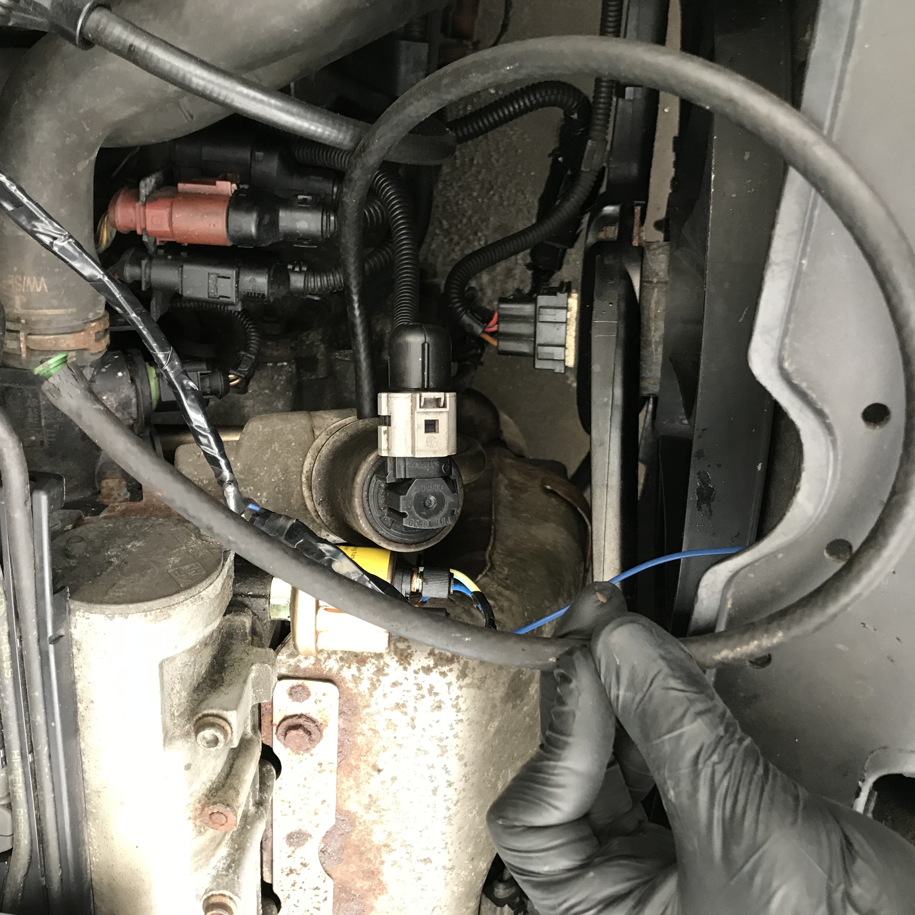

Yeah, I have a simillar problem with my one 1.4 16v 2001 model. I bought the car cheap, arround 300 euros(I live in Sweden). I drove it home, no problem. Next day I saw the oil level was low, I put some 5w30 in it. After 5 min oil lamp came on. Replaced oil switch, no luck. Changed oil and filter twice, no luck, additive, no luck. Fitted oil gauge, psi won t go over 4 bar then when it gets warm I have 1 psi at idle. Now I m on my way to replace fuel pump. After a week my crankshaft sensor went f****d and when I opened the air filter..was no air filter, throtle body full of s**t. Now I have like a cranky noise when cold, after warming up it goes away but when I rev it it sounds again. When it was cold outside I had also like white smoke but it has a sport exhaust so I thought that might be the issue. Now it s warmer and I don t have any smoke. No oil in water or other way arround. Plus I have a broken hose wich I don t know where it leads...maybe someone can help as I m gettin tired of this car, I have it for 3 weeks and I m daily under it. It has no oil leaks arround the engine, the only oil I can see it s arround the oil swamp but no leaks, just small drops arround the bolts. This is the hose that I can t find his destination.
