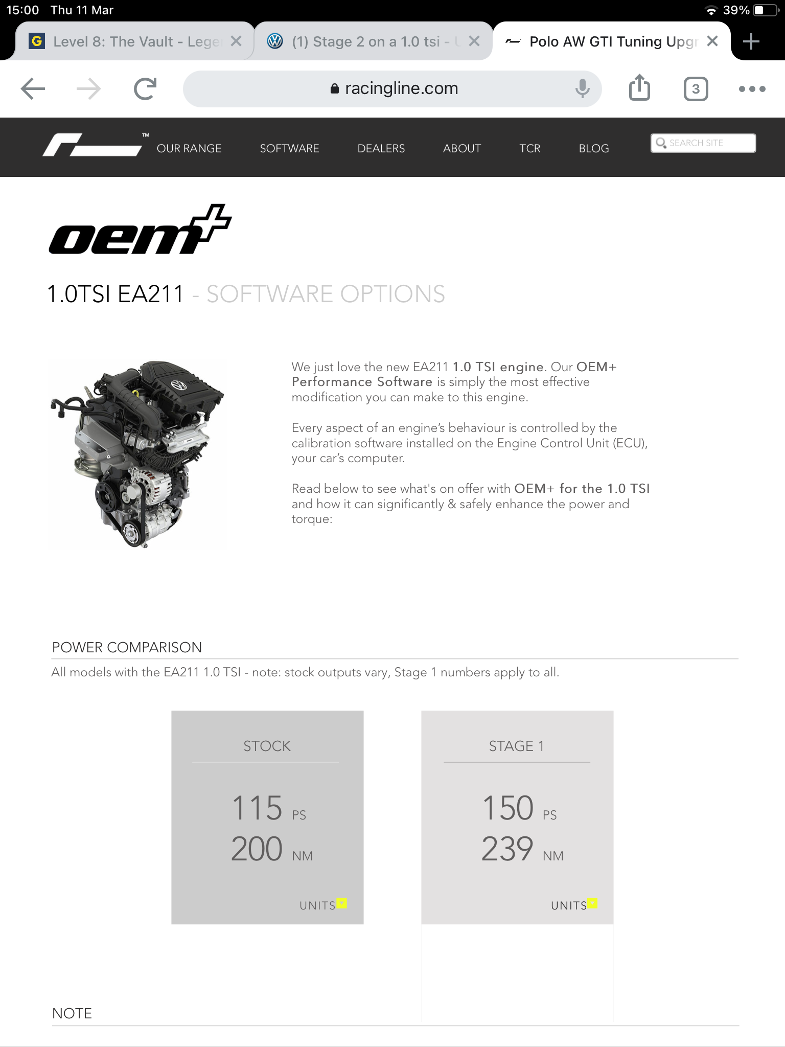

Personally I’d be looking to change oil/filters every 6months/6k, also I would only use Shell V Power petrol for the cleaning properties. The last thing you want is the engine to go pop.
Racing line now do an official stage1+ remap and panel filter and turbo elbow for the 1.0tsi.
Also personally I would not go beyond 150bhp so as to keep a certain amount of reliability and drivability. You may need a stage 1 clutch from somewhere like CG motorsports to cope with the power.

TheRacingRat wrote: Thu Mar 11, 2021 3:05 pm Personally I’d be looking to change oil/filters every 6months/6k, also I would only use Shell V Power petrol for the cleaning properties. The last thing you want is the engine to go pop.
Yes the car is already run on premium/v power only, going forward that will probably end up being solely V-Power. I have actually tried both the panel filter and turbo inlet from racingline on the car but felt like there was no noticeable difference so they’ve been taken off and there is just a K&N panel filter in its place that gave louder turbo noises, which I preferred.
