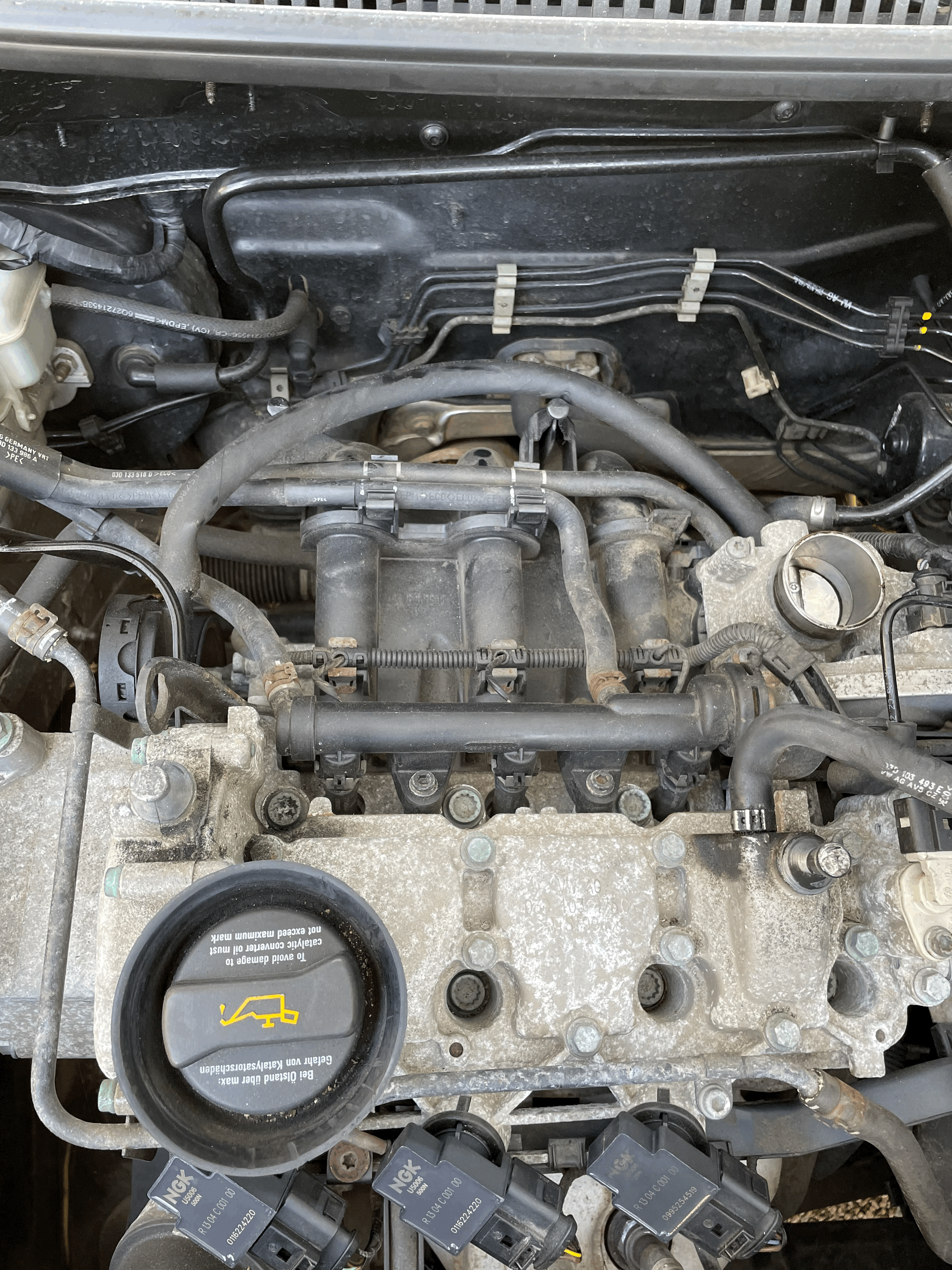

Hi, I am new to this forum, having just bought a 2003 1.2 Petrol Polo. I have taken off the air filter to service the car, and noticed that it was snagging on a pipe - which almost certainly isn't original - and it needs replacing with the proper part as its crimped on the left side. I have attached a picture - its the pipe that currently arcs round the back of the engine from one side to the other - and goes into the side of the carb. In all the online pictures I can find, it shows a straight pipe which sits further back in the bay, so doesn't snag the air filter pegs. Any idea what this pipe is called so I can find a proper part? Thank you in advance.... Jonathan

Looks like a vacuum hose of sorts, I'm guessing it's a BMD or AWY engine?

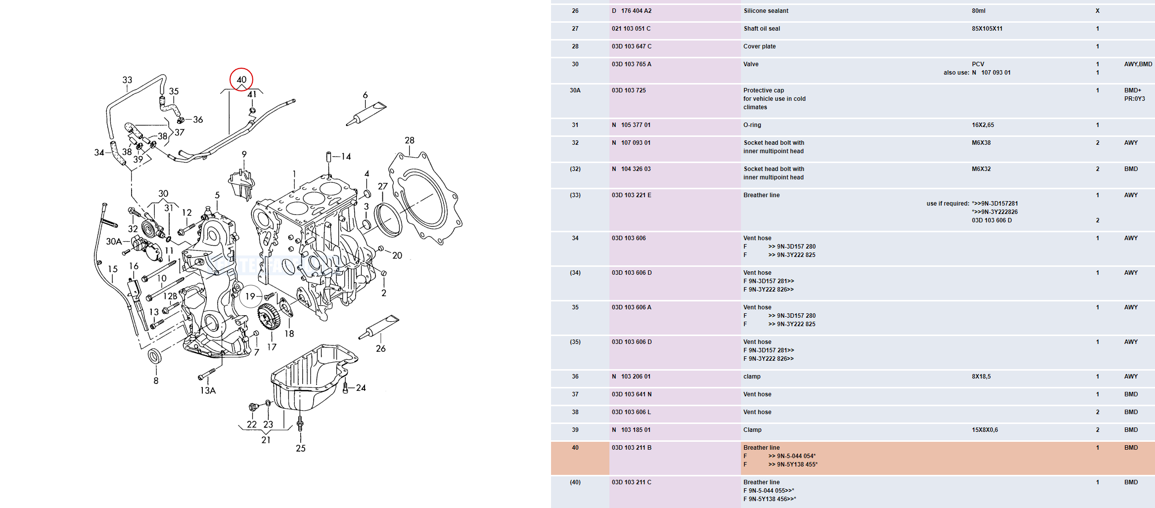

From what I can find it looks like it's for the PCV valve and is made up of several hoses. Differing between the two engines.
Hose screenshot.PNG (258.33 KiB) Viewed 1782 times
I'd give your local dealership parts department a ring to confirm as they can pull all the relevant parts up using your reg or VIN. They should also be able to give an up-to-date part number and price as well.

Oh my god, you are a genius - I have been searching for a parts list to find that part for ages.... yes it is a 3-part hose.With the part number, I found one on Ebay --- thank you soooo much! Love this forum! Jonathan
