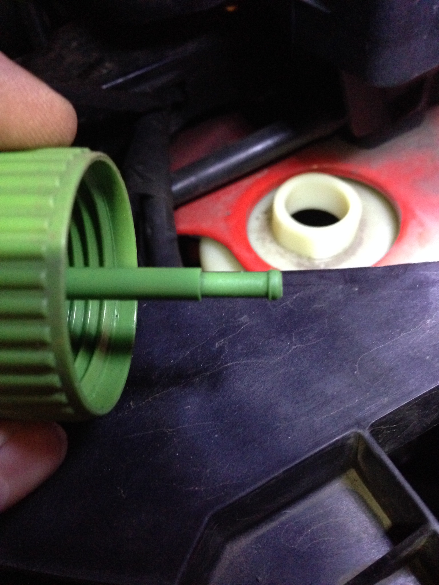

Been for a trip to the local garage and they confirmed that the power steering is not working correctly/on its way out. They put a diagnostics on it and checked all connections voltage etc, so I assume that the conclusion is that the pump or the unit isn’t working.
I just managed to remove a headlight and unscrew the green lid. The “dipstick” was wet but I dried it and put it back on and off a few times and it didn’t get wet! Looks to me like it is a little low on fluid.
Does anyone know what fluid it should take? I think I need to give it a shot before major work.
Posts: 6089
Re: Power steering problems
I tend to get a bit "precious" with some things, and means I bought the correct VW Group fluid - I needed it for my old 2000 Passat 4Motion as silly VW used some unsuitable hydraulic hose clamps so one leaked a bit, I never ever needed to top up the fluid on my wife's old 2002 9N Polo or my daughter's late 2009 Ibiza, so if you can see the top of the fluid then I'd accept that the fluid level is high enough though maybe just below the dip stick level, if you check it again after a run, you should probably find that as the fluid is hot/warm the level will now be high enough to touch the dip stick - or the fluid has been sloshing around and some ended on the dip stick. None of that will probably make you feel good though, but I'd think that the problem lies somewhere else - was that garage knowledgeable about that steering system - or just guessing? If you got a good VW Group indie to connect a fully VW Group compliant scan tool to that car, the read fault codes might give closer clues to what is happening. Starting to change power steering bits gets expensive which is okay I suppose if the diagnosis is spot on - painful if not!

I get what you mean but a 10 quid bottle of fluid is worth a punt instead of a new unit! The light hasn’t been on all this week despite the car covering a couple of hundred miles.
I have googled images of the reservoir and some have min max lines others have dots. Mine is become below the bottom marker which looks like a dot. How do I figure out what fluid to use or would regular power steering fluid work?
Posts: 6089
Only use a power steering fluid that complies with VW spec G 004 000 M2, that is why I just bought it from VW, but by now I'd think that there will be cheaper aftermarket suppliers, do ECP not sell it?
