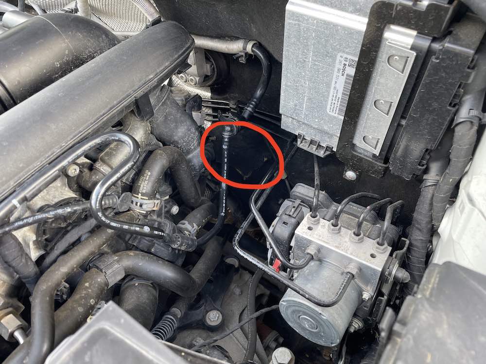

Hi, first time post. I'll say straight up I am no car expert, but I've run into a bit of trouble and would really appreciate some insight.
I have a Polo Match Edition 1.2 TSI 2017 model, bought just over a year ago straight from VW themselves.

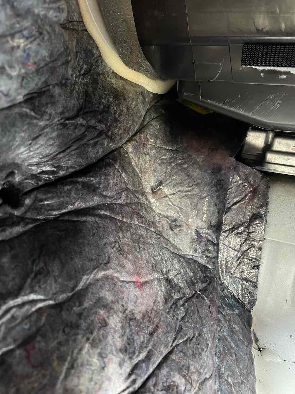

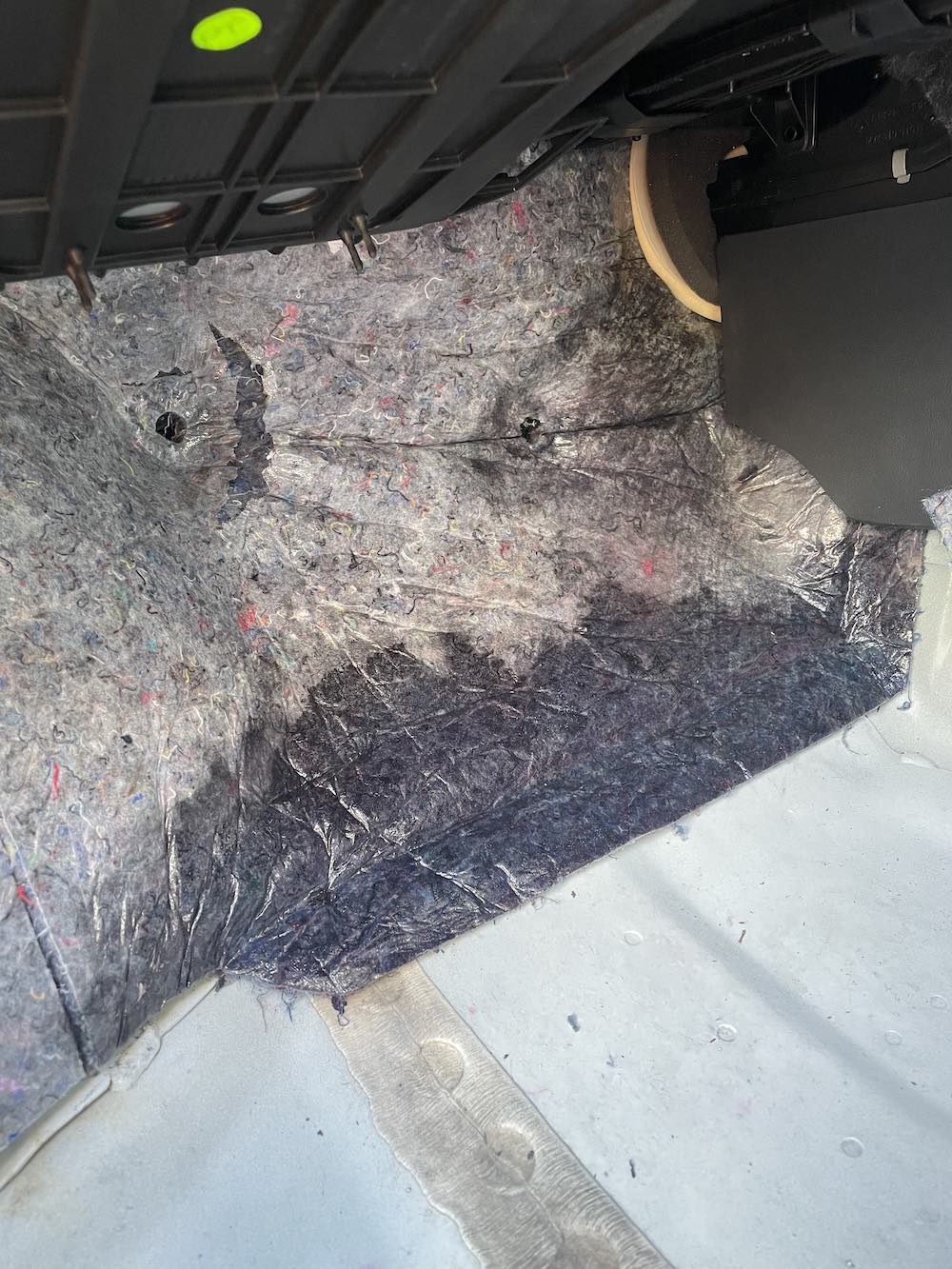

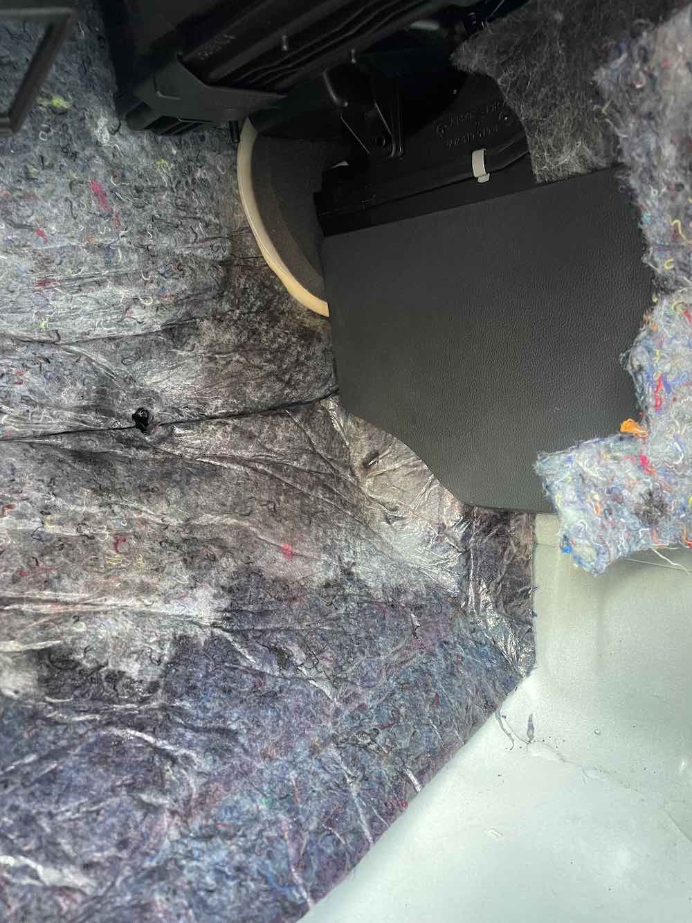

Recently I've discovered water under the carpet in the front passenger footwell. I've done some research online regarding the cause, and from what I can tell the scuttle vents are clear from leaf debris, and I've done a water hose test there and the windscreen to see where any water could be coming in. So far I can't see water coming in during that test. I also do not have a sunroof.

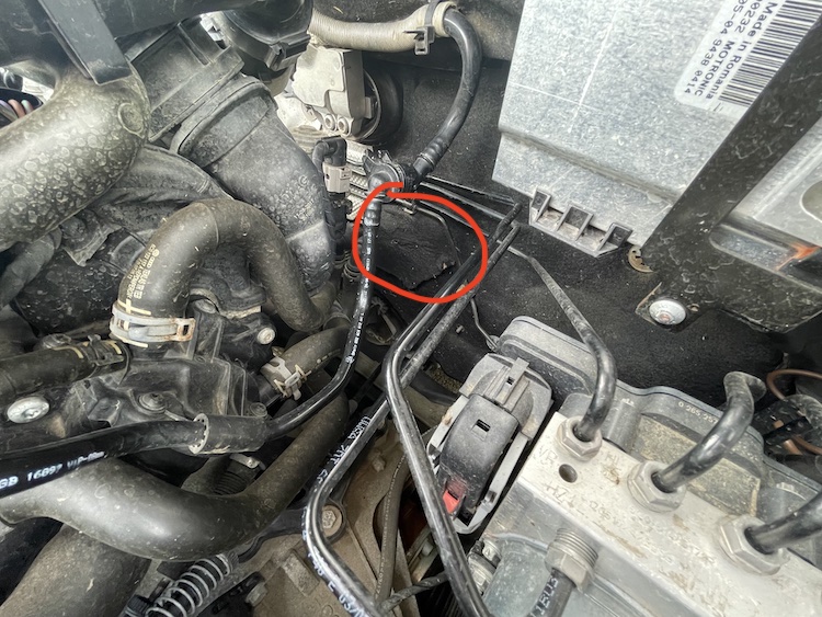

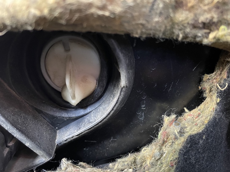

As you can see from the attached pictures, the water is saturated on the bottom of the fabric material, but it kind of leads up to the right behind all the controls/plastic. It all seems dry higher up the fabric. I've also read elsewhere it maybe something to do with the AC drain being clogged? I've tried to find the drain, but all I came across was this odd rubber bung and not a drain hole as such as seen in other examples.
It's been a very disappointing experience, as this is my first decent car! The VW garage wants £414.00 for a 3-hour investigation/test which just seems crazy to me. They say it usually takes a minimum of 3 hours, so goodness knows what the final bill will be if it goes on longer. Of course this issue would crop up a few months after my warranty ended :roll:
What's also annoying is I had some ridiculous condensation dripping inside back during the colder months, where a bit of fusty surface mould was found under the front passenger matt. Now I'm wondering if this water leak issue has been part of it all along!
If any more pics can be of help, let me know and I'll grab what I can. Thanks.
p.s. I've circled in red where I found that rubber bung.

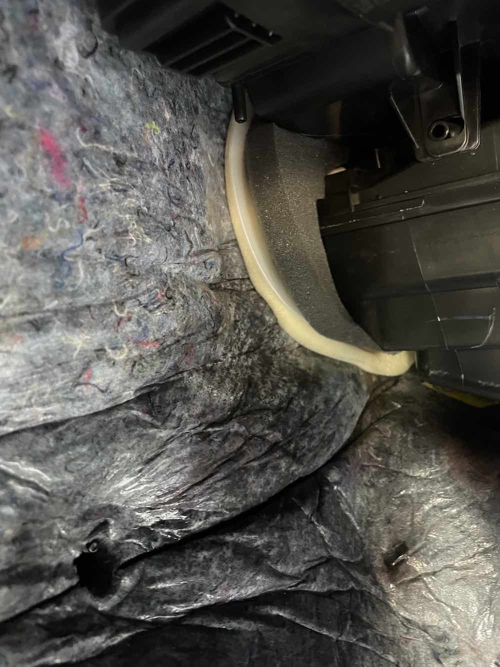

Update:
So I'm pretty sure the leak is coming from behind the area circled in the attached picture. I returned from a drive noticing more water slowly saturating, and put my fingers behind that circular foam pad trying to trace the source. I could feel a rubber piece behind it, and the water dripping in. Unfortunately, I don't know what the piece is or how to access it properly. It's like condensation coming back in through it?
Any thoughts?

It does have A/C yes, and I've been avoiding using it on my journeys to see if everything dries out, which it hasn't. I haven't exactly found the drain tube yet. If you look at one of my post pics, you'll see where I thought it might be, but instead found a closed off rubber bung. Unless I've looked in the wrong place?

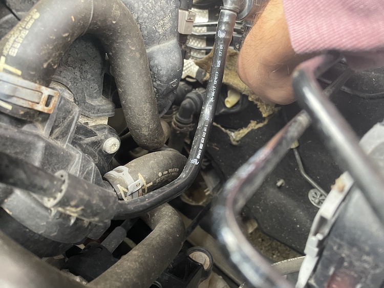

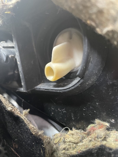

Just to update and hopefully conclude this topic, looks like I have finally found and solved the problem!
That odd rubber bung I posted a pic of before, turns out it was indeed the A/C condensation vent tube, but it had been squashed in!
This must have been the way it was since manufacture, as if it wasn't for me cutting the felt I would never have been able to fix it.
I've tested the A/C on a drive, and touch wood the interior remained dry, and checking under the bonnet the tube was dripping condensation as it should be. Phew! Fingers crossed that was the problem, and I just need to address the mould specs caused by the condensation.

Can you give me and others a more-detailed description of exactly where that AC drain outlet is sited? Normally, is there a tube connected to that drain outlet, a tube that'd carry the fluid downward and deposit it on the ground? How accessible is that drainpoint? Were you able to get to it in the engine compartment only by cutting open the sound deadening on the bulkhead? Is it actually right low down on the bulkhead? I ask because I'd like to check the status of mine.
You say you found that, on yours, the drain outlet had been badly damaged when originally fitted. So, did you therefore buy and fit a replacement drain outlet? The two pics you've provided show a damaged drain outlet and what appears to be a good one.

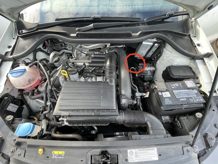

I am too interested more on this, where is this white plug location exactly. My polo can mist up in the rain say when I stop at lights the car cuts off (BM). After about 30 sec mist comes on the windscreen. Maybe it's down to this..
You say engine pic were you circled?

Post by DarrenR »
Sorry for the delay in replying!

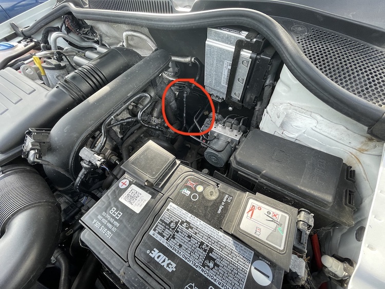

I've just gone out and taken some new pics to show exactly where the drain is. Hope this helps identify it! Yes I had to cut the fabric to find it, based on where I believed it should be.
And no, the drain wasn't replaced, the little tube was kinda folded back in itself, and a bit of a wiggle freed it. It was a bit of luck really!
