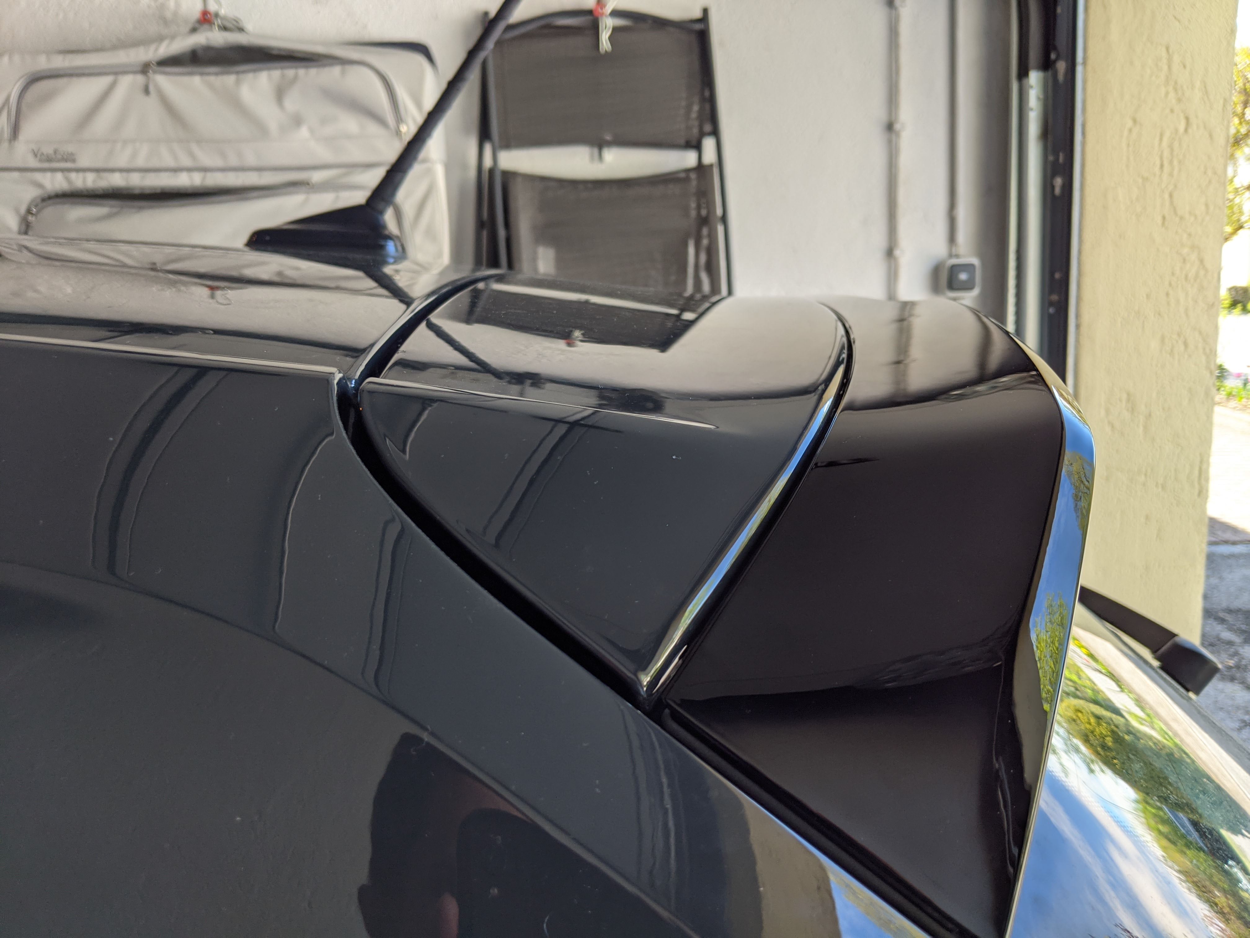

Hello everyone!
I have the Highline version of the Polo and I am looking for the black spoiler extension that stock R-line comes with. Has anyone retrofit this to a non-Rline version of the car? Does it actually fit? Where can I find genuine VW parts in Europe?

I cant see why it wouldn't fit its the same shape.

All you have to do is find an R-Line then get the registration number plate then go to the dealers parts department and give them the R-Line registration number and get them to look up the car and get the part number for the spoiler then you order it!!!

Re: Retrofit R-line's spoiler
Post by stepfla »
I retrofitted one to my Highline Polo and I'm glad I did :-)
This is a geat website to find part numbers: https://www.ilcats.ru/vw/?function=getP ... anguage=en
You will need:
- The spoiler itself: 2G6827934A041
- The cover that goes "under" the spoiler: 2G6827699B
- And something to glue it to the car. I went for extra strong adhesive tape which worked well, but there are also specific packages: 000071785D

Wow! It looks awesome and it fits perfectly!
