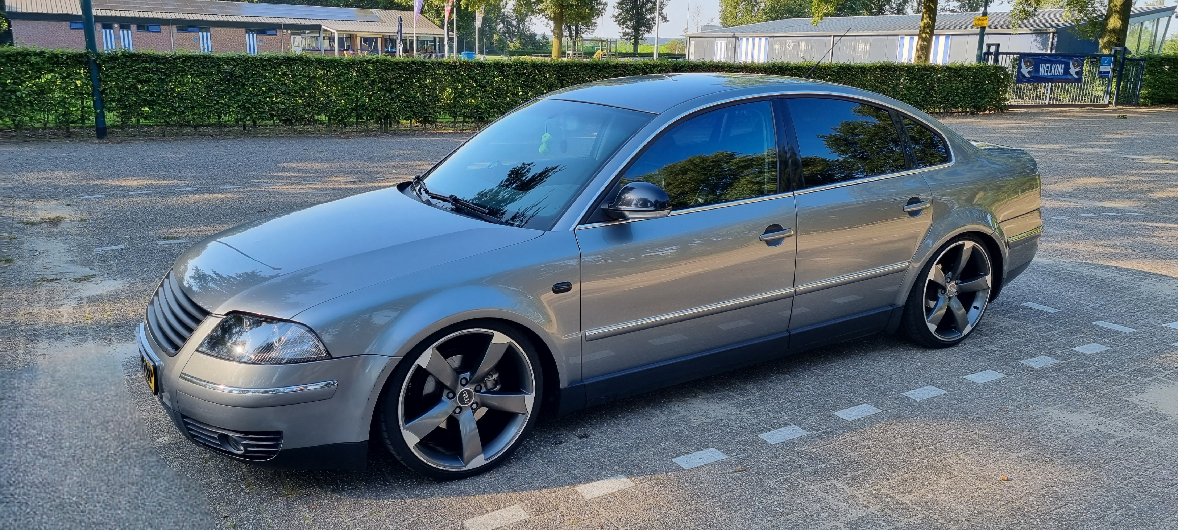

There won't be any significant updates regarding the Polo from now on. My eldest daughter has inherited the car and I've bought myself a new daily.

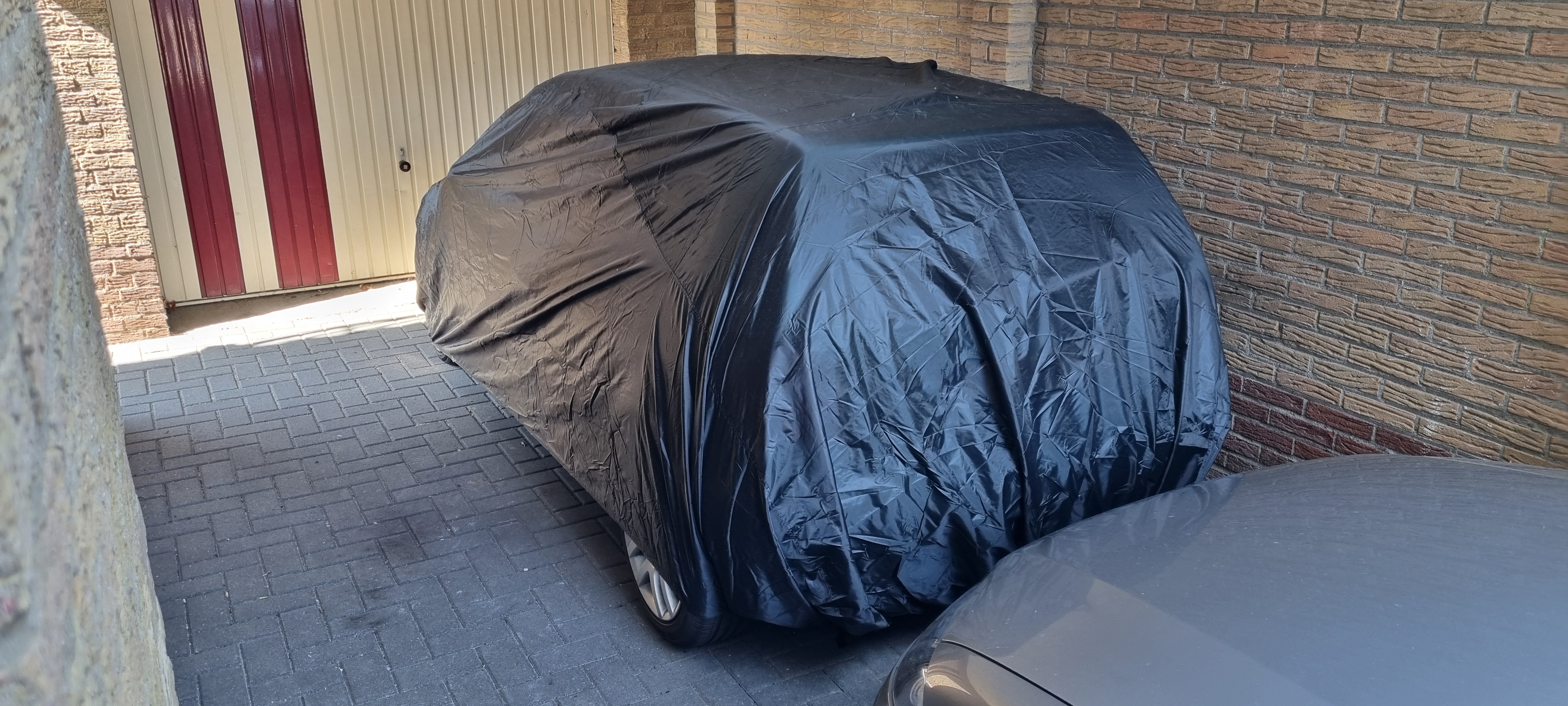

The Polo is back! Not sure what I want to do with it just yet, but I'm 100% sure I don't want to get rid of it. So for now it sits under a cover and it will be going into storage shortly. Who knows....to be continued....
