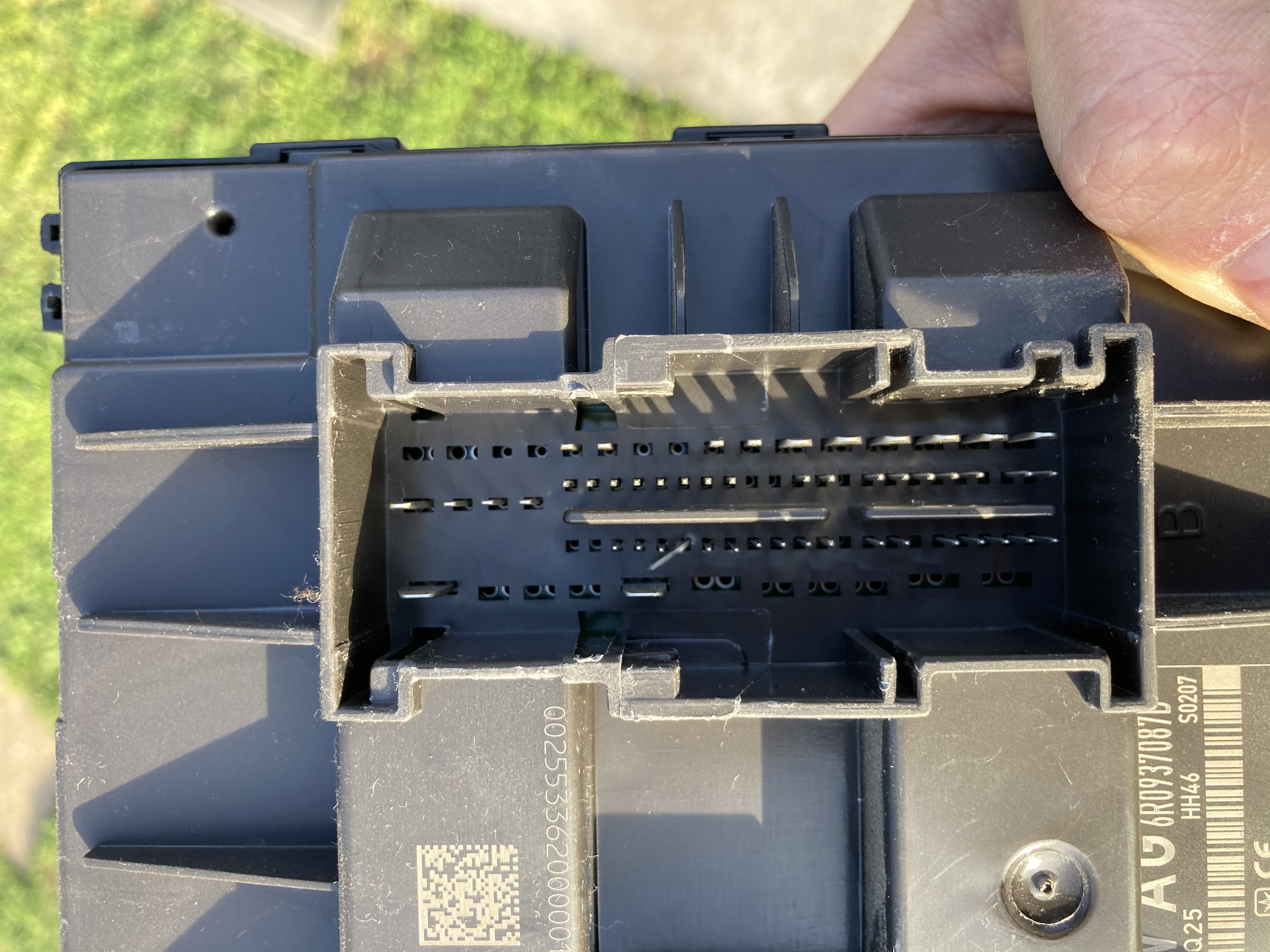

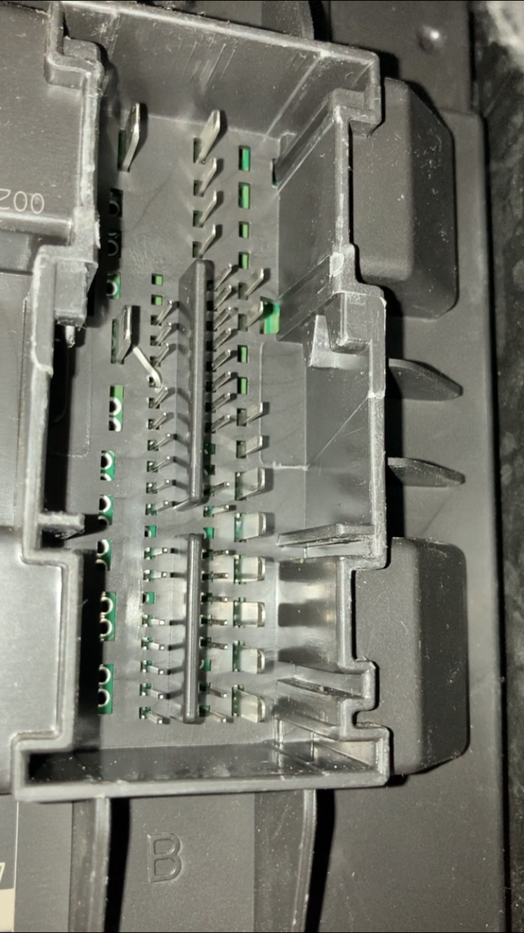

I have sorted the issue out. The problem was the pin 47 of the BCM. The pin was bent. I have fixed and it started to work.
