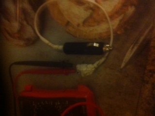

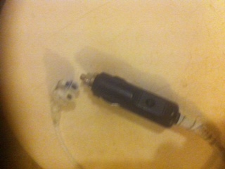

If you have VCDS then I would monitor your voltage with A/C & HRS (heated rear screen) on and also plot the engine RPM on the same graph, that will give you a good idea of how your charging system is performing.
A "snapshot" of what's happening can be done far quicker with a multimeter plugged into the power point and set to 20V DC, bring someone with you to monitor it as you don't want to end up in the ditch while watching it!.
Just connect up two connector blocks to the plug lead and stick the two probes from the M.meter into them, the polarity does'nt matter as it will just give a minus reading if reversed.

Did a relatively long (30 miles, each way) run yesterday and the M.meter read 13.0V to 13.4V "under way" or idling, and 14.2V to 14.6V on the overrun both with no auxiliaries on or dipped beams + HRS on (don't have AC), quite satisfactory IMO.
