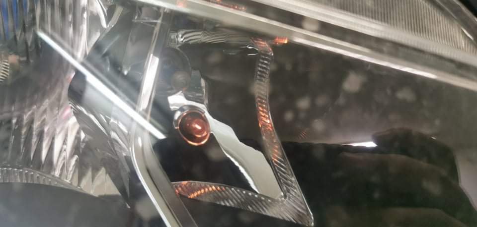

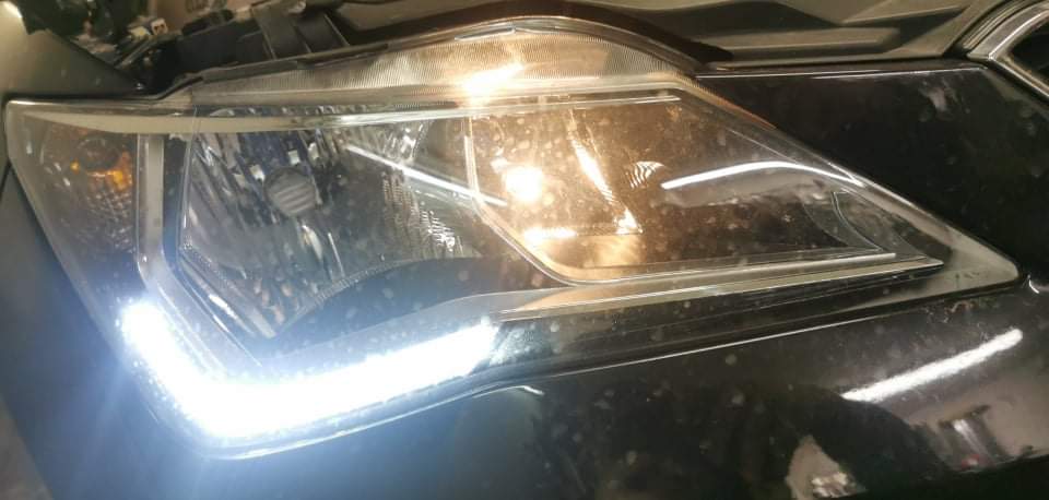

Cyclo your new coding :/

KamilPL wrote: Tue Nov 09, 2021 6:36 pm
iichel wrote: Tue Nov 09, 2021 6:03 pm It almost looks like your parking light T10 light is connected to the PWM signal, since it's very dim with parking lights and full brightness with DRL.
Tomorrow I will throw in autoscan, but apparently no errors, any idea how to solve the problem with the DRL / parking lot?
It is possible, it will be necessary to try with other BCM codings.
I will take a look.
KamilPL
Posts: 125
Joined: Tue Aug 03, 2021 4:26 pm
Drives: Seat Ibiza 6j1
Location: Poland
Post by KamilPL »
ciclo wrote: Tue Nov 09, 2021 8:03 pm
KamilPL wrote: Tue Nov 09, 2021 6:35 pm ... why does it have to be reverse and rear fog under bcm control?
It is because of how the BCM Max works, and because it is the original way, contemplated in diagrams, of a proper installation.
Otherwise, errors in diagnostic readings would be generated.
Currently, the rear lights are not under the control of the bcm because the electrician says that they work properly and since there are no errors, you do not have to do it like this :roll: :?: :?:
Posts: 8976
KamilPL wrote: Tue Nov 09, 2021 7:53 pm ...
False, that is not the BCM coding that I provided you, my BCM coding here :arrow: viewtopic.php?p=585587#p585587
I said it was better not to touch the coding ... I don't know why I was ignored in this regard. :lol:
It does not matter, I am very used to the fact that due to multiple circumstances people say things incorrectly ... nothing to worry about! :)
To find out what's going on with your DRLs and side/parking lights, try these new BCM codings:
1-
7C8829F88861010001200EF06EEB9EC85FC067FF608D20C1200000030000
2-
7C8829F88861010001200EF06EEB9EC85FC067FF608C20C1200000030000
and tell us the results to know what is the next step to take.
Regarding the reversing light and rear fog light:
Some diagnostics were already disabled in your BCM coding, which may be the reason why the Autoscan does not show any faults, but I would like to remind you that diagnostic failures arise when those lights are activated.
If there are no faults in your instrument cluster, or in the diagnosis, and you are happy that way, leave it as original, but you may lose the diagnosis of said lamps in case the bulbs fail.
Work properly: When everything works correctly.😄
