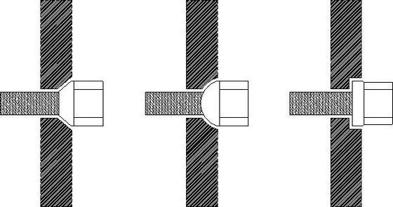

I’m not sure your wheel fitter was referring to the profile of the mating surface of the wheel nuts (or bolts) or the thread pattern on the inside of your wheel nuts. I think it might have been be the former. If it was, then hopefully the picture below help;
The picture above shows wheel bolts rather than nuts, but you can see there are three different types; tapered, conical (or radius) and square / flat. I’m assuming that with wheel nuts for fixing alloys to male hubs, there are also the three different types. It might be that the bolt hole profile in the Qashqai alloys is different to that in your existing Leaf alloys, in which case it wouldn’t be possible to use your Leaf wheel nuts as it wouldn’t be able to get a flush, tight fit between the mating surface in the wheel’s bolt hole and the wheel nut (hope that makes sense!), so there would be a risk of the nuts and wheels working loose.
The thread pattern inside your wheel nuts it what’s usually referred to as the thread pitch, and for obvious reasons the thread pitch of the nuts and the stud must be the same, otherwise it won’t be possible to physically fit the nuts onto the hub studs. If you’d supplied just your original nuts to the fitter to attach the new wheels to your car, there shouldn’t have been any issue with the actual thread pitch as the wheel nuts would’ve been going back on the car they came off. That’s why I think they may have been referring to the profile of the mating surfaces of the wheel nuts and the holes in the Qashqai alloys, which presumably are different?
Is it possible that your Qashqai alloys aren’t genuine Nissan alloys but could be aftermarket copies? With VW, OEM alloys use conical / radius bolts and most aftermarket alloys use tapered bolts (there are a few exceptions - my aftermarket alloys use VW OEM conical bolts). If your Qashqai alloys are actually an aftermarket set with tapered profile bolt holes, then assuming Nissan factory alloys use conical bolts / nuts like VW, that might explain why the fitter said your OEM nuts couldn’t be used.

Yeah, I deduced he meant the angle of the nuts, rather than the pitch.
The QQ wheels have a deep sloping hollow to them, the industry standard is 60 degrees I believe.
The Leaf nuts are more or less flat.
New nuts ordered.
They're Nissan wheels.
