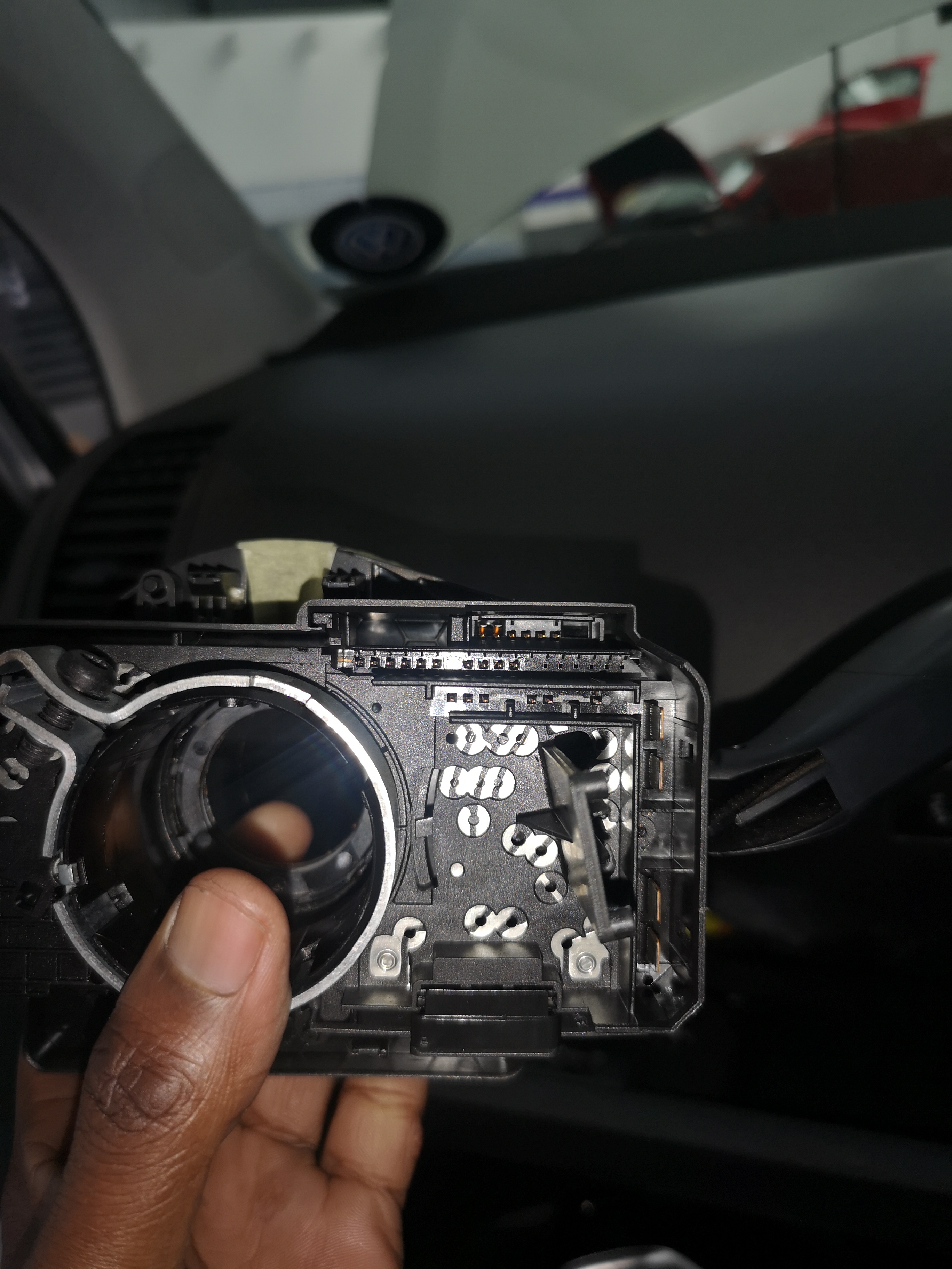

Can I please request you to share pictures of the Driver's door connector and where exactly to locate it?Jay-Jay wrote: Tue Aug 22, 2017 11:30 am I've been able to install the two extra wires pretty easily with few tricks:
- I took the LIN bus from driver's door connector (T28a, pin16), which is more more easy to reach, instead of connector T73b, pin 17.
- I used fast electric connectors instead of soldering.
- Jay-Jay
- Posts: 327
- Joined: Mon May 02, 2016 6:02 pm
- Drives: Polo 6R HL 1.2TSI 77kw, Audi S1 MY2018
- Location: Rome (Italy)
Re: 6R - Multifunction Steering Wheel Retrofit
Here are two pictures found on this forum:

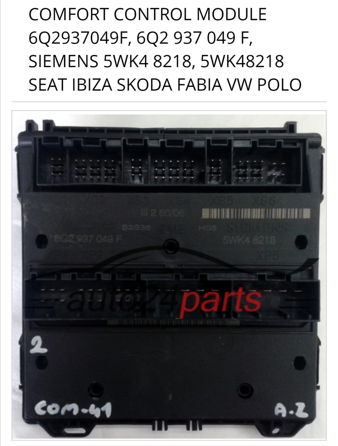

Hello
I have read your post about retrofitting a MFSW on a polo base/trendline. In your post you've indacated that:
- A -
Plug in of a repaire wire to pin 9 on the stalk/clock spring and then connecting to 12V (no 15) on my light switch to illuminate the buttons on the wheel, and...
- B -
Plug another wire to pin 10 on the stalk/clock spring and running it to the BCM, no 17. And then running pin out from 20 & 21 to the stereo/radio deck before programming the MFSW on the BCM via VCDS.
Problem:
I have a Polo Vivo base/trendline (2011- picture attached ) looks similar to Polo 9N3. My BCM model number is 6q2937049f.
Point -A- I followed the process but it doesn't work at all
(illuminate the buttons). I have tested and confirmed that there's power in the wire (pin 9) to the stalk but it doesn't work. Q: Does it not perhaps require a seperate/additional wire to ground it or to 'circulate current'? Does illumination require VCDS programming to work? If so how/why as it this connection does not run via BCM.
Point -B- my BCM looks different to your example, and only has pins 1 to 18 with multiple open slots.
How do I at least resolve point -A-? Before I can even think of -B-
I would highly appreciate your assistance in regard.
Thank you
([email protected])

- Posts: 6695
You're in the 6r section but that's the wrong place for your question

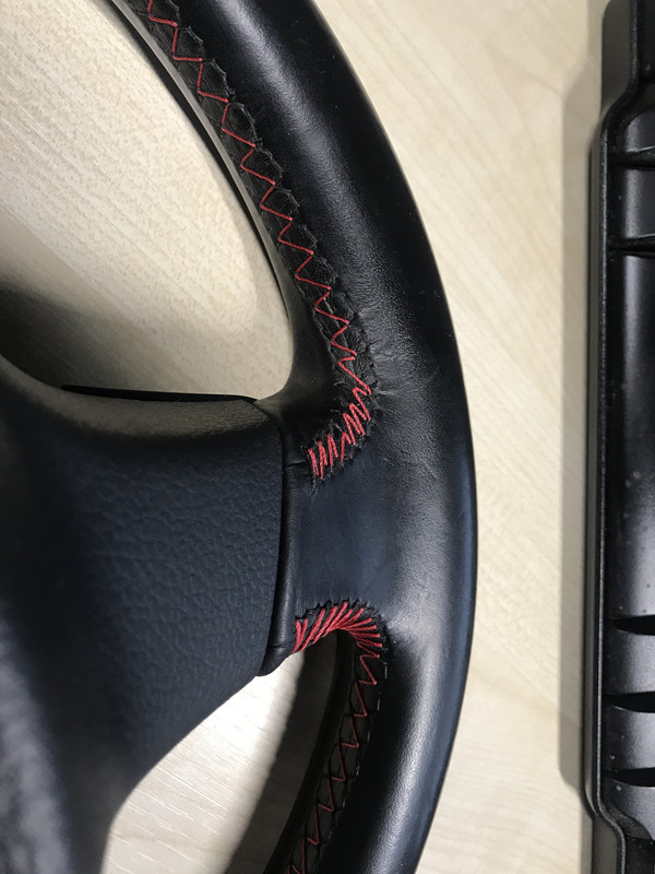

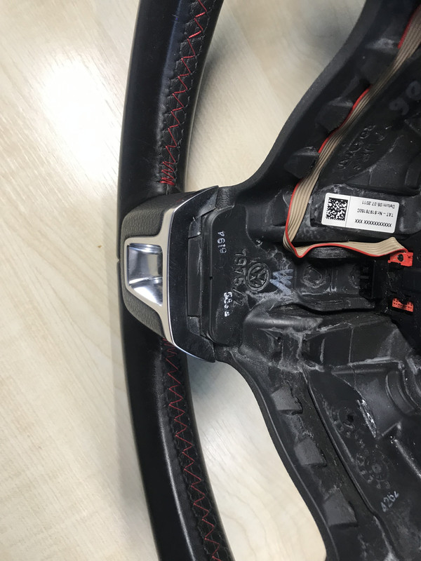

Sorry for dredging up an old post but after a good search it seems to best suit my aims

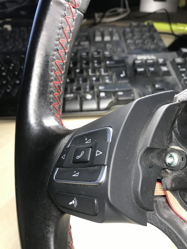

I've got a 6R 2012 Match with the standard plastic steering wheel
I've picked up a similar wheel but leather and with the left hand buttons
I need to get the airbag that fits and the airbag loom
Can anyone confirm the if loom needs to match the date of the car (that's what I'm reading from @Jay-Jay 's post below) and it's not matched to the production date of the wheel or airbag?
I'm wondering if I need to order the airbag before I pull the trigger on the loom
What issues would I get if I ended up with the wrong loom?
After a clean up of the replacement wheel I've also modded the wheel with some red stitching for shi7s & giggles...
Thanks for reading
Thanks for reading

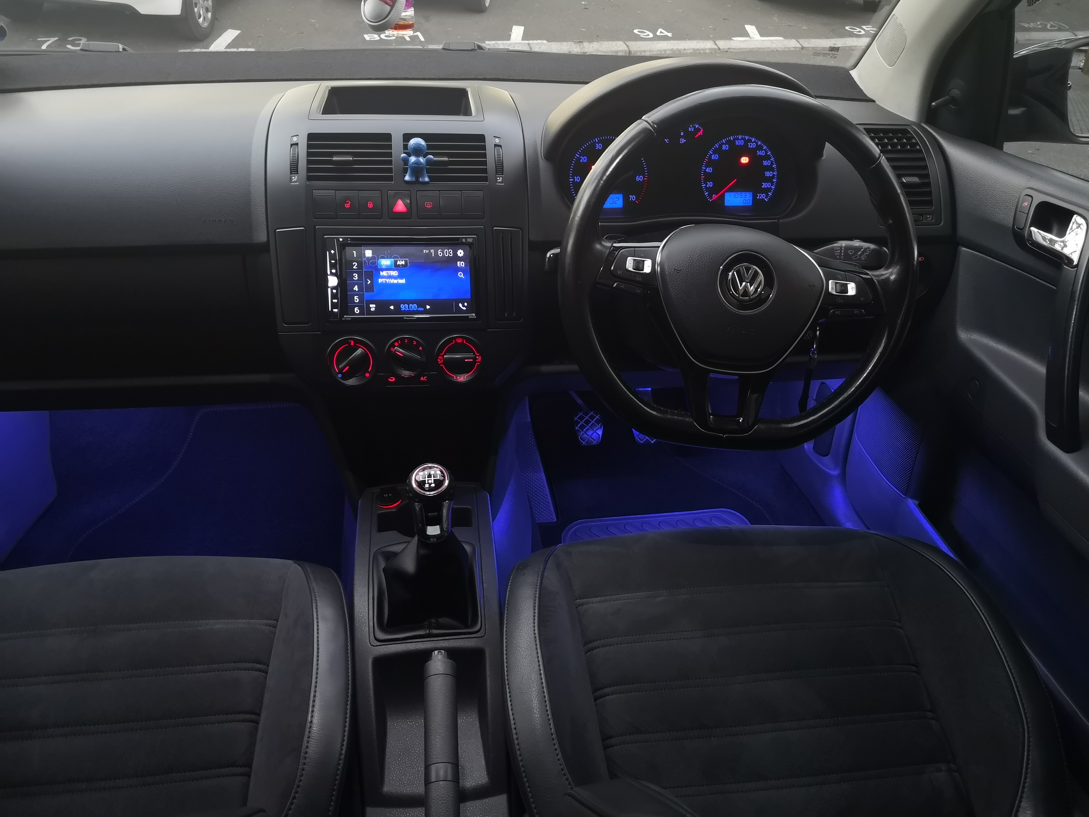

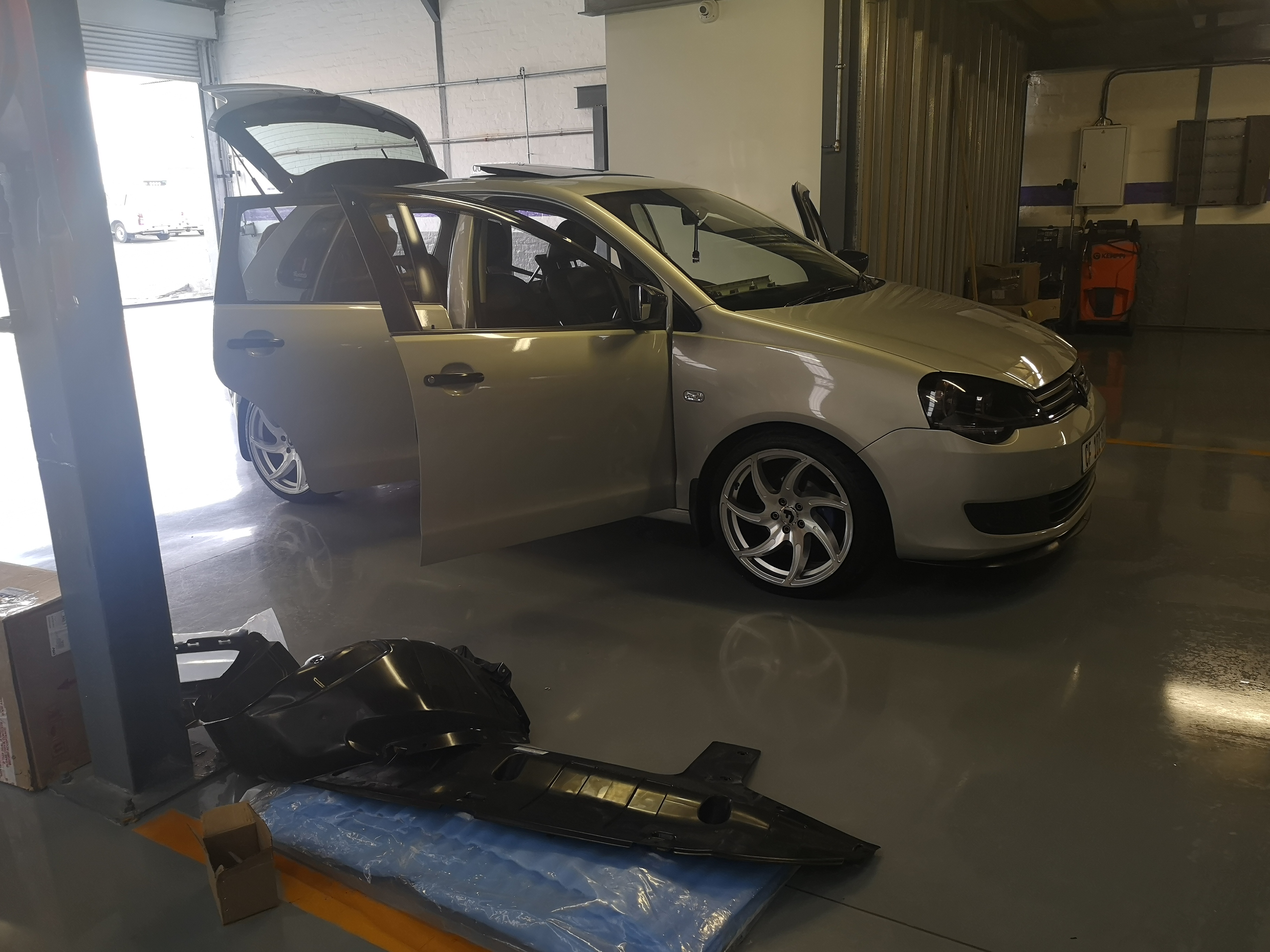

HI all,
Thanks for the wonderful information. I'm new here.
I have 2011 VW polo 1.2 TSI 6R.
I had been a regular no button steering wheel.
I bought this MFSW and trying to retrofit to my car
I followed every steps closely and it was a success.
However, I have 2 issues,
1) Only 4 buttons working.
On the Right, the only one working is "CC Off" button and it working as a Horn.
On the left, Page left --> Song Previous, Page Right --> Song Next, "OK" button reduce the volume
2) No Light
Based on the reading, I believe it must be something to do with the connector ring.
I would like to confirm it with the seniors here for that.
I am planing to add Cruse Control soon and hope I could use the paddle shifter also.
Here are the rest of the photos.
Thanks in advance
