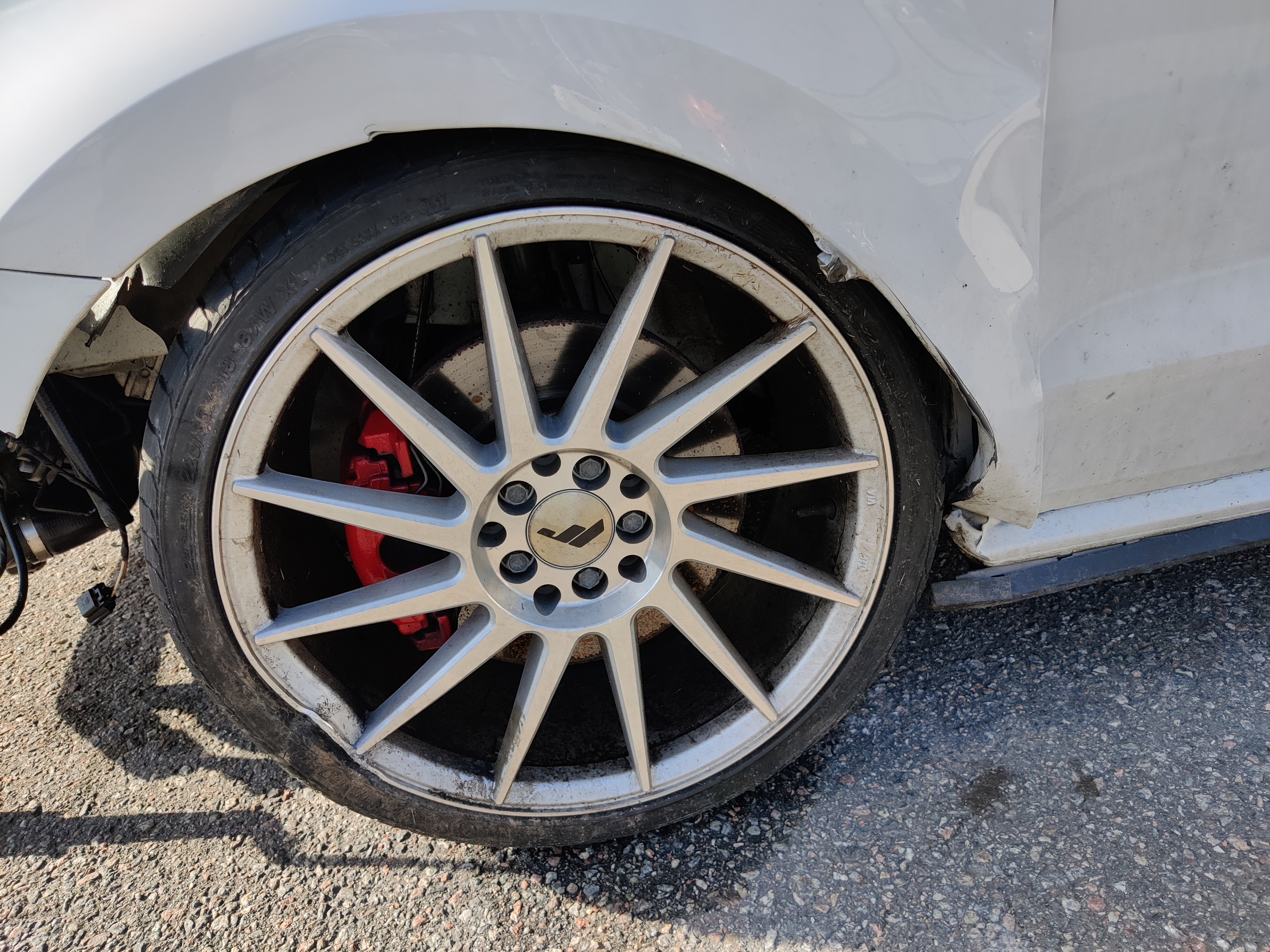

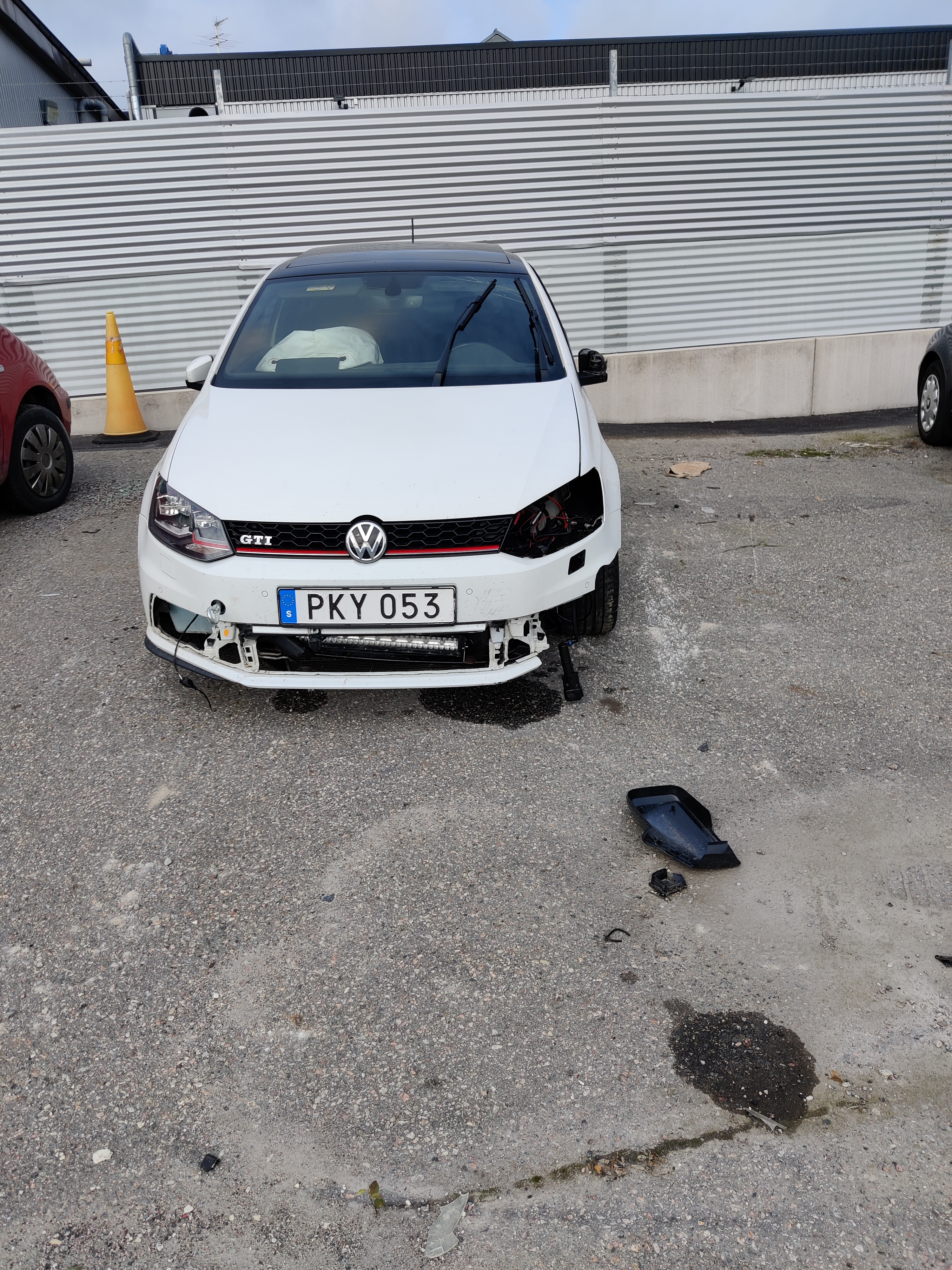

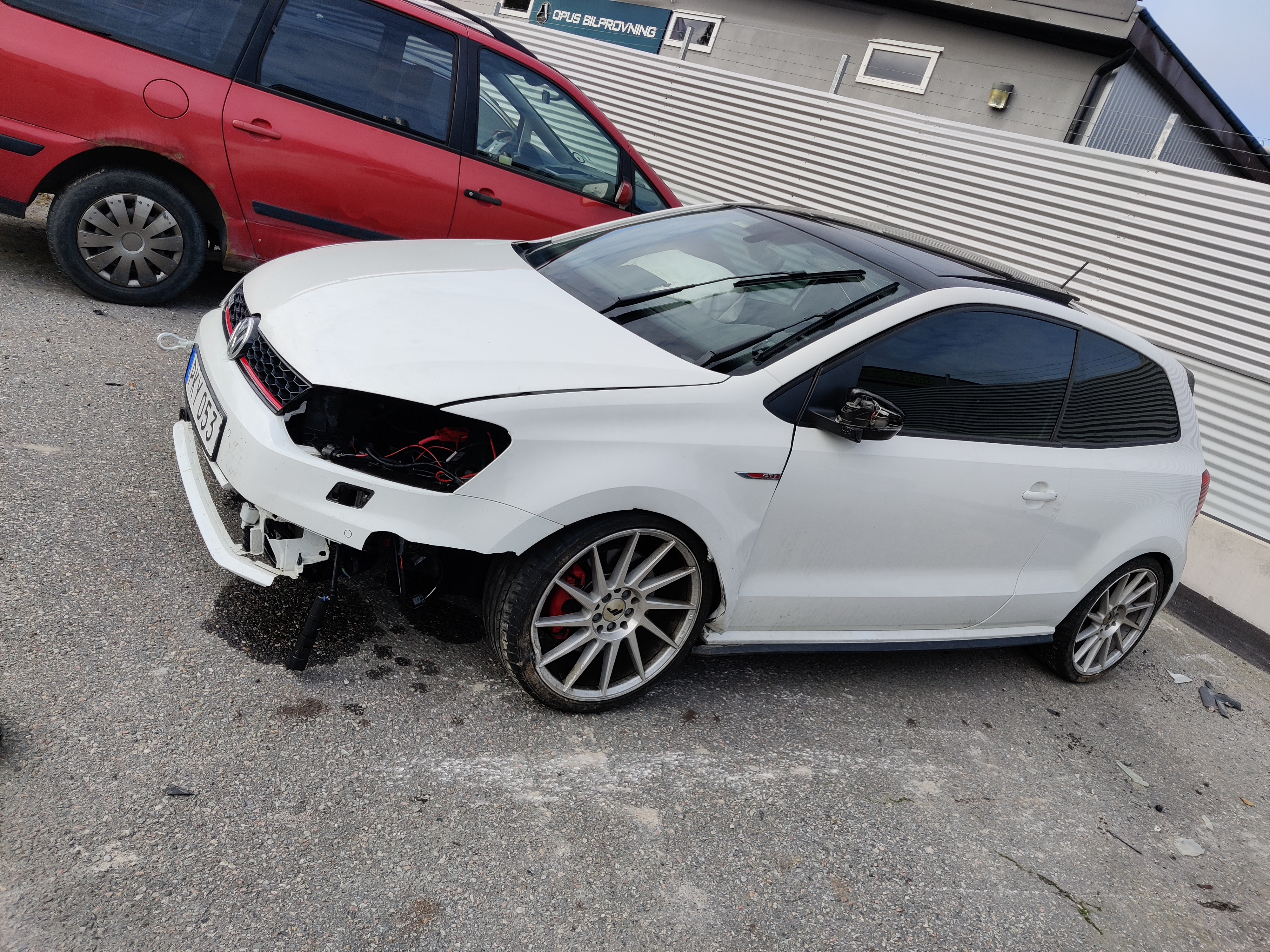

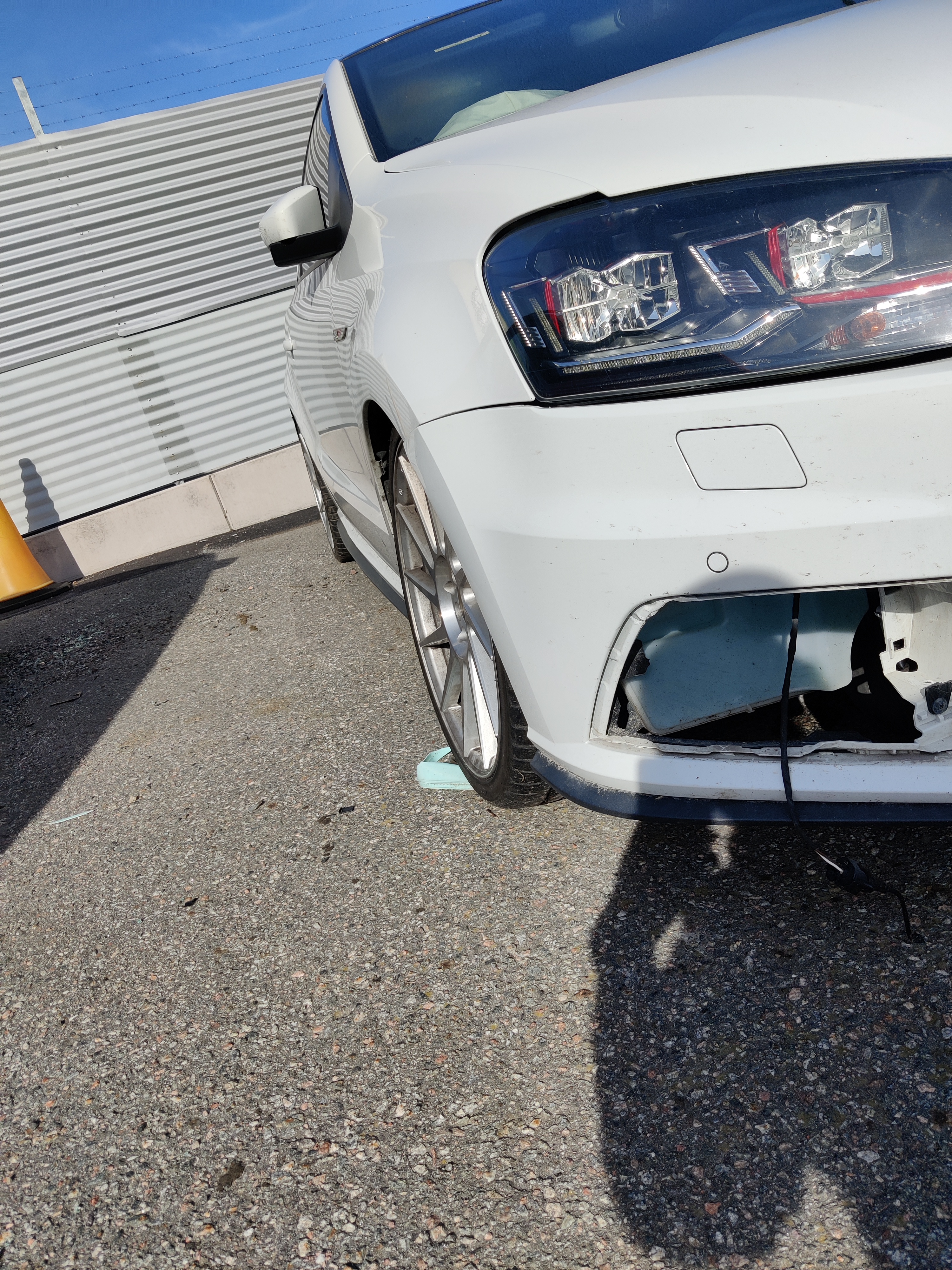

Car decide to go off road and wanted to stand on a big rock exactly under the engine. Havent looked at the car so much yet, but thinked just in case which car i can take engine from. Sadly Ibiza and a1 isnt that cheap as the passat, a3, a4 with 1.8tfsi or 2.0 tfsi.

Pics

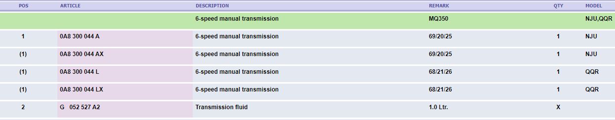

The manual gearbox code in mine is QQR, which is an 0A8 MQ350. From my own research for other things like short shifters and diffs the 0A8 is apparently somewhat different to the other gearboxes in the MQ350 family but what those differences are I don't know.

Does anyone know if the NJU box fits. half the price of a NJU against QQR. Look exactly the same.
Re: engine swap
I know the QQR transmission is physically smaller, to fit the Polo engine bay in, comparison to other MQ350 gearboxes

NJU is the gearbox from polo gt blue 1.4 140hp 250nm

Seems it's the same housing but different gear ratios
