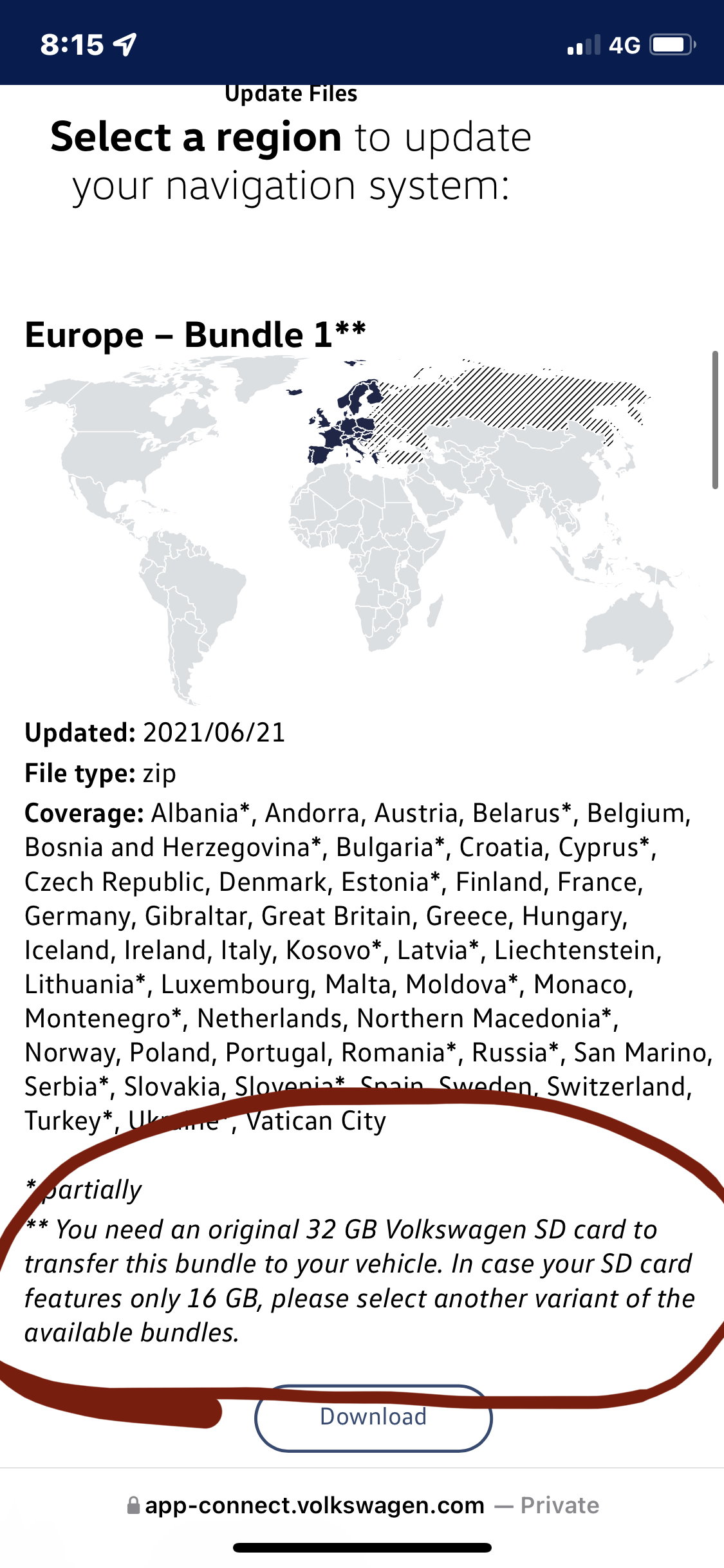

I’m glad the link was useful, the updates are relatively easy I just needed an original memory card with v14 so I’ll be ready to update to v15 when it’s available 8) … I’ve heard using cheap non original cards can make the maps bug out and glitch etc.
-edit
I’m pretty certain that initially vw didn’t put this little bit of information on their map updates page but I thought I’d add the screenshot.
