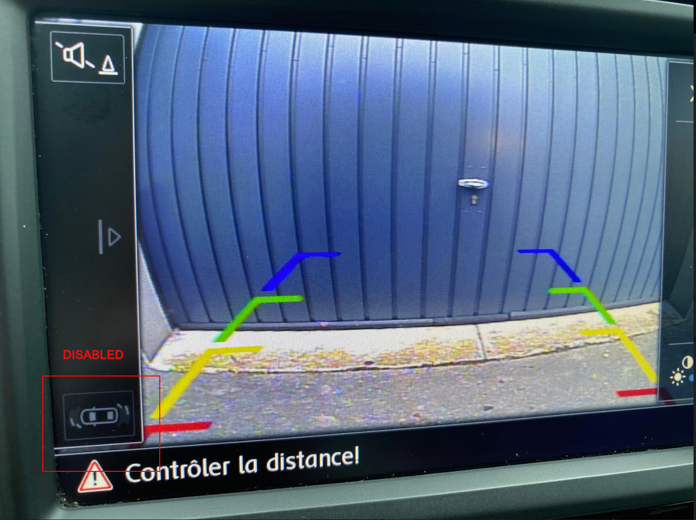

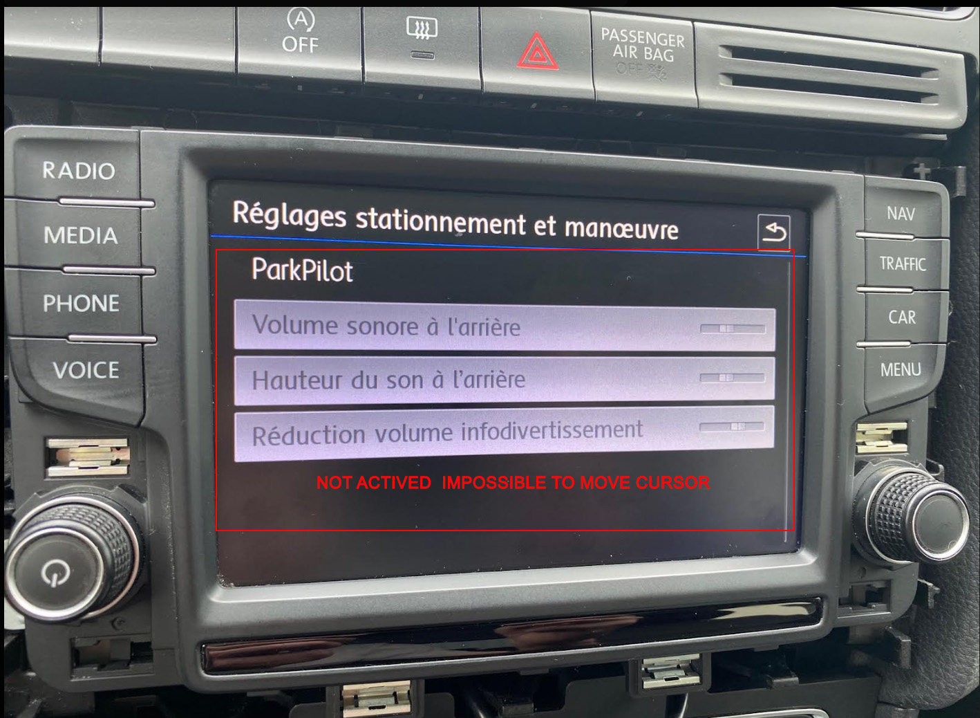

I come back to you again because today i made a retrofit from my rcd 330 to a discover media 3Q0035846A and i've got a problem again with OPS park pilot.
With my rcd 330 (previous posts) rear camera and park pilot was ok, here sound is ok but no ops and no fonction seems to be disabled.
My coding seems to be ok, any idea ? I paste here my old 5F coding and the new one.
Thanks !

RETROFIT KO ===>
02620001BE0000005111000100080A001F0100D401200100CF

- sound-off.jpg (348.77 KiB) Viewed 1166 times
- OPS HS.jpg (361.28 KiB) Viewed 1166 times

Hi Homer,
Hope you are well!
I have the same probleme in my polo 6R, with a Composition clour unit. I paid a 8K OPS retrofit in my car and my configuration menu is greyed just like yours...
Did you resolve this problem? what was the solution for you?
Thanks for hour help!
