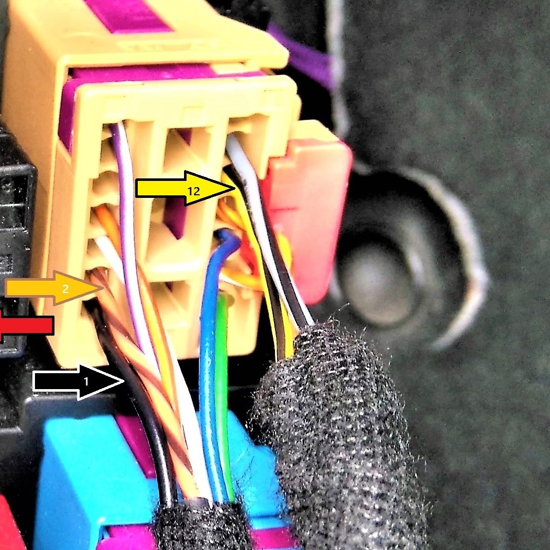

NO, don't touch that T2 connector, just do what I told you by email about the T4 connector.Carolco wrote: Tue Oct 12, 2021 7:38 pm Hello Fernando.
Thanks for your answer and your help. I have the entire area of the camera disassembled. I got all the guts out.
The two cables that I mentioned in the previous post are connected to this connector?
That is, I disconnect it from where it is now and connect it to that adapter?
Carolco wrote: Tue Oct 12, 2021 7:51 pm And the second dude, the conexion that exit from the camera (photo named 1) pass from 3 wires to 2 wires (photo named 2)..... and it follow to this point (photo named 3).
The red and yellow wire is the positive (like spain flag) and the other wire black and blue is the negative ?
The blue/black wire is not the negative/earth wire, it is the reverse signal, but it is no longer necessary because the reverse signal is sent by the CAN lines for the new RVC KA2.
That original red/yellow wire is also not necessary when installing the RVC KA2.
The new wiring from Aliexpress for KA2, and according to the pictures shown, must have internal splices for both the positive and negative wire. That is, it is only necessary to connect one wire and not two for both signals.
Just follow "my plan" (solution for the T4 connector) that I told you by email and everything should work correctly.

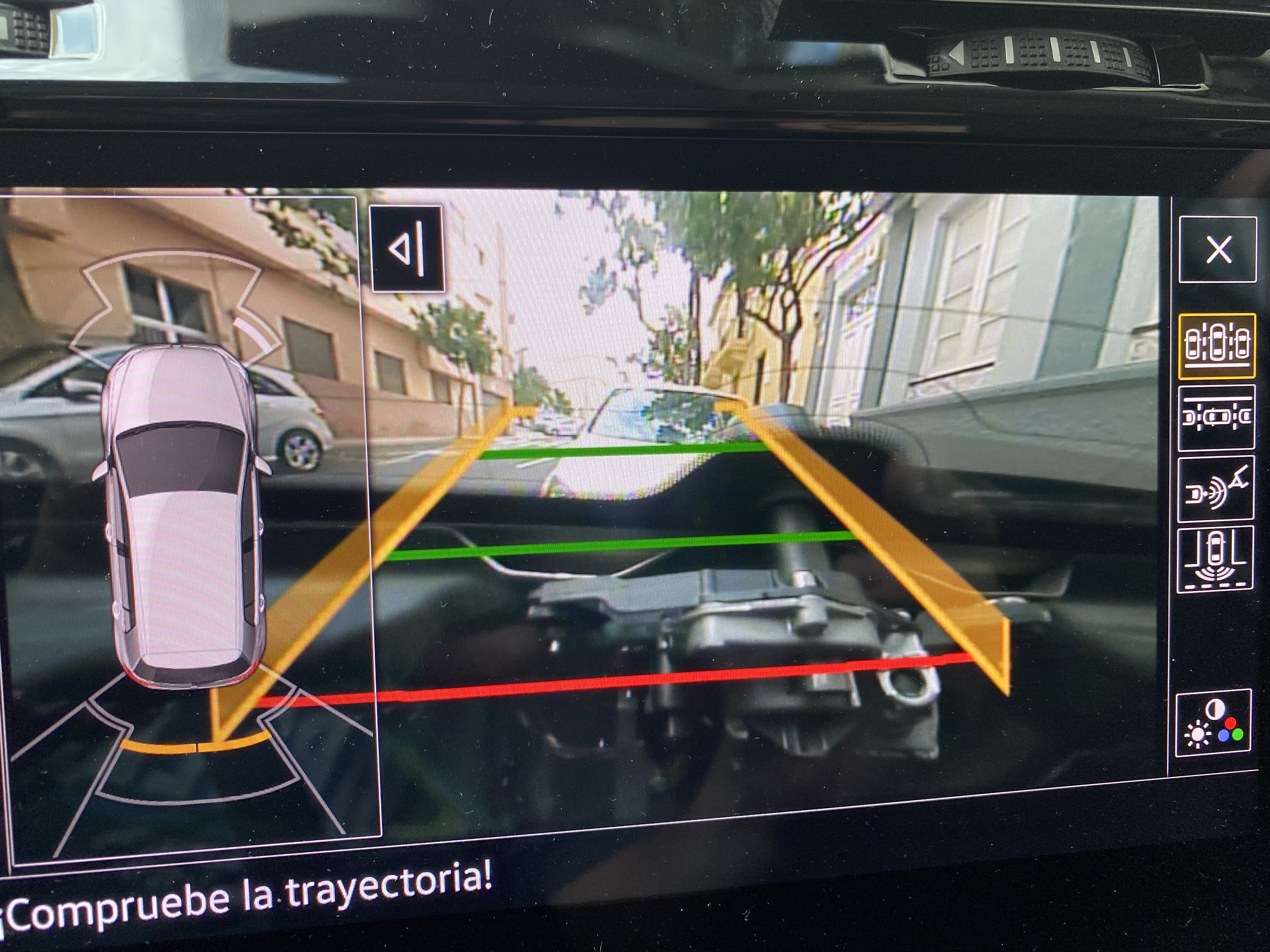

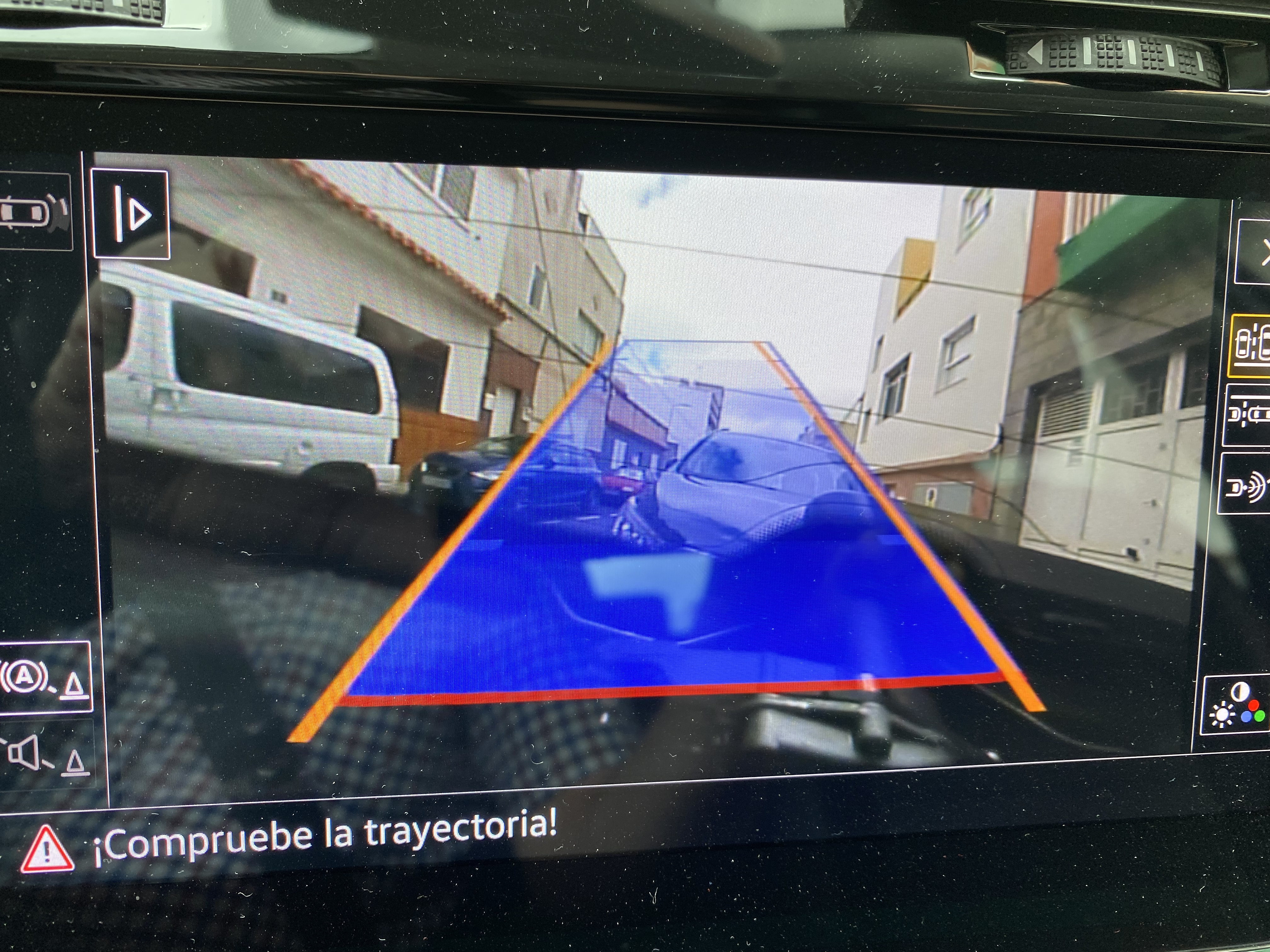

Hi everyone.
These past days I have been concentrating on the adaptation of the High rear camera. It may seem like a simple adaptation in theory, but for a layman like me it is sometimes very difficult.
I want to thank Fernando for his help and advice. Without them we would not have gotten to where I am right now.

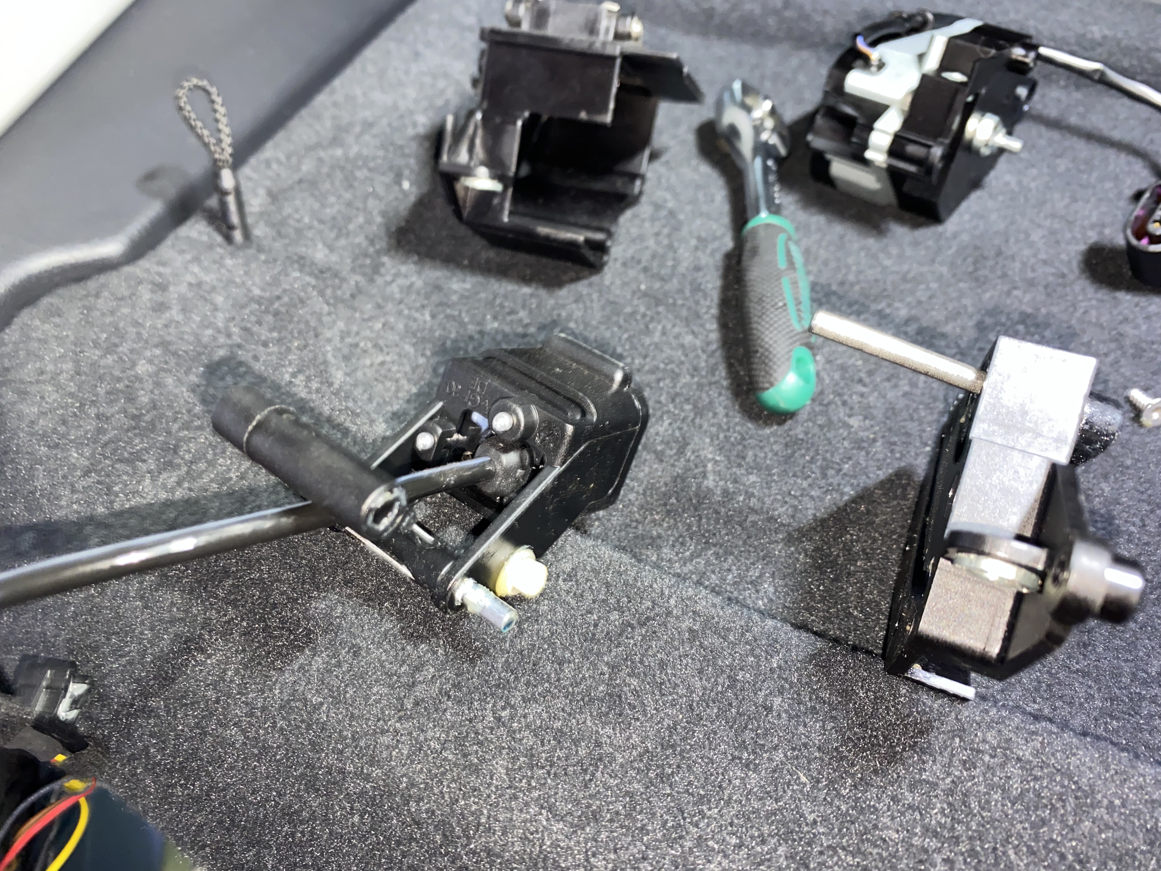

The first odyssey was the wiring itself and its adaptation to my car. As I already mentioned, my car came with the low camera as standard, and I wanted to adapt the high rear camera. At this point Fernando came to my rescue, because i was stuck.
The camera I bought came from an audi, and after solving the wiring issue and placing it, the obstacles began to jump. The cables were connected and the 6C unit appeared. Encoding adjustments were made, but the camera looked like Audi and not Volkswagen. The lines were red with a blue background and it did not allow to touch the coding of certain bits, such as the opening of the emblem, change the model to Volkswagen or activate some screen mode. It was funny because it did not give a basic adjustment error. The 6C unit had no errors.

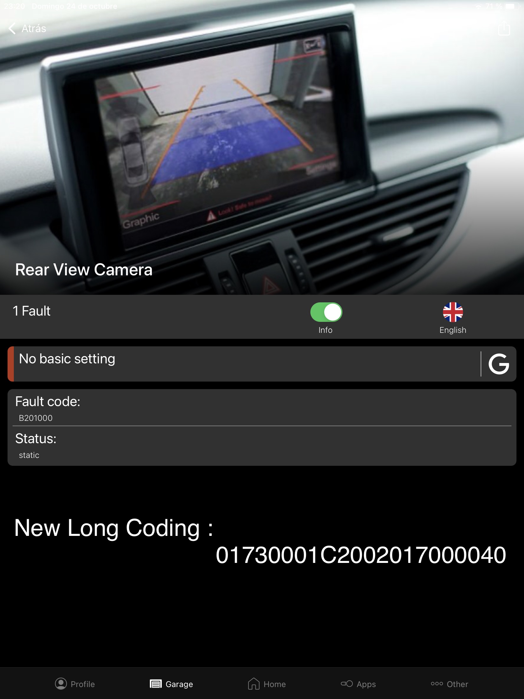

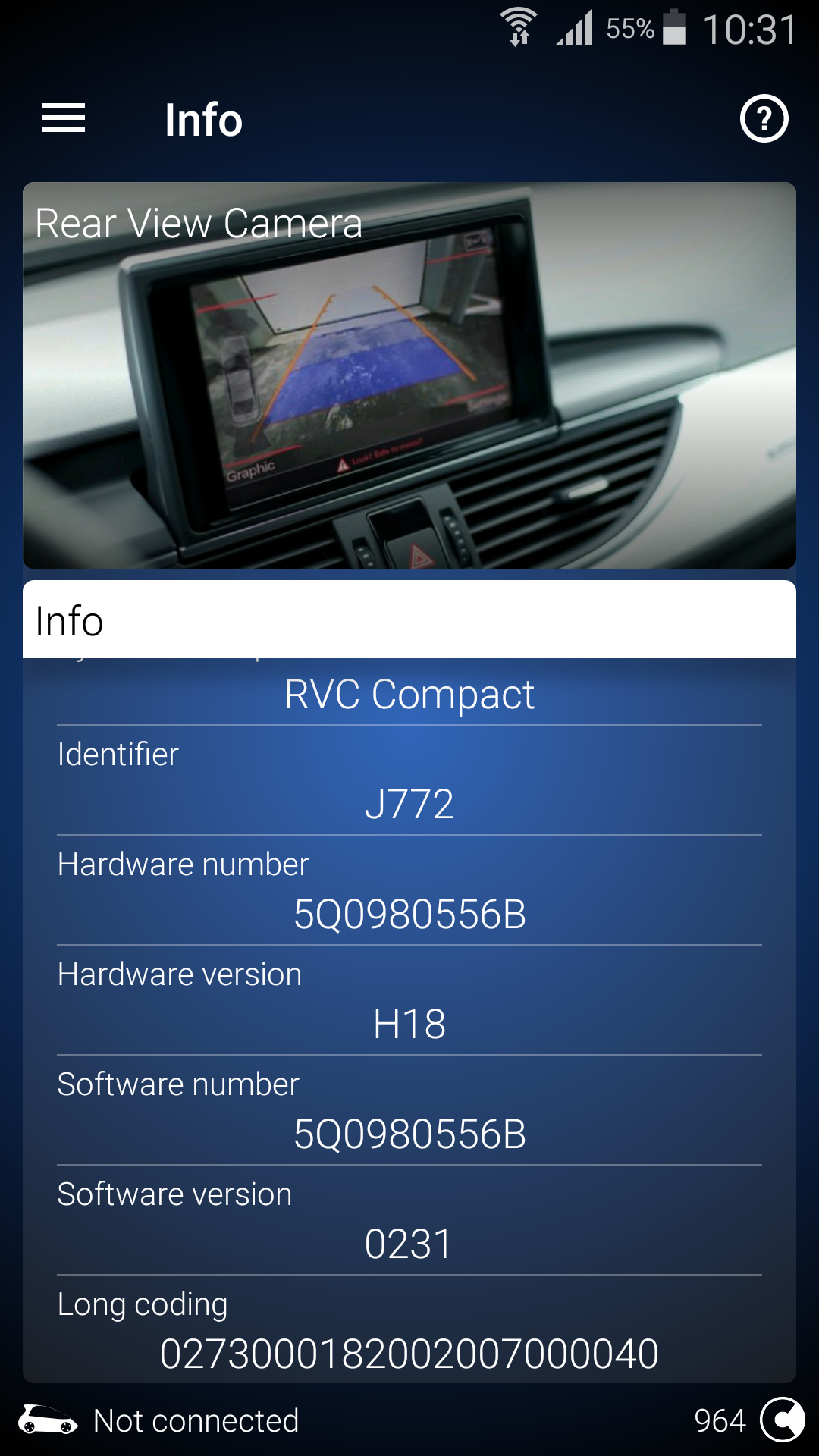

Today I decided to change the parametry and I passed through Odis engienering the Xml file with the V03935246NT parameter of the Passat. The car lit up like a Christmas tree during the process that lasted barely a minute, and after erasing the numerous errors for all the units in the car, he let me change the encoding of the 6C unit. As a gift from the above procedure I appreciate the great static error of no basic setting.

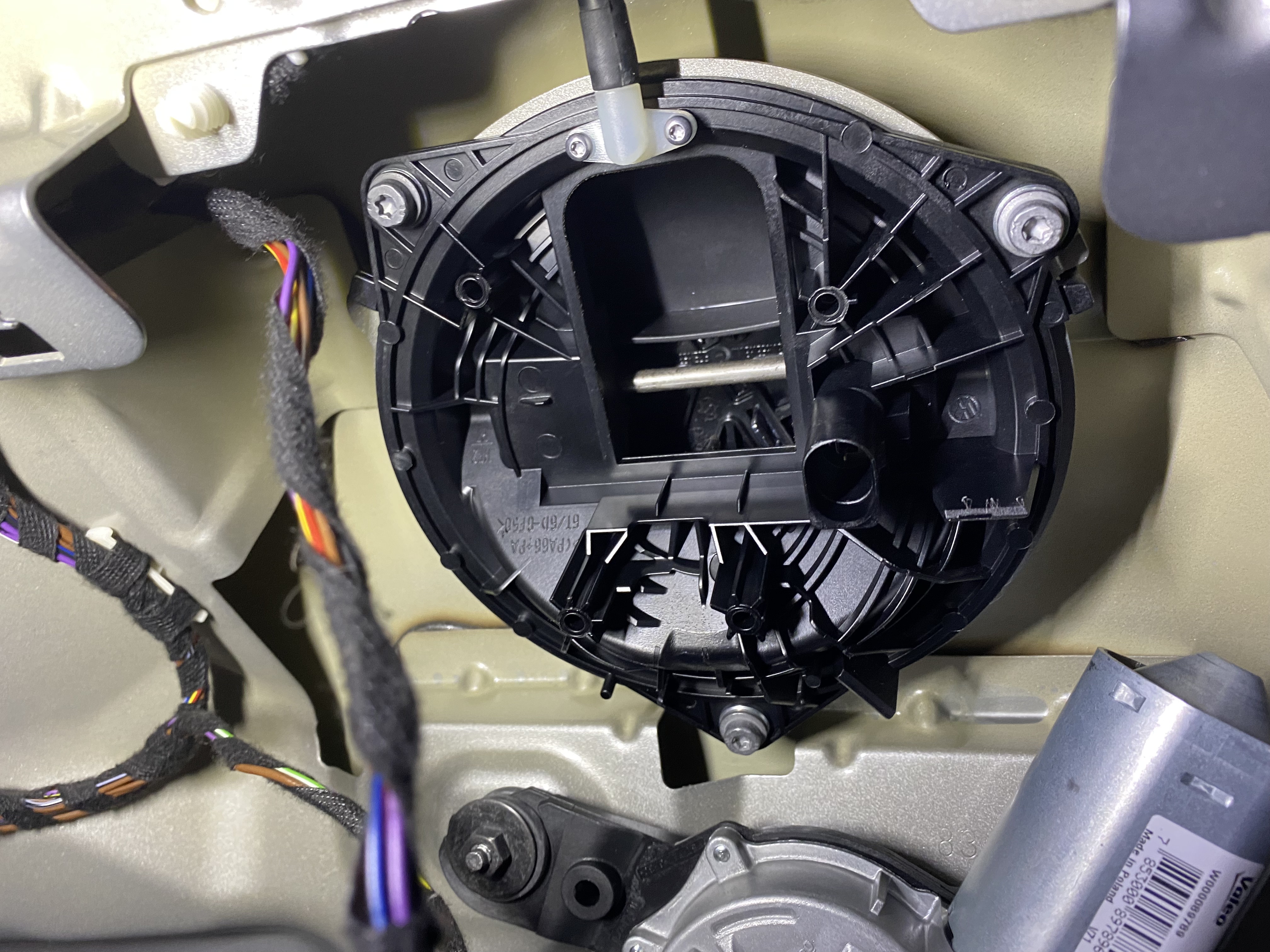

After that I began to disassemble the mechanism where the camera is housed and finally I got it. There are still steps to be done. I put some photos of the process so far.

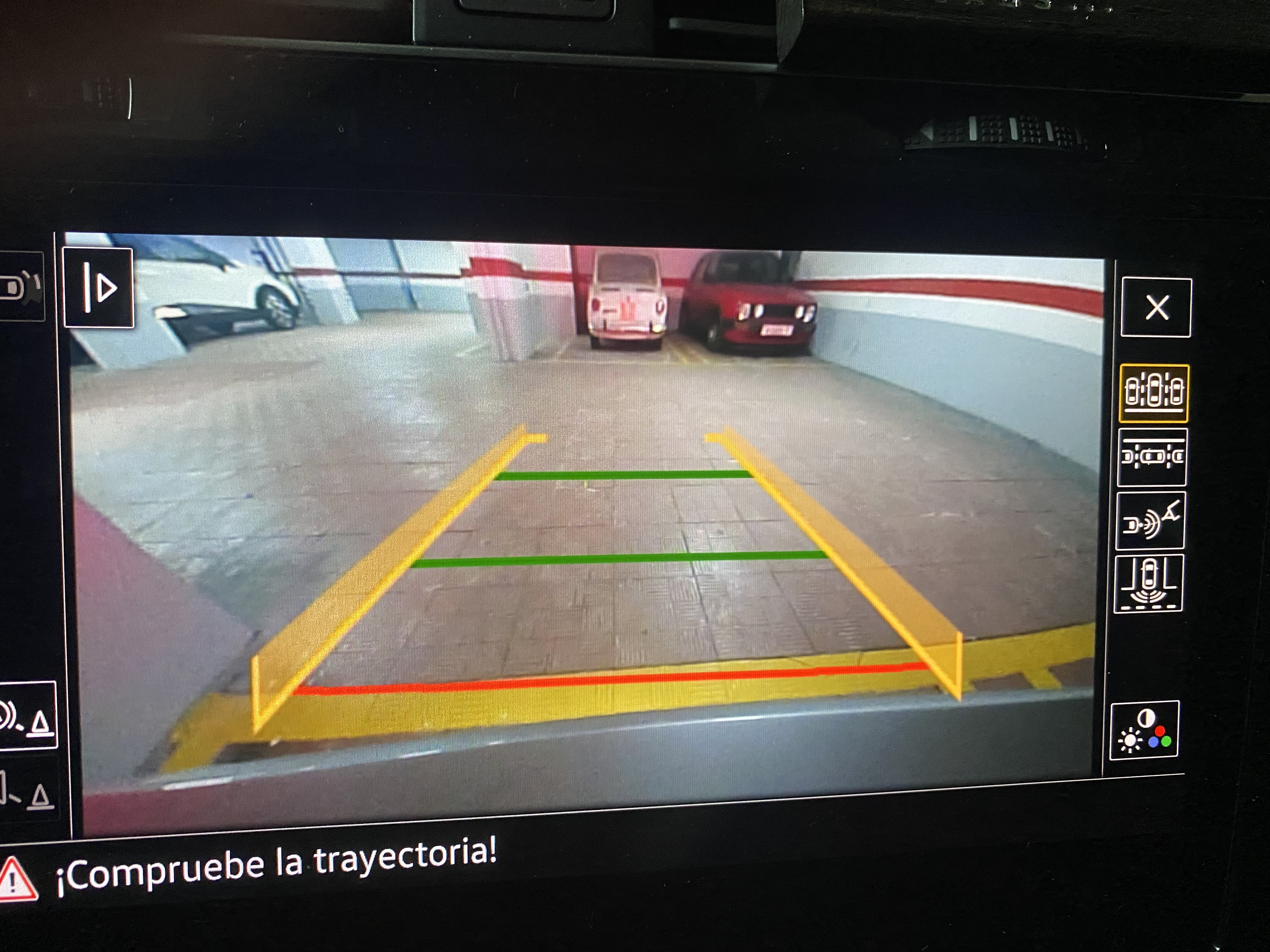

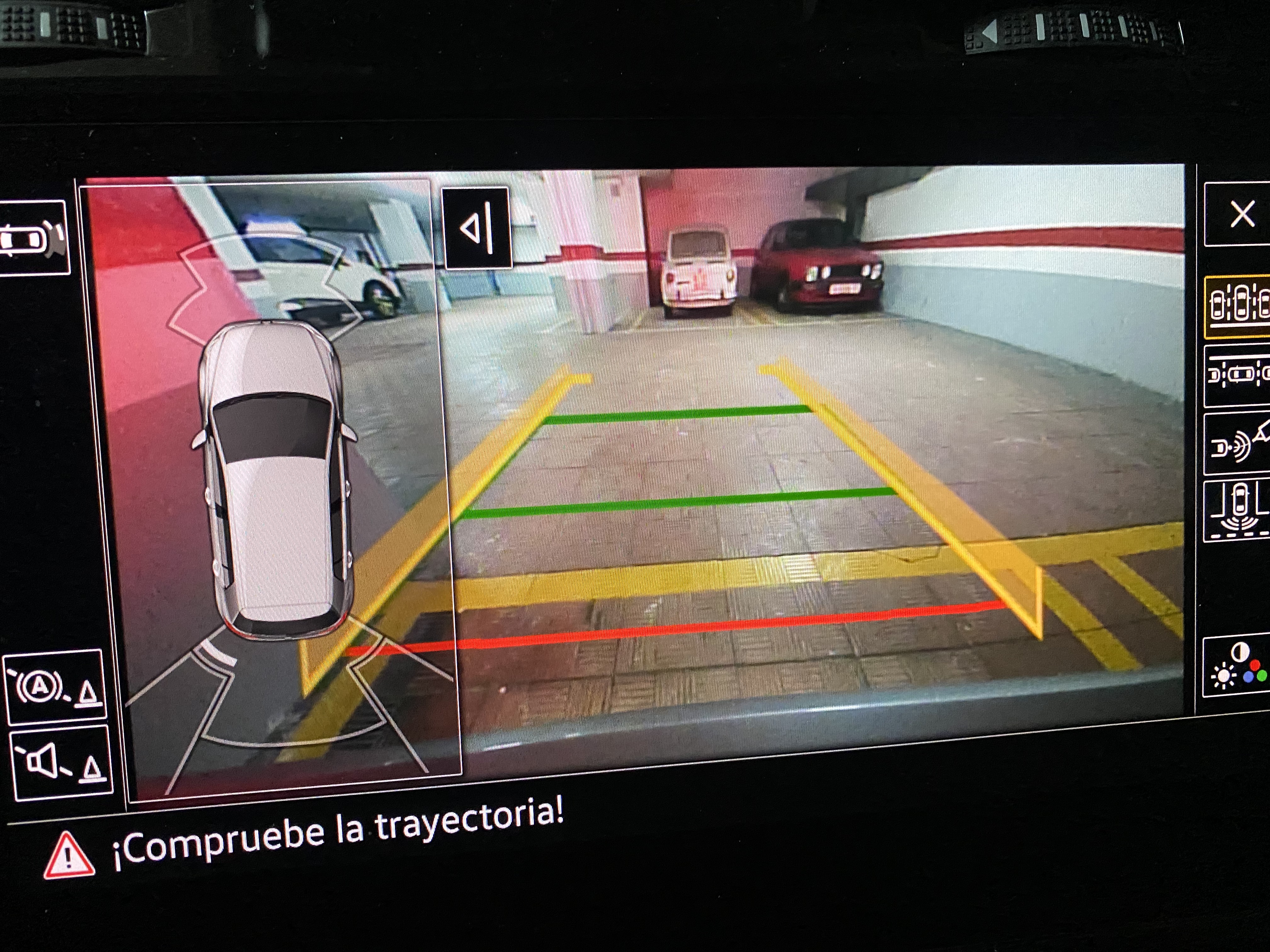

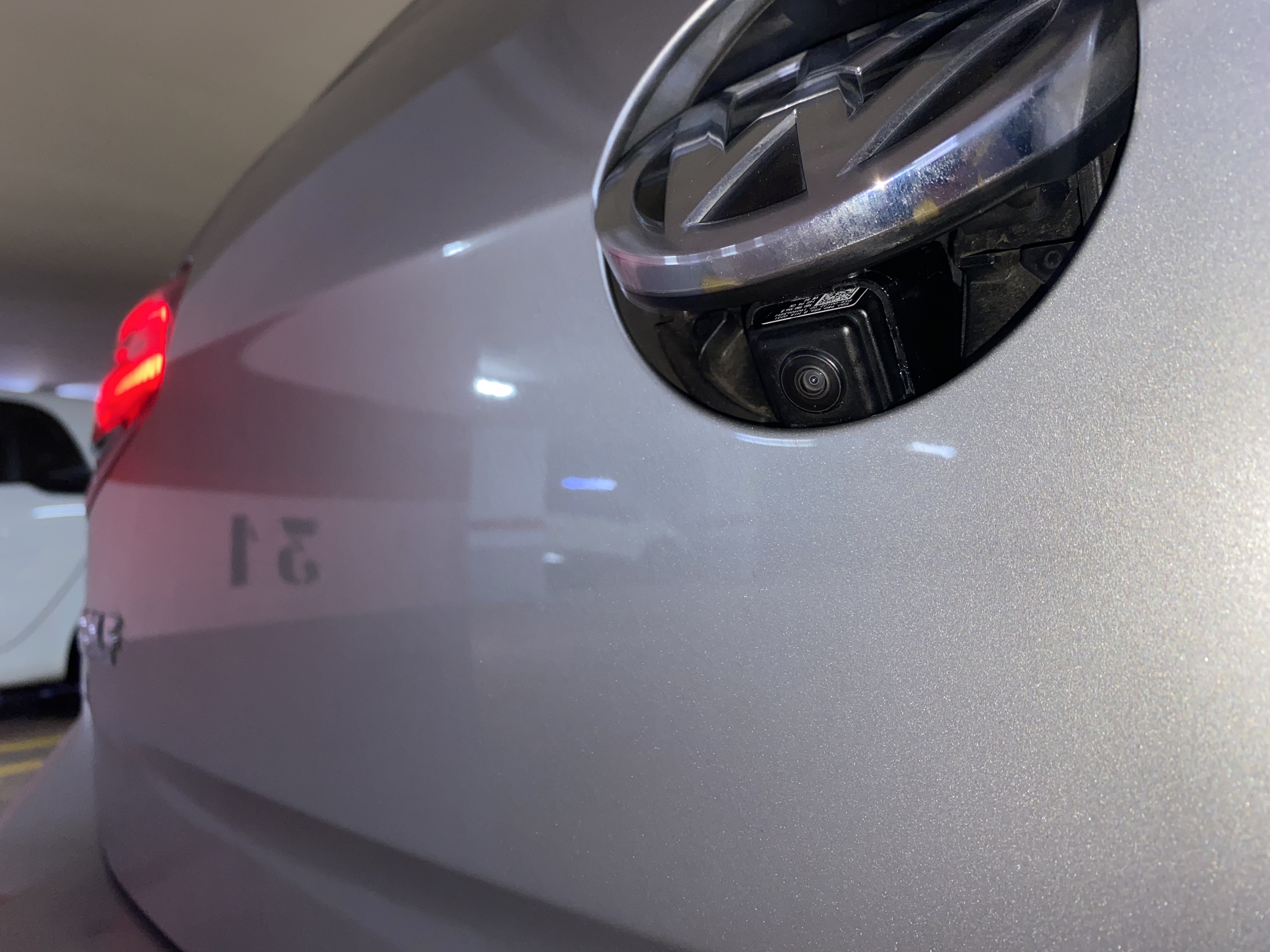

Hello everybody.
Today I finished the installation of the camera in the emblem mechanism of Golf. This are some photos of the work done.
- E5B8DEDC-59BF-4CB9-BD94-FE9DC718278D.jpeg (4.01 MiB) Viewed 19353 times
- 34AE3159-1152-4CF0-8856-BA23315E265C.jpeg (3.63 MiB) Viewed 19353 times
- 40435A72-4D7D-418A-97CC-EEB053EBAF10.jpeg (3.29 MiB) Viewed 19353 times
- Posts: 8974
Re: From Stock Golf 7.5 to….
Now you can also enjoy that little help/program for parallel parking. Read the owner's manual if you have questions about how it works.
My wife likes this RVC parking assist more than the steering assist parking PLA 3.0, I on the contrary prefer to park without hands, if there was a world championship I would have the absolute record in the shortest time to do it ...
By the way, what method did you use to perform the calibration of the RVC H?
Someone (vw) one day will have to give us explanations why the quality of the image is so shabby (it is not in line with the 21st century), putting so much effort into protecting this SW s**t is even hilarious.

Hello Fernando.

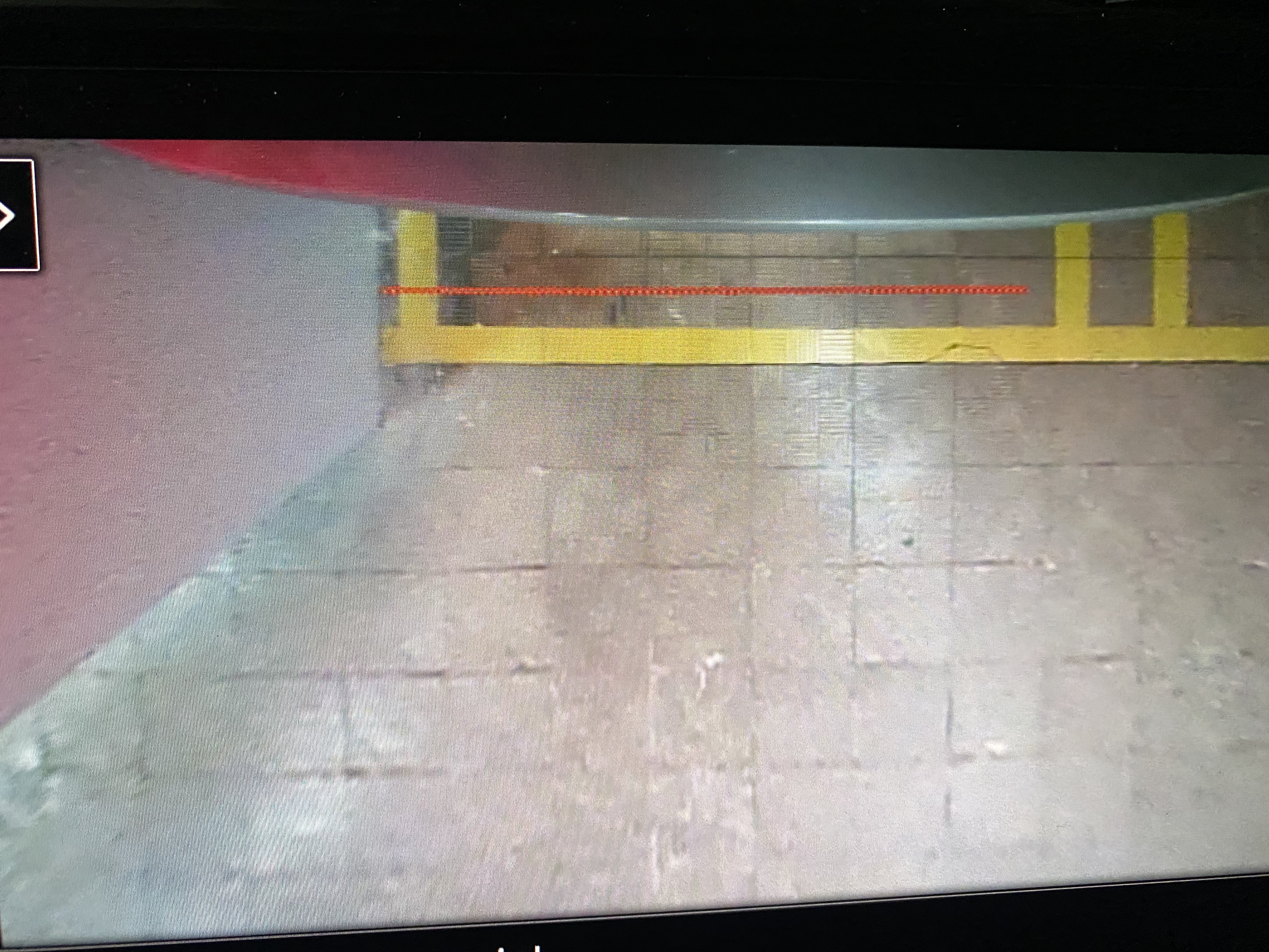

I am thinking to increase angle of the camera. It is low for my taste. I haven't calibrated it yet.
Today I picked up the domino panel. I think do it in next days.

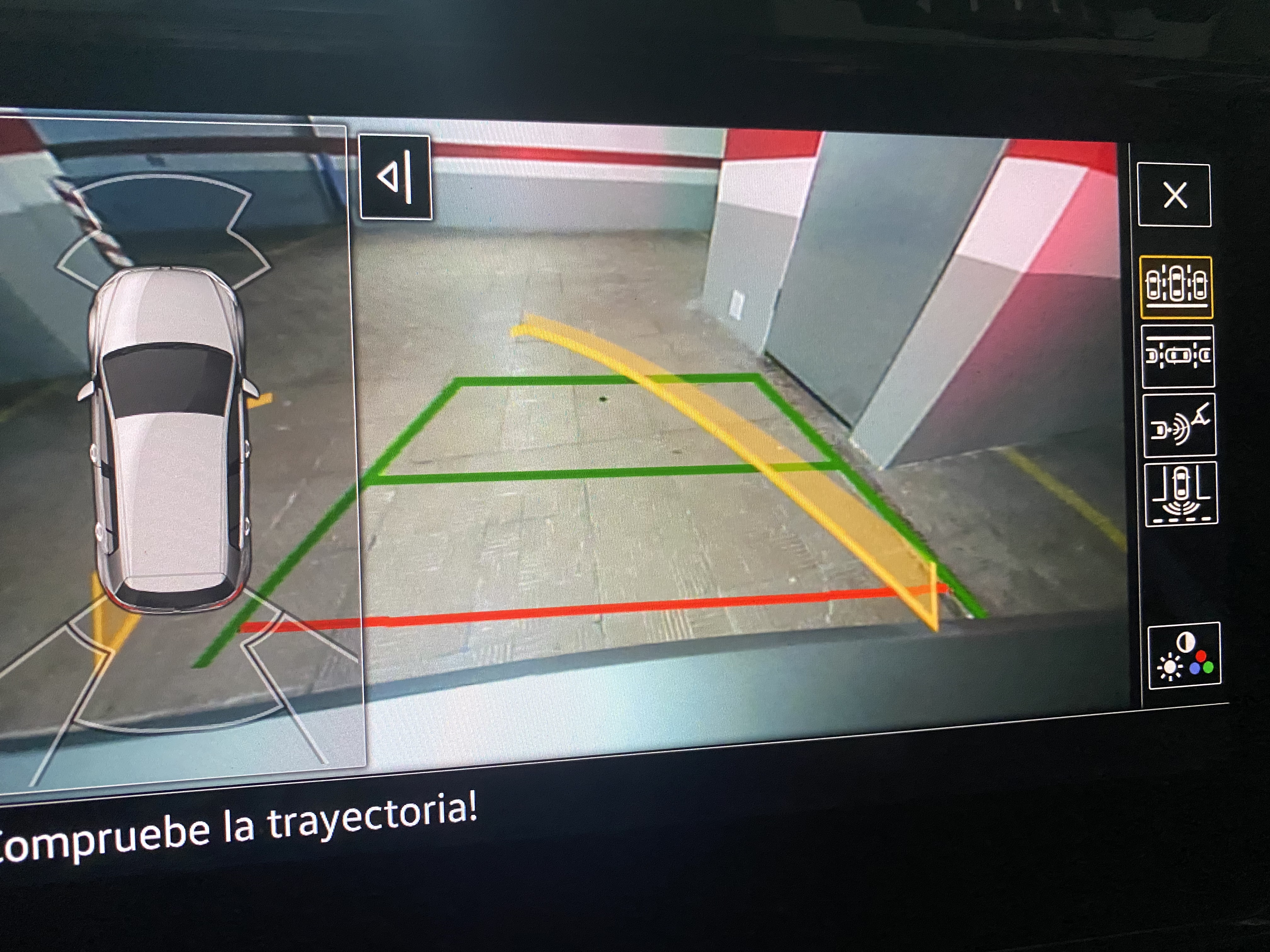

Compare my photo in my garage (the red line is more near to my bumper) with a photo of your video in YouTube.

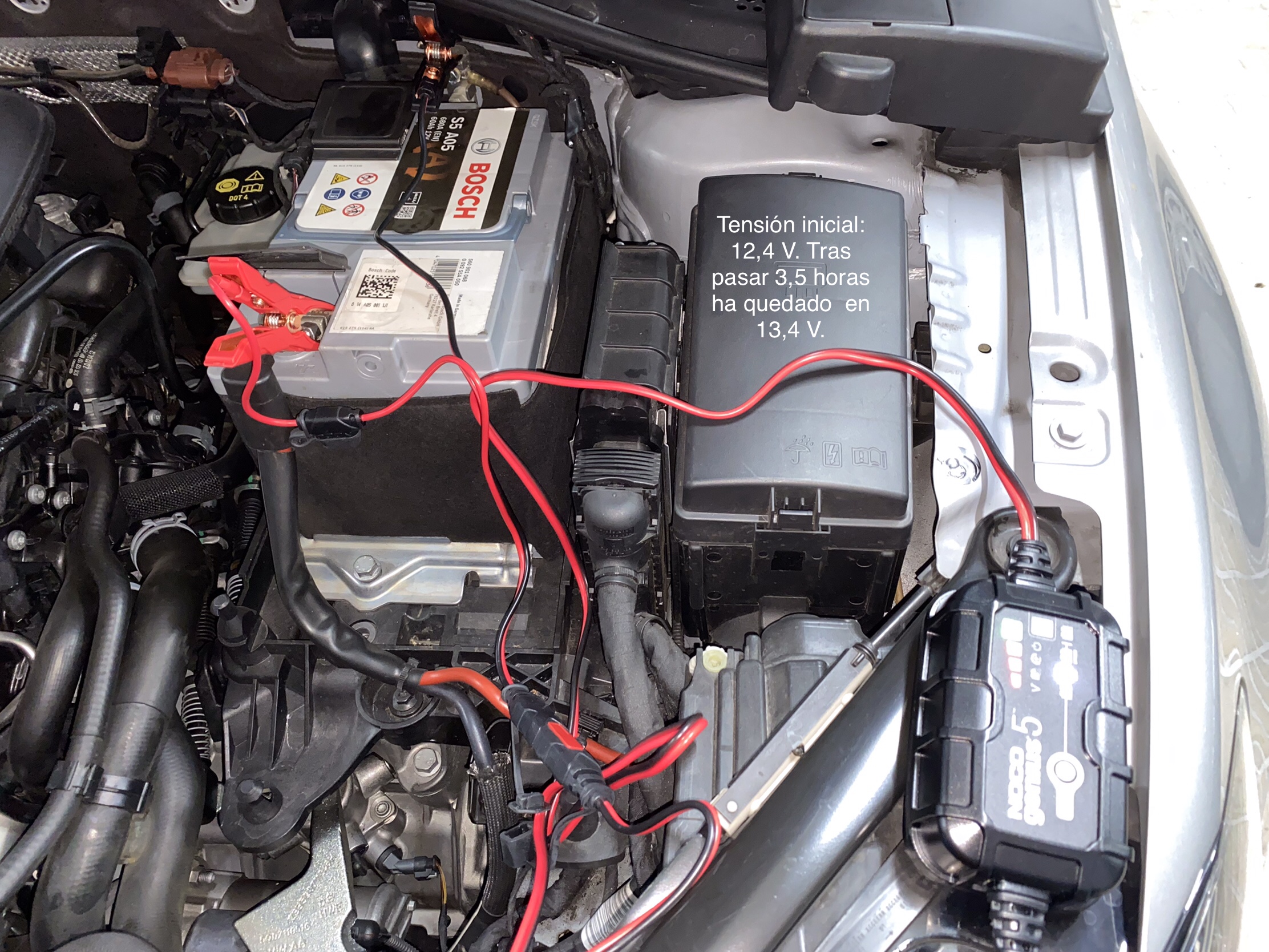

Another project. The battery charger is very recommended…..

Yes, for long diagnostic processes.

Rear view camera repositioned……

Hello Fernando.

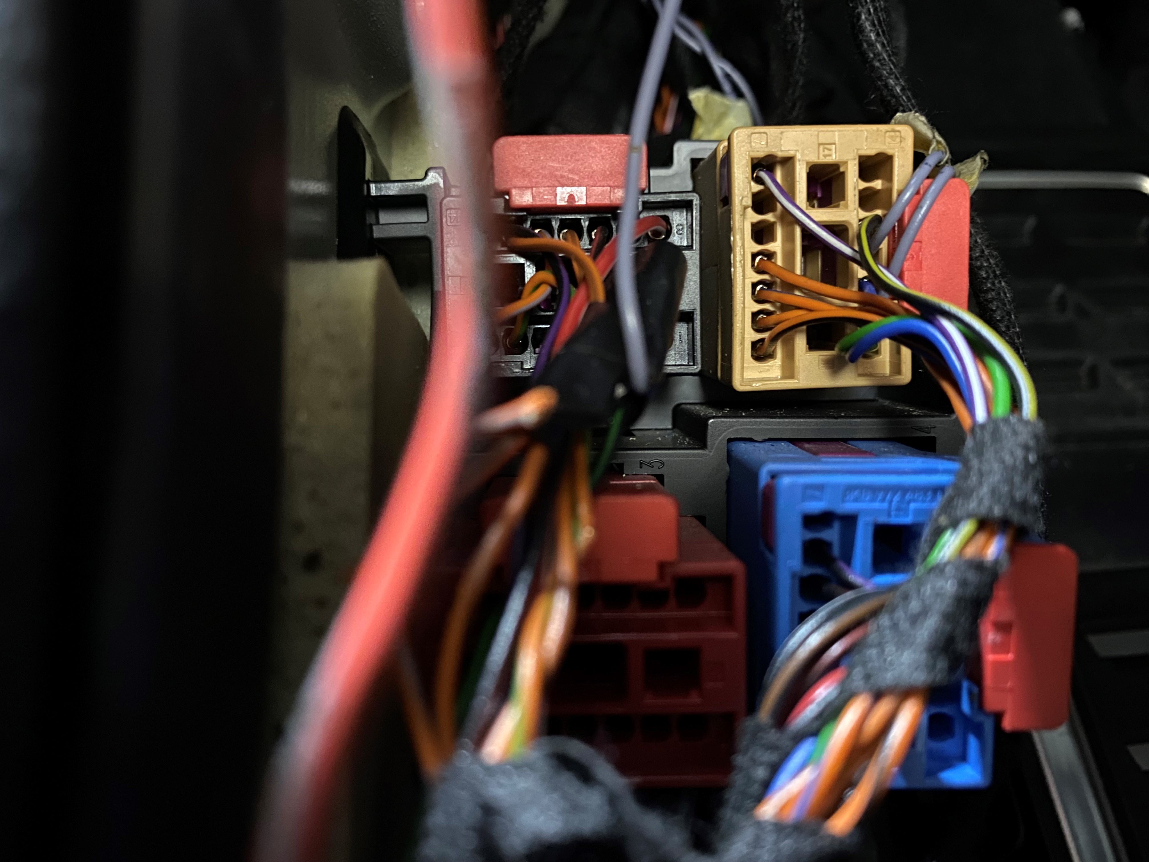

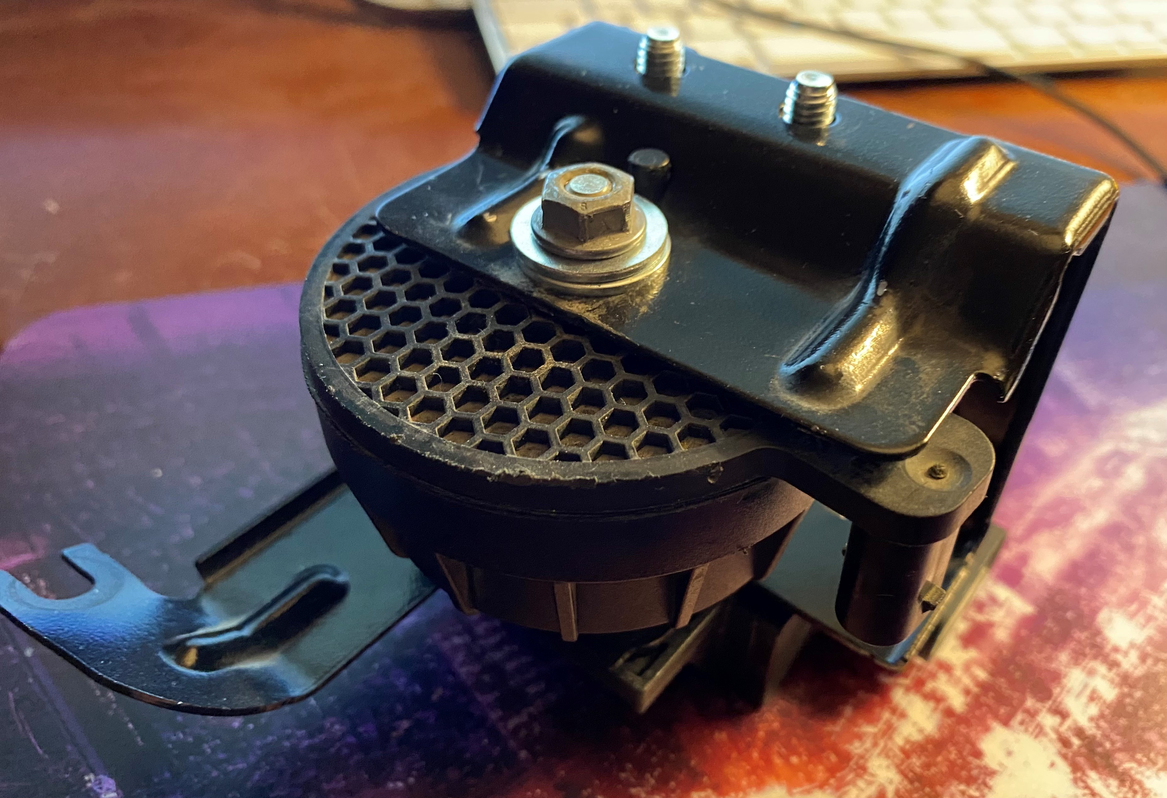

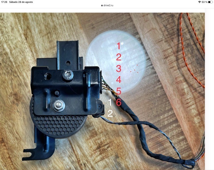

I would like start the project of the Soundaktor, after having seen your video and post about this.
Can you tell me if the wiring order is correct, like i marked in the photo?
Pin 1 red to pin 1 white speaker
Pin 2 red to pin 2 white speaker
Pin 3 red is Positive to SC34 7,5A
Pin 4 red is Mass.
Pin 5 red is CAN Low. To pin 2 of your picture (two color wire)
Pin 6 red is CAN High. To pin 1 of your picture (black wire)
Pin 4 red is Mass.
- 60rFj51.jpg (335.91 KiB) Viewed 19076 times
- Previo.jpg (128.28 KiB) Viewed 19077 times

Hello Fernando.

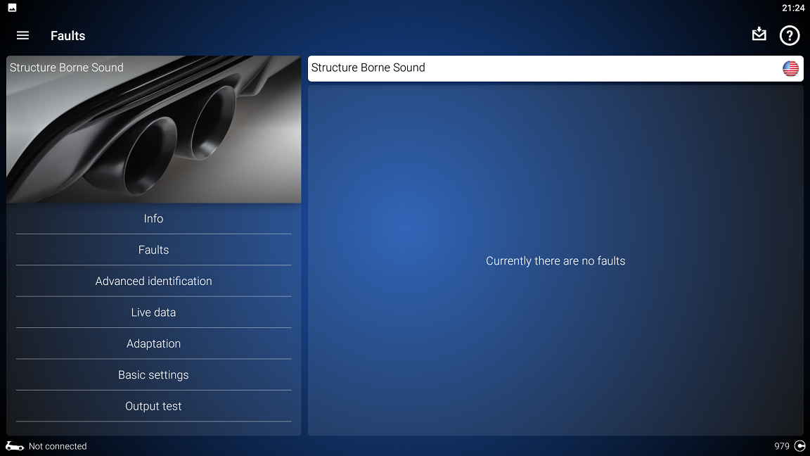

FInally it is operative the Soundaktor in my golf 1.4 TSI. I like the sound into the car.
I also have a K&N air filter installed that enhances the engine sound even more.
I really like the adaptation and the end result.
Many thanks to Squader for their final punchline with custom firmware for this operational control unit in my car. And, of course, many thanks to you Fernando for your illustrations and my source of inspiration.
A9 Structure Borne Sound
System description: SAS-GEN 2
Software number: 5F0907159
Software version: Z001
Hardware number: 4H0907159A
Hardware version: H07
Serial number: XXXXXXXXXXXXX
ODX name: EV_SoundActuaGen2AU64X
ODX version: 003010
Trouble codes:
No trouble codes found

- Posts: 8974
Cool!! Thanks to you for your report.
It's a useless device, but it's such a nice fantasy that even imaginatively it tickles the foot when you push on the gas pedal.
100% recommended.
100% recommended.
