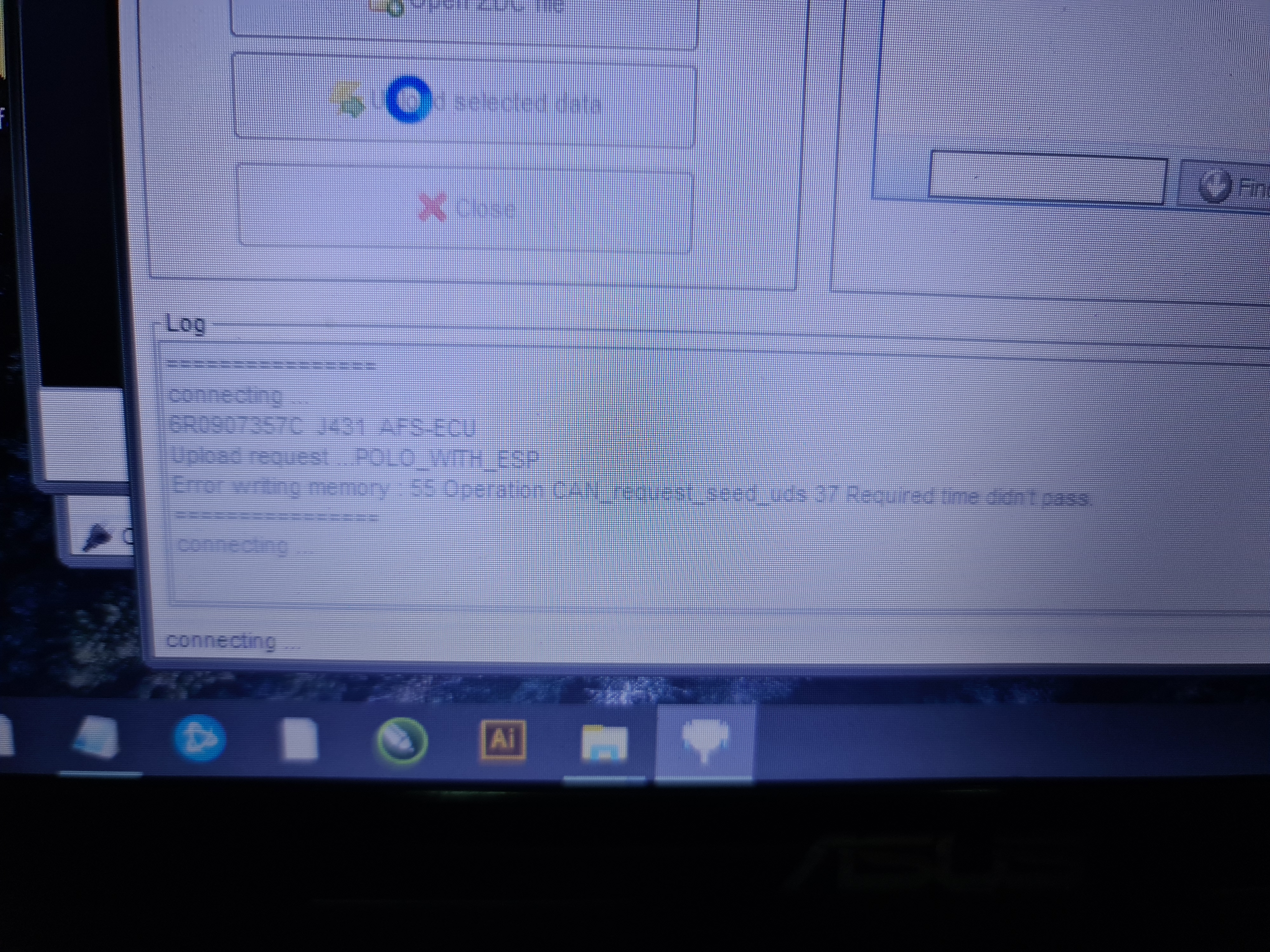

I also tried parameterizing with VCP - again without success ...... :cry:

ZahariGeorgiev wrote: Tue Nov 09, 2021 6:59 pm I also tried parameterizing with VCP - again without success ...... :cry:
I guess you would have to find the appropriate flash file (extremely difficult) to flash your current module and then load the TinyQ parameters,
or a second-hand module for LED headlights.
