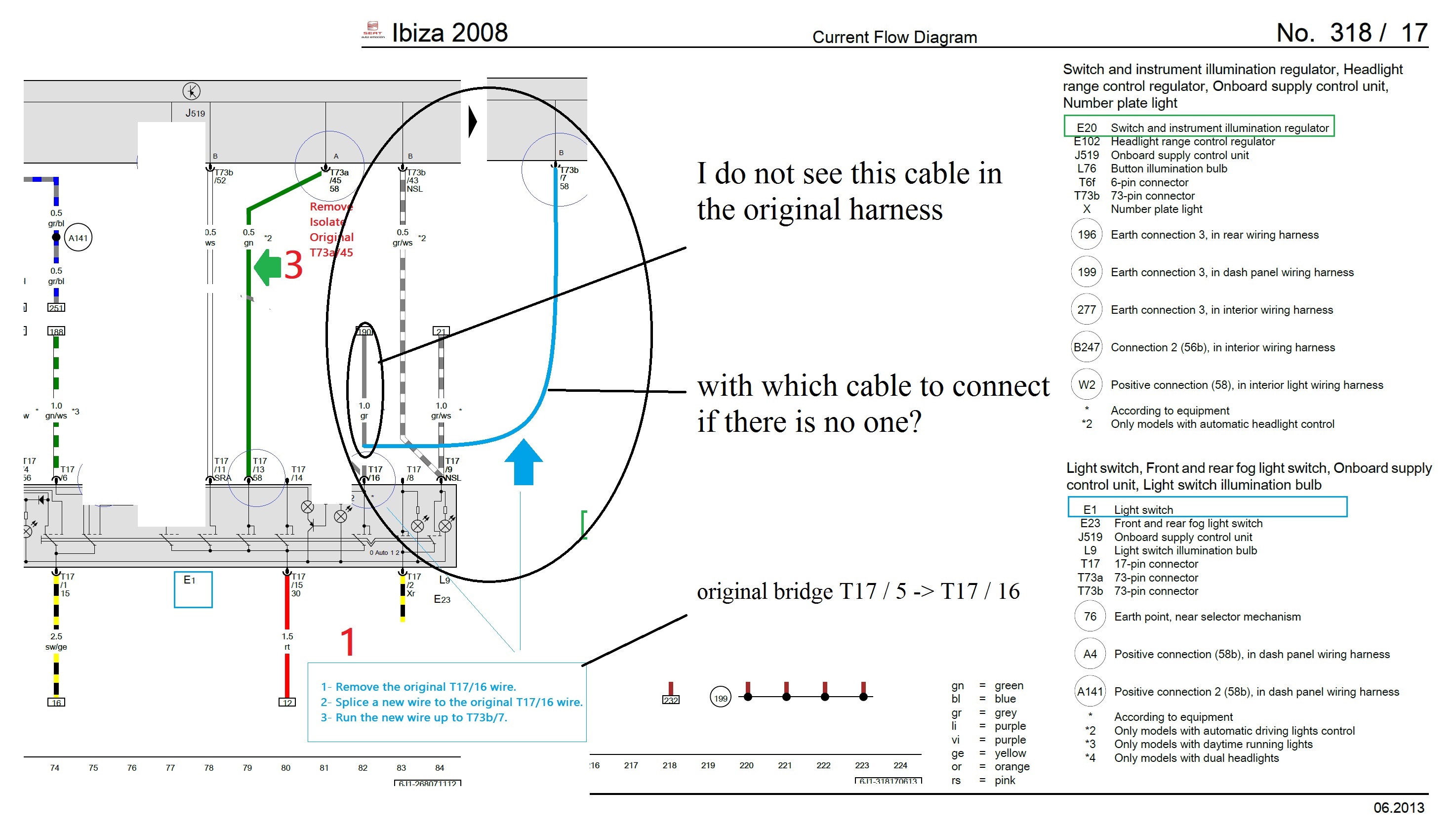

- I do not see this cable in the installation of my car :(
- HzHGkoI.png (469.2 KiB) Viewed 3140 times
- 2.Remove the original T17 / 13 cable and insert the new T73a / 45 <--> T17 / 13 or 1.T73a / 45(new) bridge <--> T17 / 13 (original)

- with which cable to connect if there is no one?
- wqw.jpg (771.67 KiB) Viewed 3128 times
- Oryginal bridge T17/5-->T17/16
- Bez tytułu.jpg (4.49 MiB) Viewed 3128 times

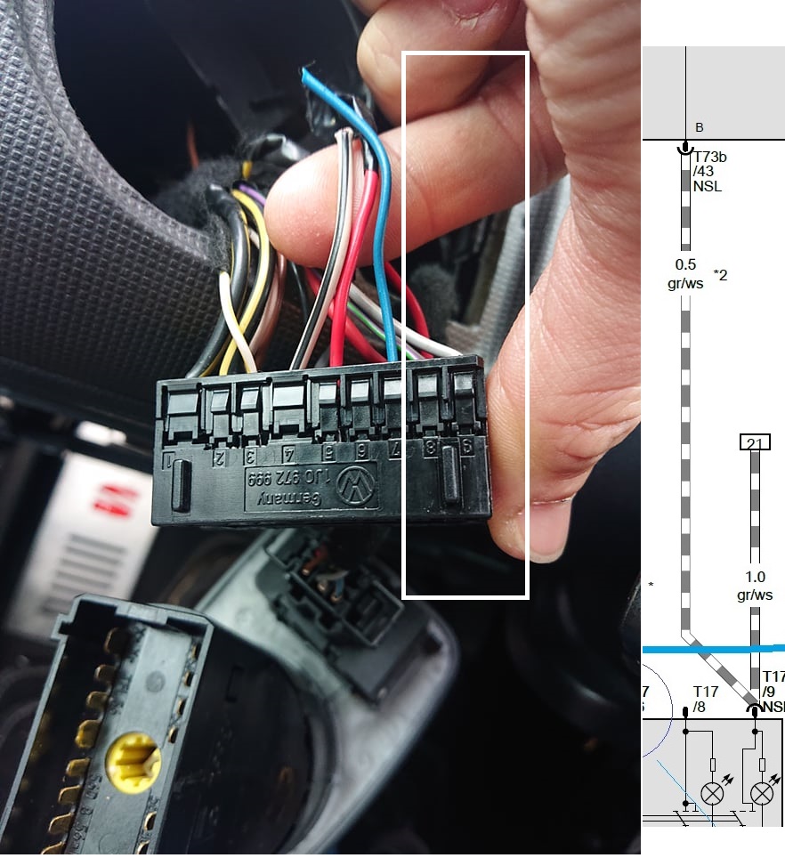

I see another wiring error original purple / green T17 / 8 wire take it out and make a bridge to T17 / 9 right?
I will wait until it gets a little warmer, due to the fact that I do not have a heated garage, I do everything in front of the block, check if there is a cable in the bcm T73b / 43, if there is no cable T73b / 43 to T17 / 9, the bridge with the original cable and the T17 / 8 I will remove and will insulate
after solving these 2 problems, we will move on to the next, hopefully, last wire (problem)
- 257602806_997489914440278_8126509699256973407_n(1).jpg (189.96 KiB) Viewed 3123 times

Well, I have all the erWin diagrams for the Ibiza 6J manufactured in Spain-Barcelona (your Ibiza), and in none of them is it contemplated that the wire from T17/16 to T17/5 is RED color.KamilPL wrote: Thu Nov 18, 2021 6:04 am I took time off on demand and I did not go to work today I hope we will be able to put it together today and check how it works
Since 5,4,2 are ready (OK) let's do -> T73b / 7
The bridge T17/16 -> T17/5
What cabling should I attach the cable to be in the BCM T73b/7, since it is not in the original harness?
viewtopic.php?p=584960#p584960
Taking into account that the diagrams may be wrong because we already have a lot of experience with these diagrams,
Are you completely sure that the RED wire from T17/16 to T17/5 in your Ibiza is an ORIGINAL wire?
I have an alternative solution for T73b/7, but I need your answer to my question.
- Posts: 8989
At no point in this installation is anything said about the T17/8 wire, this wire should not be touched under any circumstances.KamilPL wrote: Thu Nov 18, 2021 6:28 am I see another wiring error original purple / green T17 / 8 wire take it out and make a bridge to T17 / 9 right?
This green/purple wire should remain intact, as it is from the factory. It is the activation signal for front fog lights.

Ok, I don't touch it.ciclo wrote: Thu Nov 18, 2021 8:29 amAt no point in this installation is anything said about the T17/8 wire, this wire should not be touched under any circumstances.KamilPL wrote: Thu Nov 18, 2021 6:28 am I see another wiring error original purple / green T17 / 8 wire take it out and make a bridge to T17 / 9 right?
First let's do the T73b / 7, then let's do the T73a / 45 -> T17 / 13
- Posts: 8989
Alternative solution:KamilPL wrote: Thu Nov 18, 2021 8:36 amciclo wrote: Thu Nov 18, 2021 7:59 amWell, I have all the erWin diagrams for the Ibiza 6J manufactured in Spain-Barcelona (your Ibiza), and in none of them is it contemplated that the wire from T17/16 to T17/5 is RED color.KamilPL wrote: Thu Nov 18, 2021 6:04 am I took time off on demand and I did not go to work today I hope we will be able to put it together today and check how it works
I do not know if this was the case in the original, I only have a photo from August 15, when I started to do with the car: P maybe the electrician added this bridge 17/5 -> 17/16 as he added front fog lamps
I'm going to the car soon, it will tear off the original insulation and check if the cable is still there, but I think it is not there
T73b/7 is the supply signal for the license plate lights.
From the Dimmer an original wire was removed and isolated, the T6/3 wire (according my diagram for this installation).
Take this T6/3 isolated wire, strip the insulation, splice a new 0.5mm2 wire to this wire, and run the other end to T73b/7.
