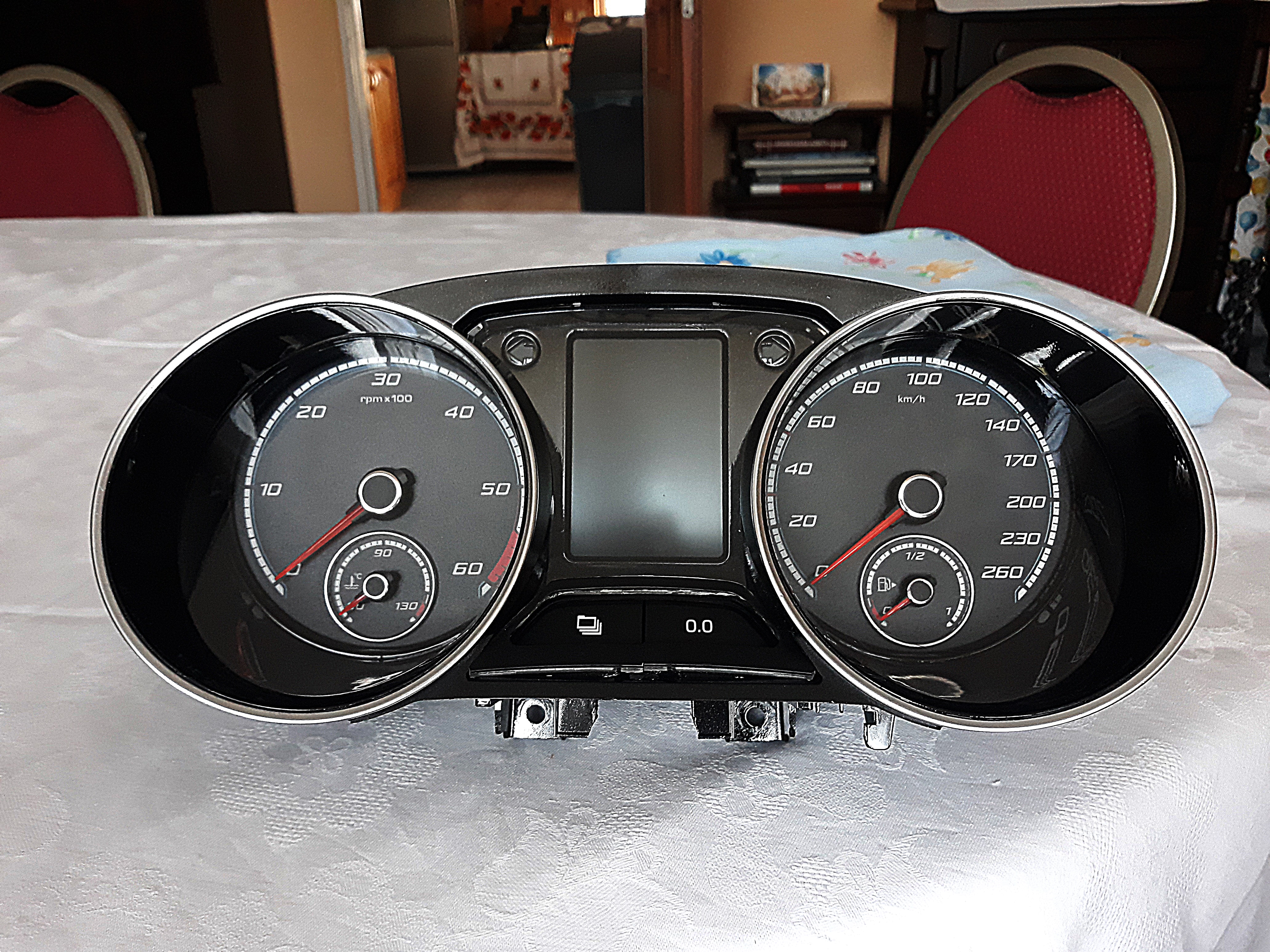

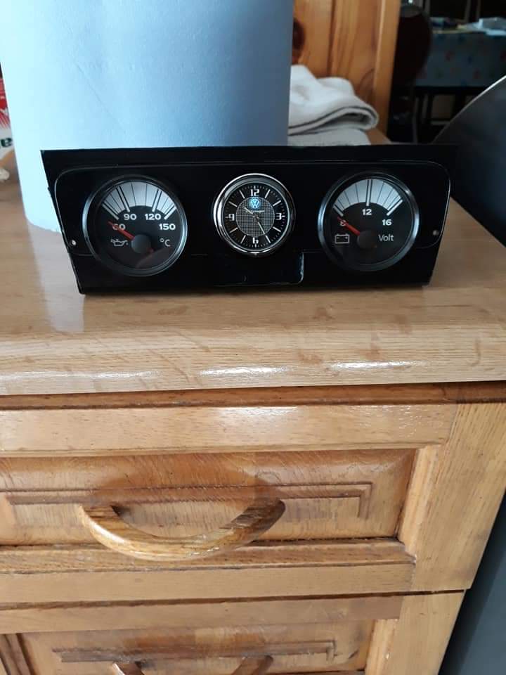

Iichel super mod :) !!! I came up with something like this out of sentiment. Extra clocks from my former car (ibiza 6k2fl sport). Not connected yet and I don't even know if they will work :mrgreen:

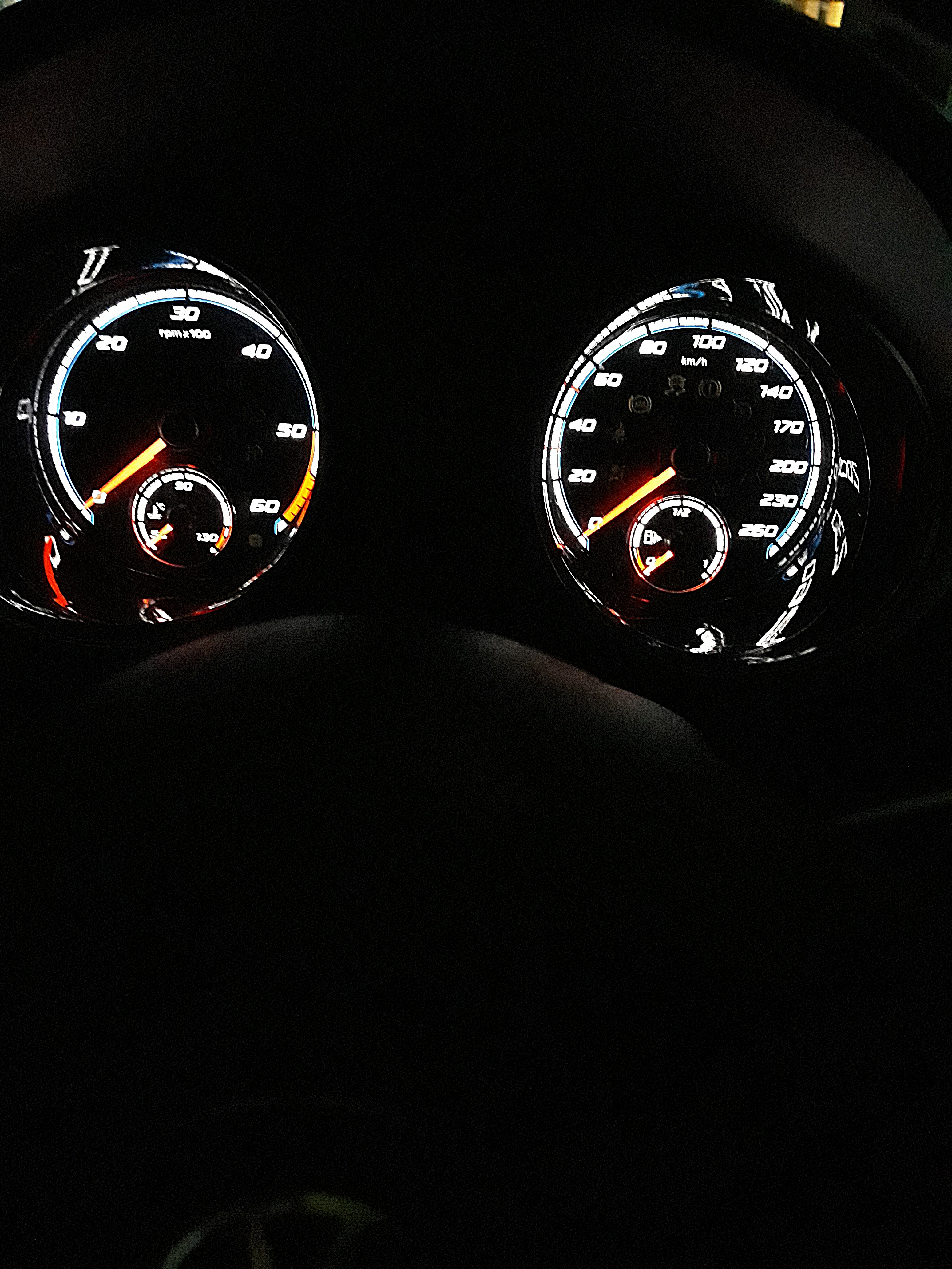

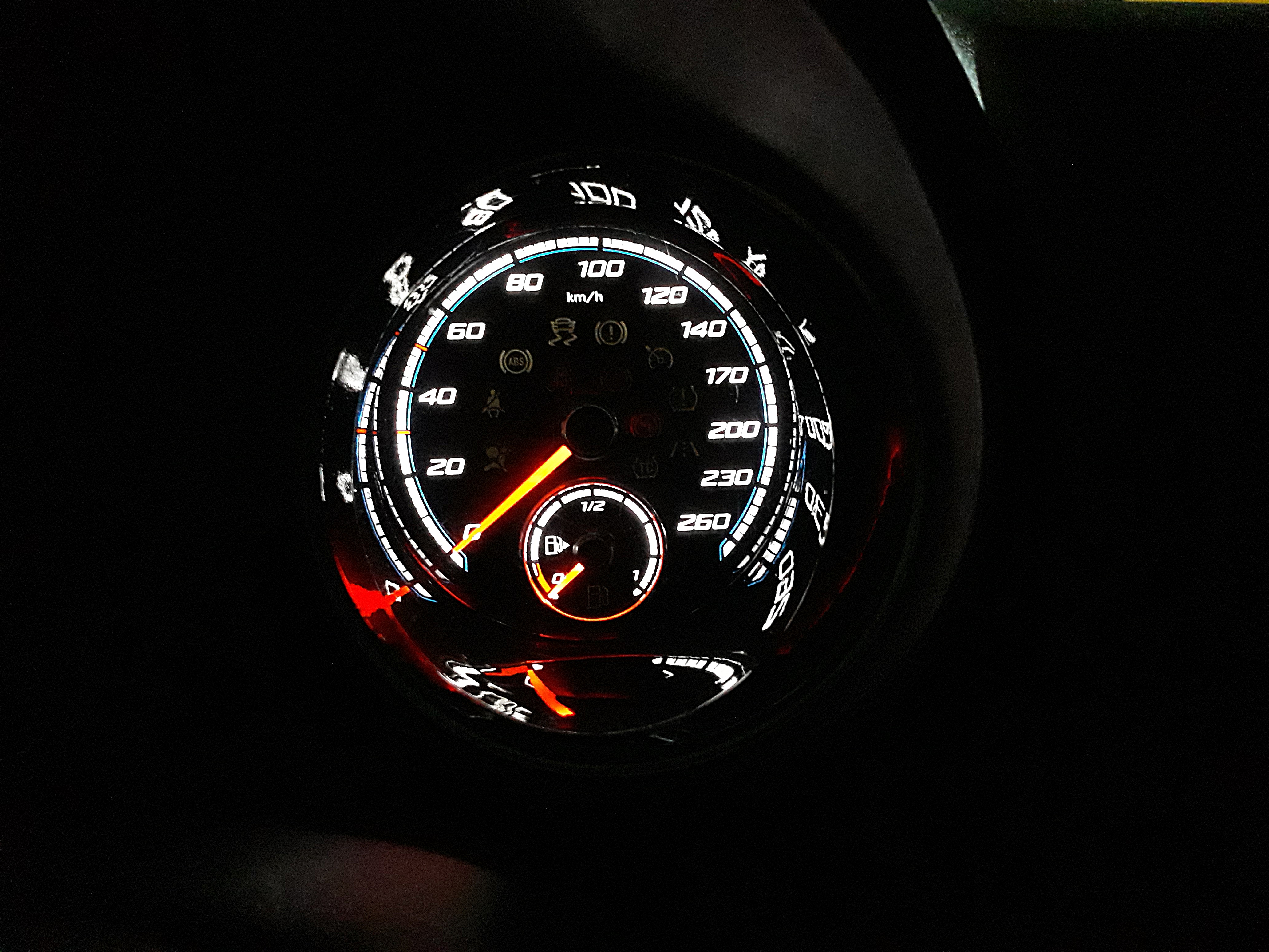

Someone wanted a GTI cluster with 240 km/h speedo, so I decided to put the left ofer tacho disc to good use... :)
+ VDO editor

iichel wrote: Mon Nov 22, 2021 4:15 pm Someone wanted a GTI cluster with 240 km/h speedo, so I decided to put the left ofer tacho disc to good use... :)
+ VDO editor
Did you follow a tutorial somewhere for this? I need to do the same thing and swap the plates out from mph to kph.
Re: iichels Polo 6R 1.6TDI DSG Bluemotion --> OEM++ R-Line conversion
Kr1s wrote: Wed Nov 24, 2021 8:03 am
No, I used the VDO editor software to adjust the eeprom and just swapped the dials.

Thank you. What adapter did you use to connect it to the laptop there?
I opened the cluster, read the eeprom with CH341A + eeprom clip
