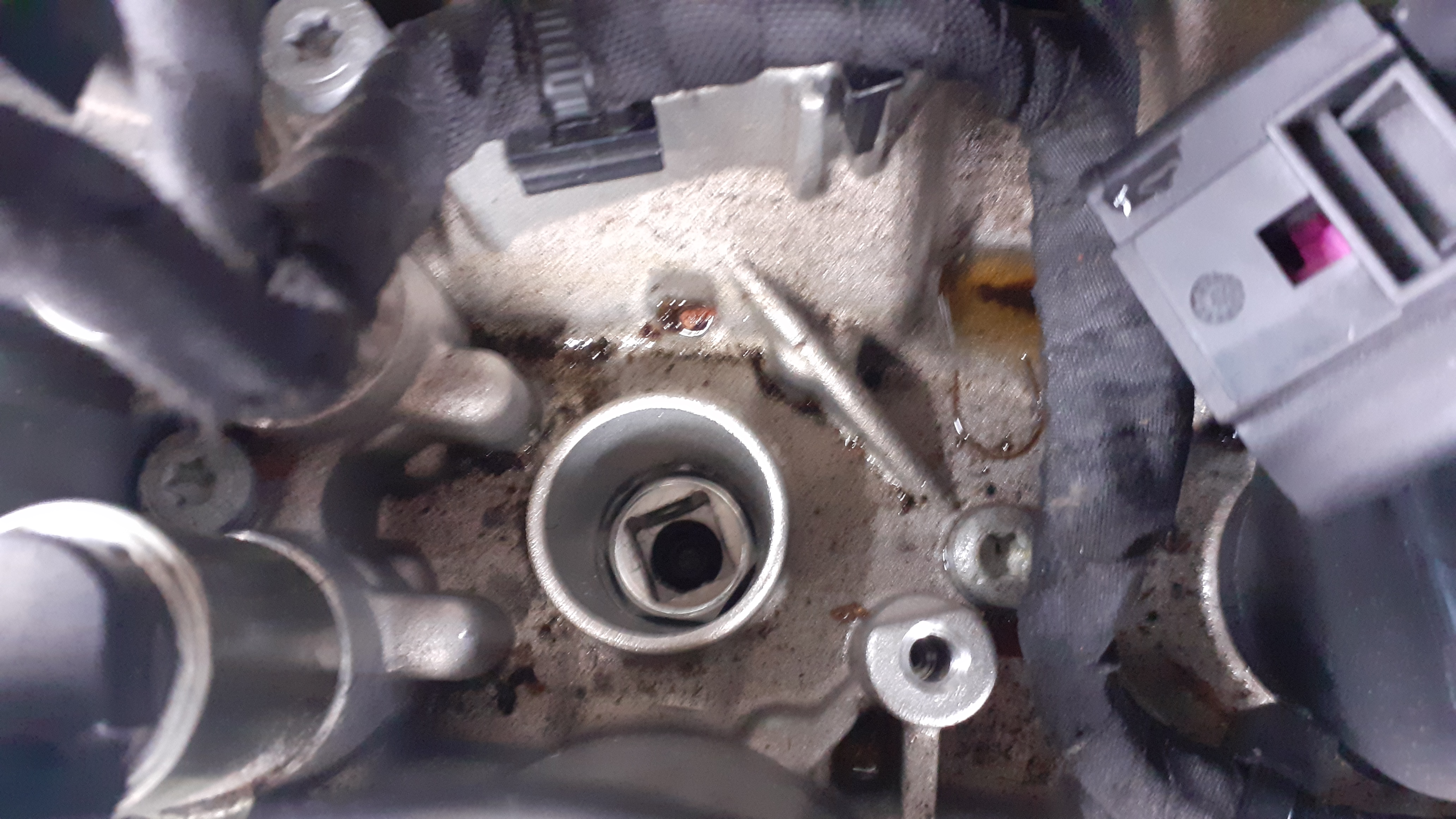

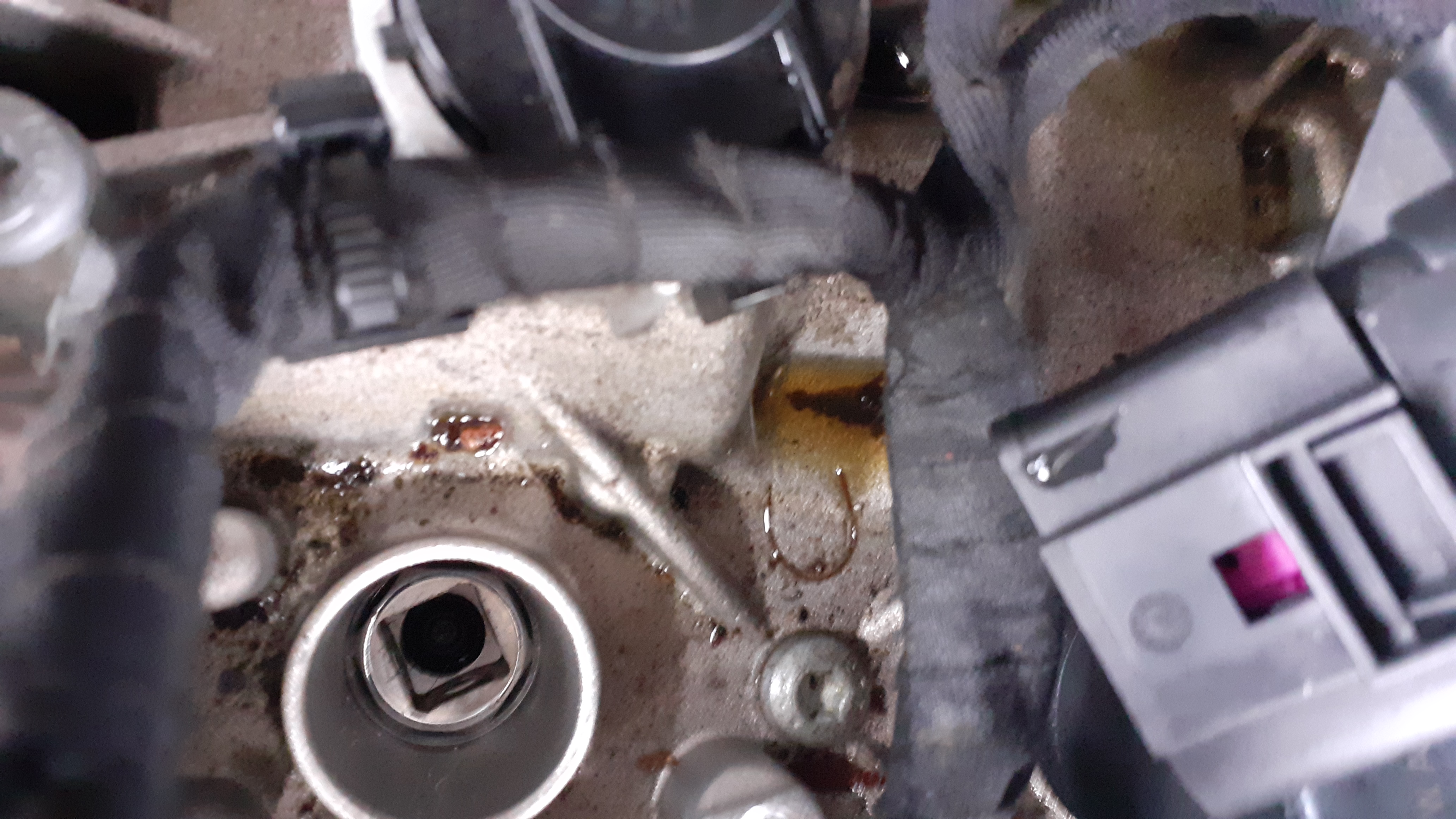

Was servicing my 64 plate Blue GT at the weekend, oil, filters plugs etc. All going well until the last job which was to change the spark plugs. Removed the 1st coil pack and put the spark plug socket on the end of and extension bar down the hole, it went down the hole fine and slipped onto the spark plug. Started turning, initially quite stiff but loosened off ok, then stiffened up again. Tried taking the socket out the hole to see what progress was made but it was jammed tight.
Anyone encountered this problem before and have a solution to the problem. Car is obviously immobile while in this state so taking it to a mechanic is out of the question. what cant be seen in the pictures is the top of the spark plug is in the hole of the socket so unable to get anything like a hook etc in there.

Ouch, I think that you can buy extensions that have a lock so that it still stay part of the plug socket.
After working it around to retrieve it, I'd be measuring your plug socket and buying a slightly smaller diameter one.
Edit:- it looks like that plug socket has an external hex pattern on it - that is okay for "out in the open" plug removal, but no good for "down a bore" plug removal, which all DI petrol engines have.
Make sure your next plug socket has a smooth outer surface.
Current answer might be to try to refit that plug fully then leave this job until you buy a proper plug socket, Laser Tools sell very good slim long plug sockets that don't need an extension, so none of these problems.

Thanks for the reply, think your right on the hex part. Never had the problem before, used it on my old 20valve turbo engine which had a long tube like the current engine and 16 valve engines but I think I may have to get a professional to look at this one.
