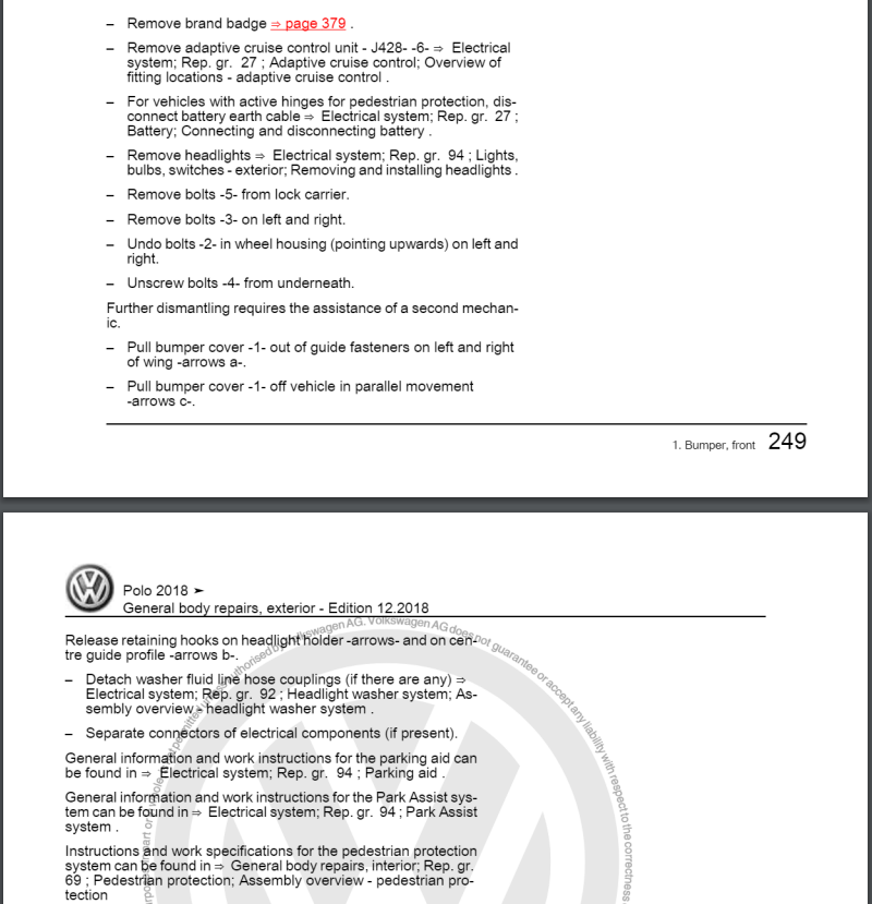

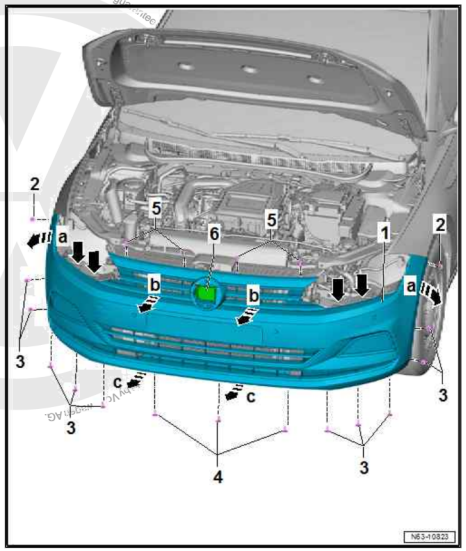

I might be wrong but it looks like it have to be taken out with whole front bumper then it can be changed
//here is link for other VW manuals viewtopic.php?p=574763#p574763 :)

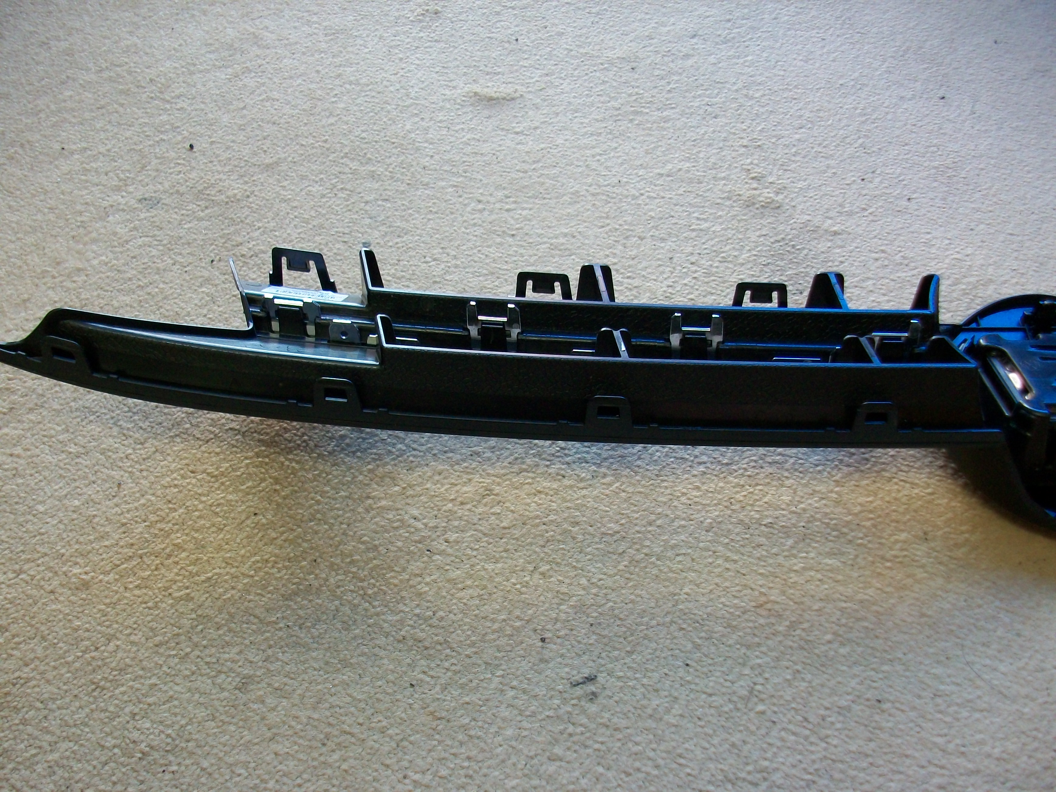

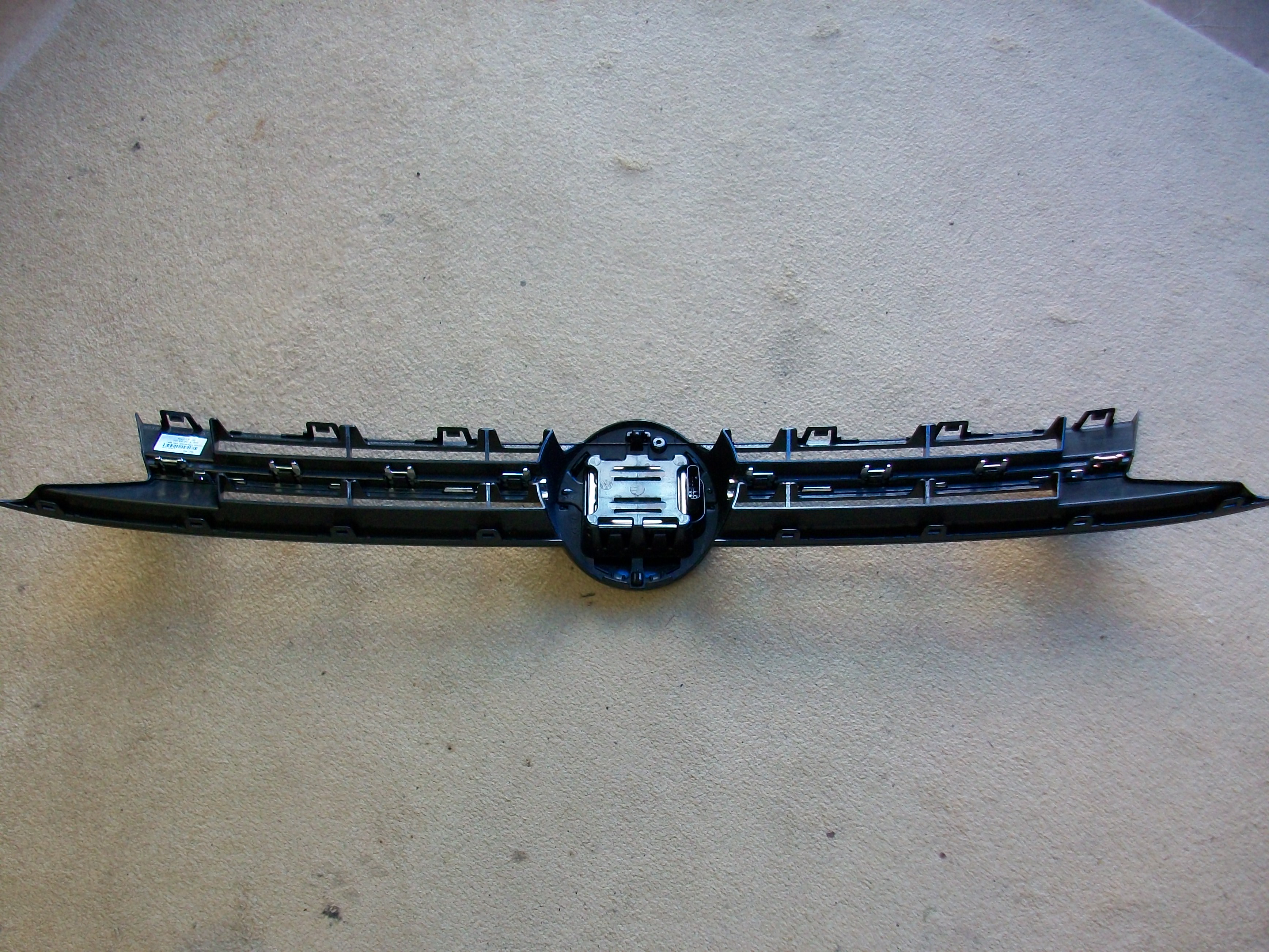

Hello magikzzta, the screws you see are to hold the top part of the front bumper on (the coloured strip is part of the front bumper), but the grille you want to change is just clipped in at the top and bottom, they're quite tricky to remove, but you can get to the back of most of them to release them, the others will release with a slight pull.
Here is a picture of the back of a grill to show the location of the clips, the ones in the middle are to hold the red strip in place, you only need to release the top and bottom ones.
POLO grille 3.JPG (2.06 MiB) Viewed 5351 times
POLO grille 4.JPG (2.07 MiB) Viewed 5351 times
