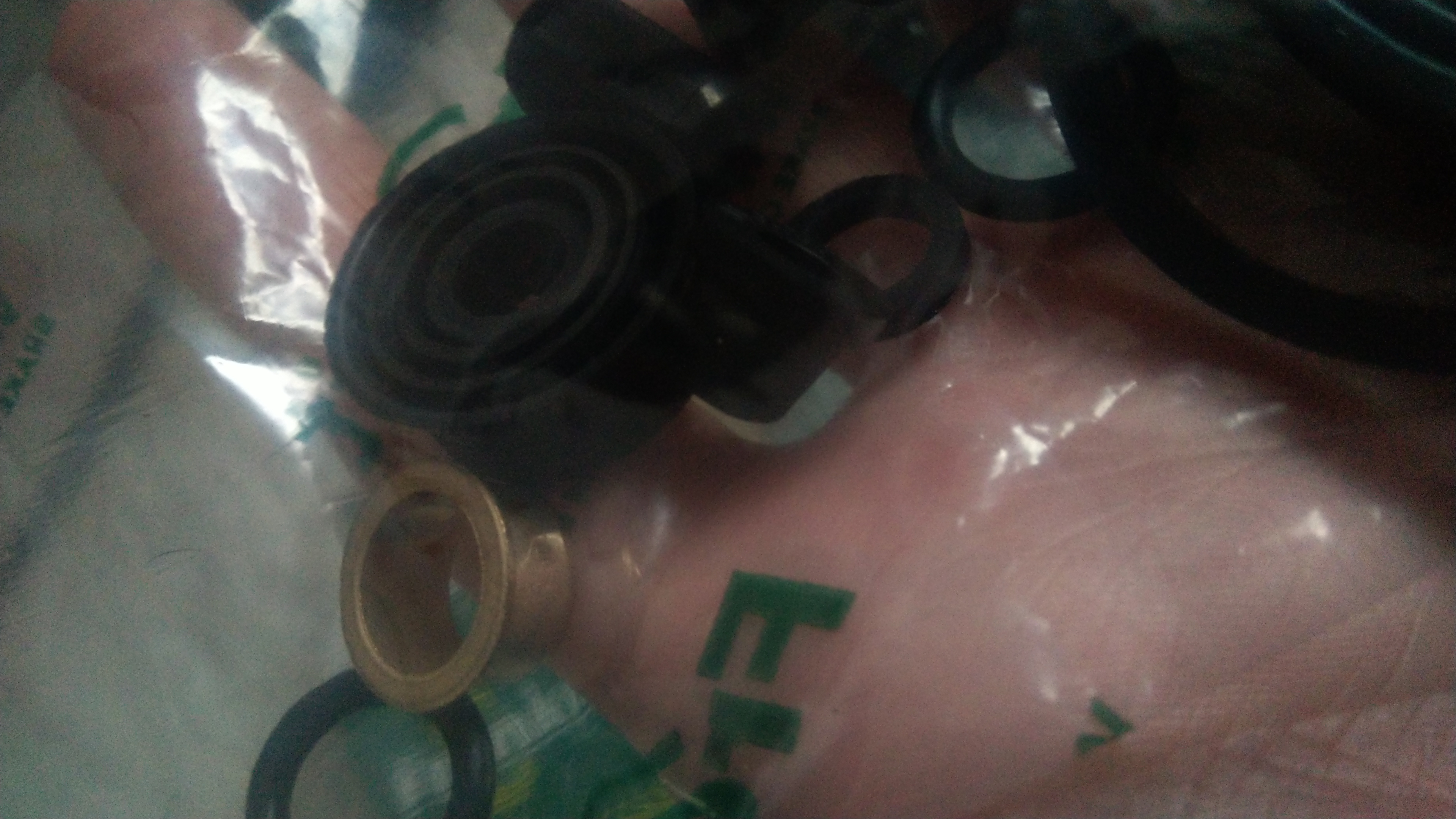

I've bought a rear caliper rebuild kit with pistons. Some kits come with brass bushing, and some kits do not come. Does someone where does this brass part goes?
Edit, I have confirmed my thougts.

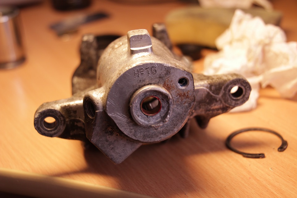

just buy new callipers, the circlip that holds the parking brake mechanism is a nightmare to install and remove.
also, do not wire brush the part where the bajno golt goes. Do not or it will leak. I will try today to sand it flush and try it that way. If it doesnt work hoses and new callipers 😠.
the first calliper was a nightmare it took me 2h for the circlip.
The second one i dismanteld in 15 minutes, but guess what the piston wouldnt wind in witouth force from the top. So again i dismanteld it 8 times to re check everything. And i managed to slide the piston in and it was pushing out slowly applying the handbrake mechanisam. the issue was that circlip.
It took me 8 bloody hrs for 2 callipers, and i think my steel wire wheel strached the part where thencrush washer goes. So i got a leak thanks god for pressure bleeder.
really bad desing the shaft from behind was completly rusted, and water gets in from thenbackside. Nice money maker desing.
If i was to do it again id just buy new callipers.
