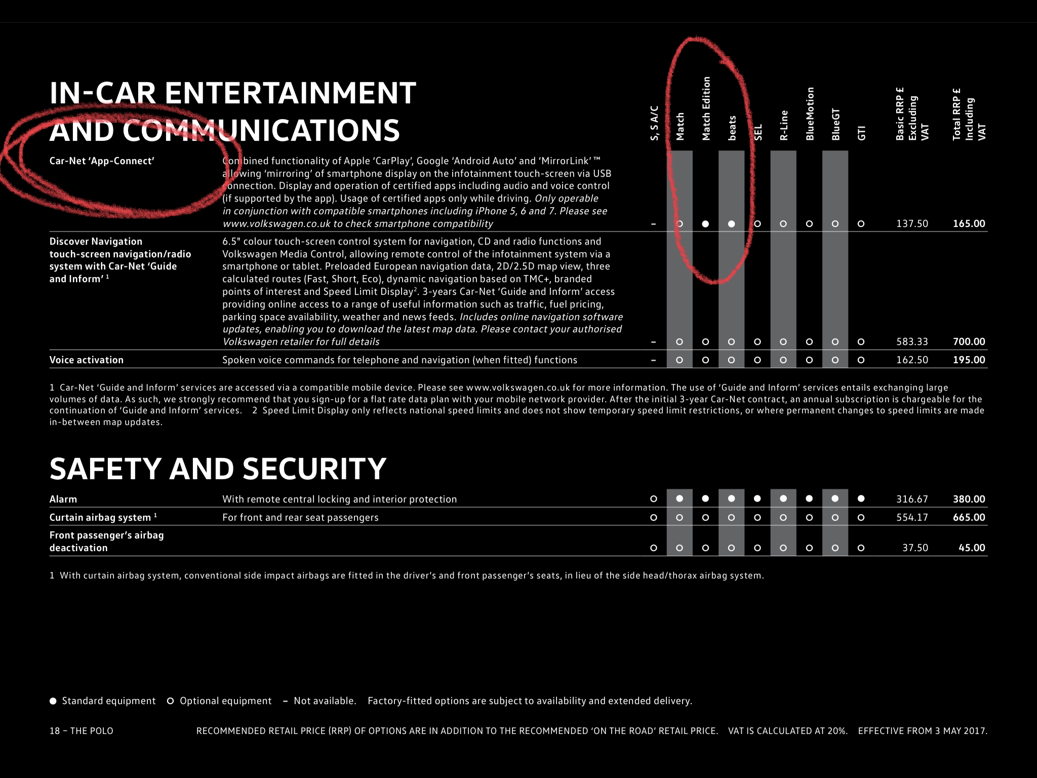

There were two different infotainment units used in the 6c Polo (late 2014 to 2017 cars) - the standard version was the Composition Media and the extra cost (£700) factory fit option was the Discover Navigation Unit. If the infotainment unit in your car doesn’t have a ‘Nav’ button alongside the screen, then your car has the standard Composition Media unit which doesn’t have Sat Nav built in.
However, you should have Car Net App Connect - see screen shot below from the May 2017 price list and spec brochure for the 6c Polo. App Connect was standard on the Match Edition model for 2017 model year cars, so assuming your car was built after production week 22 in 2016 you should have it. App Connect will enable you to display Google Maps / Waze on your infotainment screen via the App Connect function when your phone is plugged into the USB socket by the gear lever. I no longer have my 6c Polo but from memory, I think App Connect is accessed via the ‘Menu’ button alongside the infotainment screen in your car - press the ‘Menu ‘ button and you should see an App Connect icon.
