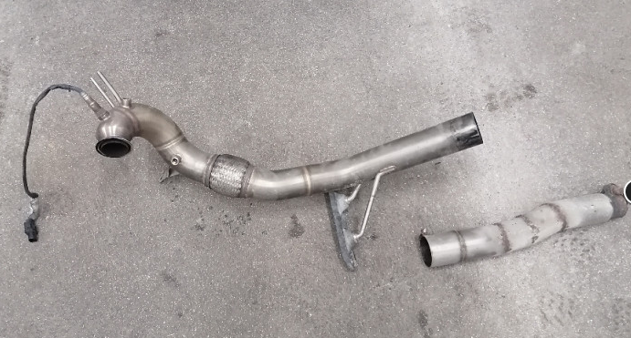

Do you maybe know if the downpipe from 2.0 TDI CR ( golf mk6, b6 passat) is roughly similar in shape to 1.6 TDI ? I could get the "oem" one for pennies
Re: Swap brakes
Roughly, yes. But not plug and play. I am running 2.0 tdi dpf from Ibiza fr
Re: Swap brakes
Yes I remember that detail. I have found this
~30Eur. Much cheaper than a new downpipe for 6R. Thinking of using the upper part ( vband, bung) and the bent part chopping it up. Much more cost effective than machining the bung, and v-band, and than having it towed to the exhaust specialist ...( budged build). Maybe they can make the difference using the DPF from the polo as reference and finally getting the 1549 mounted.
