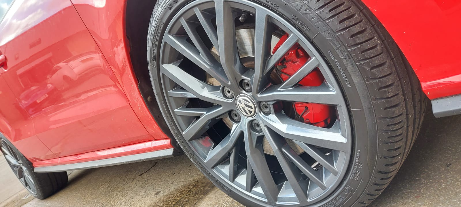

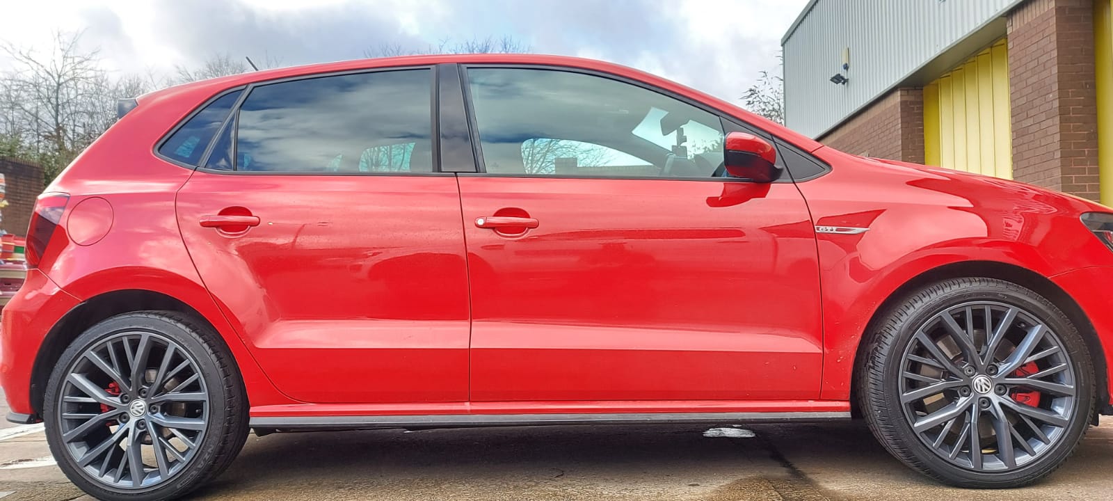

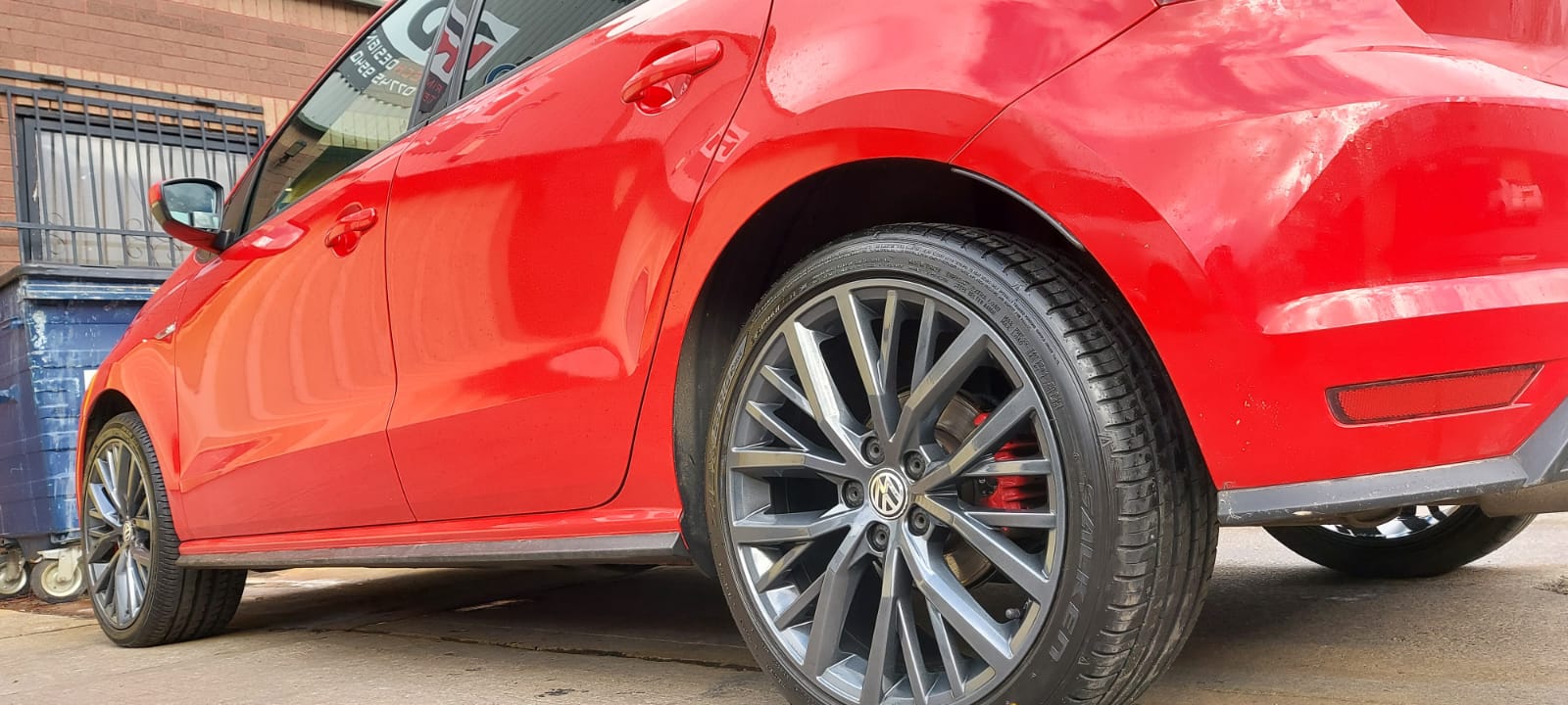

In case anyone is looking for ideas/alternatives for the white worm problem on GTI Diamond Cut alloys, below are my wheels now they have been freshly powder coated at Rimtech Designs in Stockport. Quality of the finish is 1st class

They look great @Gee40 👍 and a painted / powder coated finish is so much more durable than a diamond cut finish. I’m a big fan of anthracite / gunmetal / smoked chrome colours for alloys, and any of those three colours work well with most car paintwork colours - particularly red or white IMHO.
I personally have a great dislike diamond cut alloys;
  • poor durability of the diamond cut lacquered finish. IMHO diamond cut alloys aren’t really suited to a car that’s used as a daily driver in the UK during the winter months. It’s usually only a matter of time before they succumb to white worm corrosion.
  • they’re more expensive to refurbish in a diamond cut finish than getting a set of powder coated alloys refurbished. Because the diamond cut refurb process involves re-cutting the face of the wheel and removing a layer of metal, it also means that alloys can’t normally be refurbished more than twice, otherwise the structural integrity of the wheel could be compromised.
  • they seem to be easily damaged by inexperienced or overzealous tyre fitters.
Given the choice of diamond cut or powder coated alloys I’d go for powder coated every time. Unfortunately I don’t think car manufacturers ongoing obsession with fitting diamond cut alloys to their cars will end any time soon, judging by the number of cars that have them as OEM from the factory.

Completely agree with all your comments SRGTD.
The car has never touched a kerb or had the high acid level alloy wheel cleaners favoured by "hand" car washes used on it, yet all 4 wheels have suffered from white worm with even the one replaced by VW under warranty 3 years ago starting again with it. this was the final straw hence the decision to go with power coating. I love the anthracite/graphite look, but I am expecting some flak from the purists who I thought would be shouting about originality

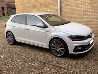

@Gee40; you won’t get any flak from me 🙂. My 2016 Polo GTI gained a set of anthracite coloured alloys within three months of getting the car;

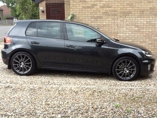

Prior to that, my mk6 Golf GTD also had the factory diamond cut alloys swapped out for a set of anthracite coloured alloys - the diamond cut alloys succumbed to white worm like yours did;

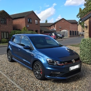

And I’ve also swapped the diamond cut alloys for a powder coated set on my current Polo GTI+;
I keep the original diamond cut alloys and put them back on when the time comes to sell the car.
