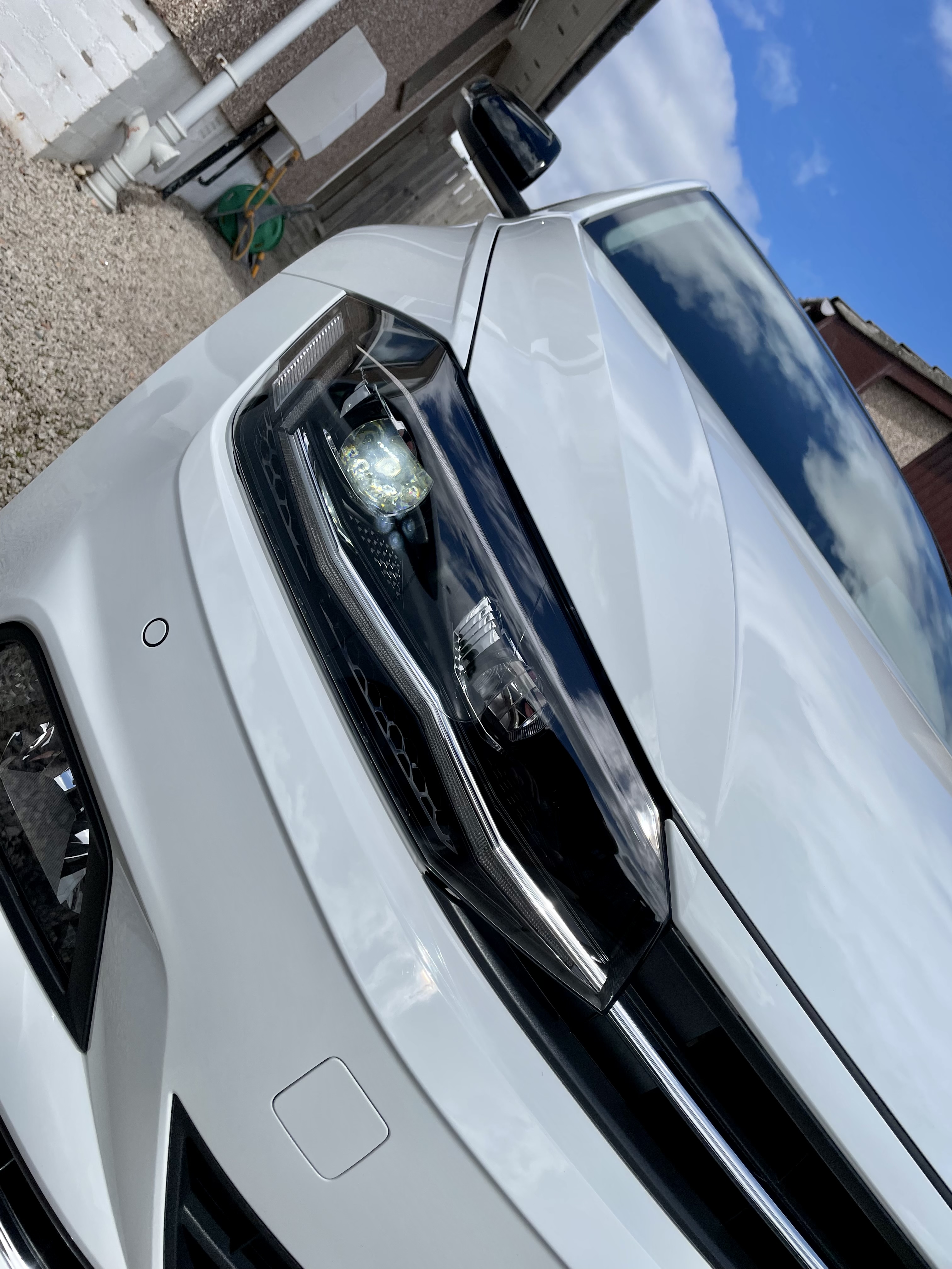

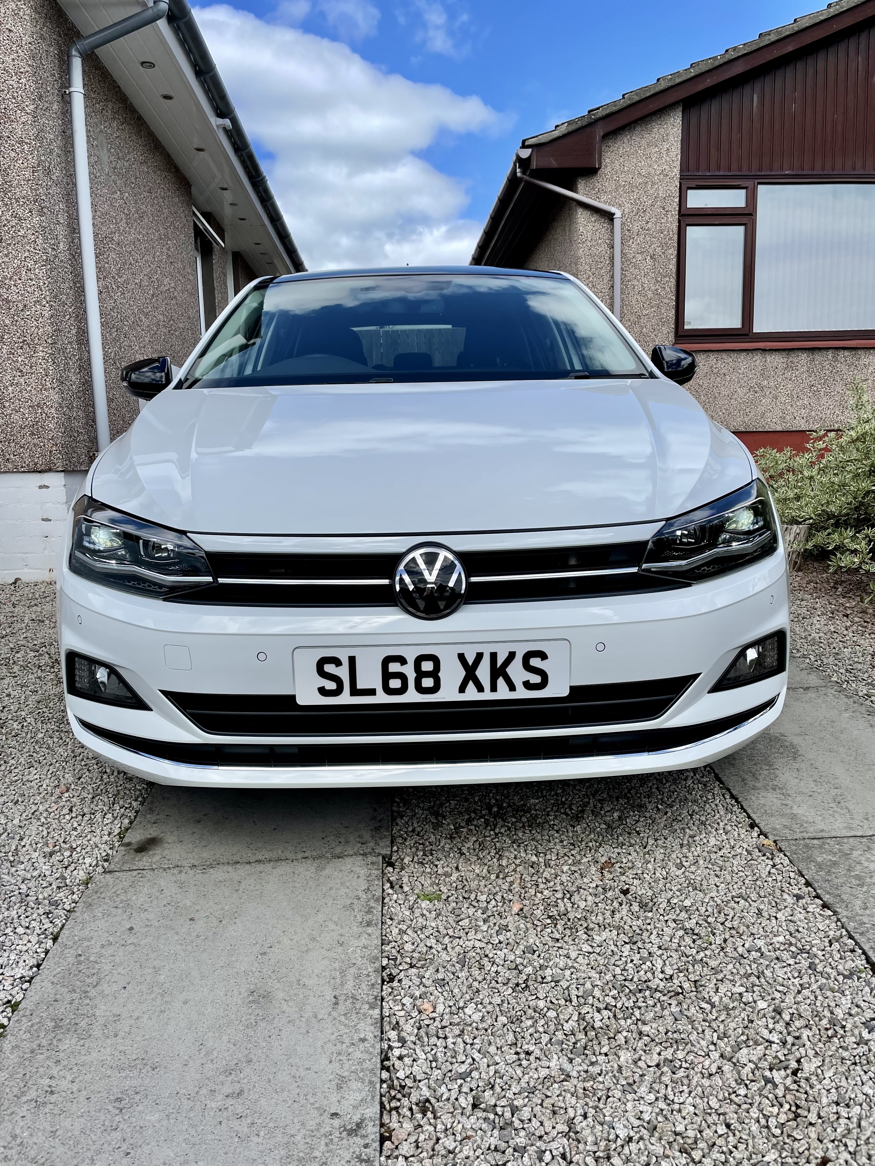

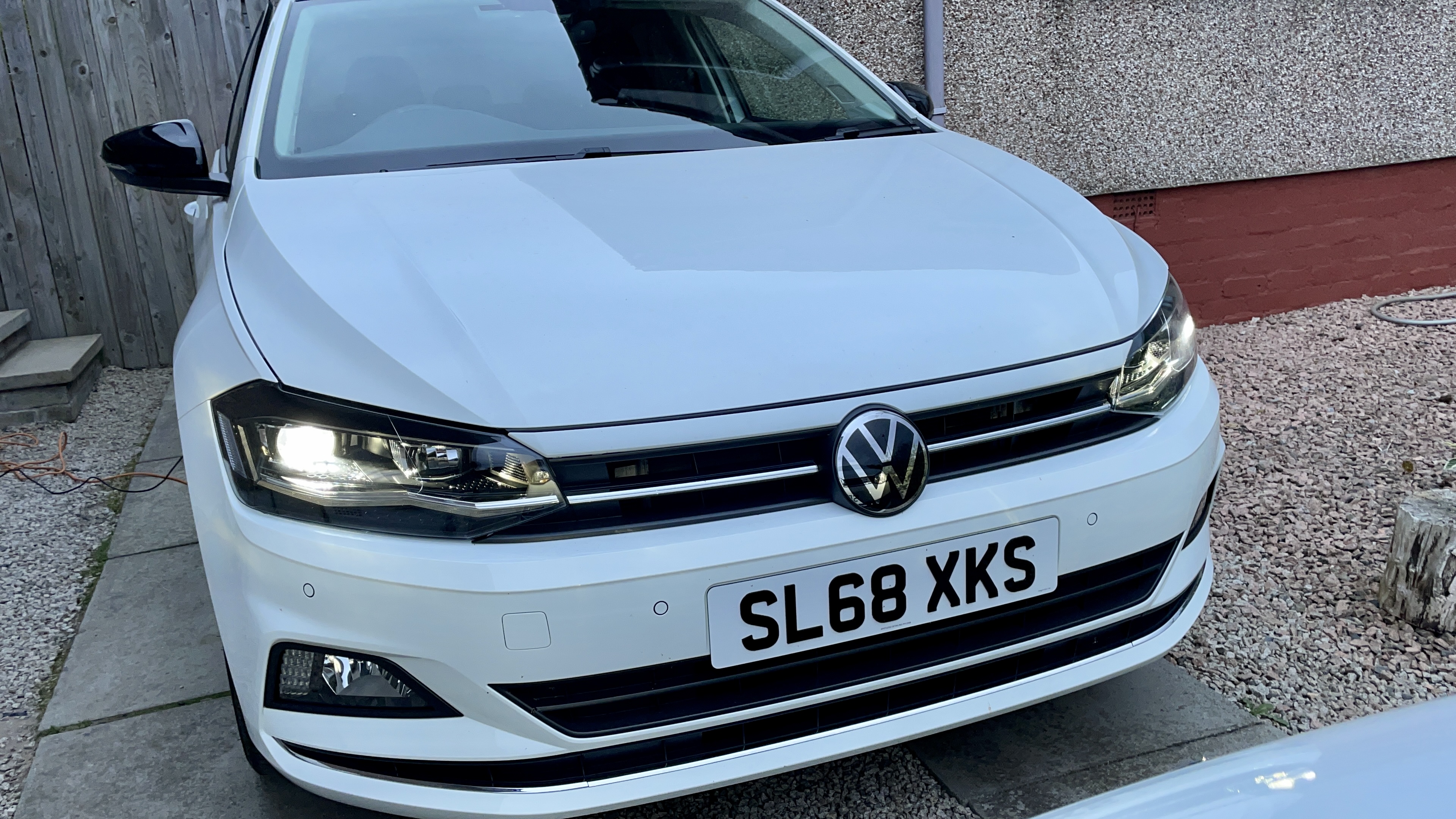

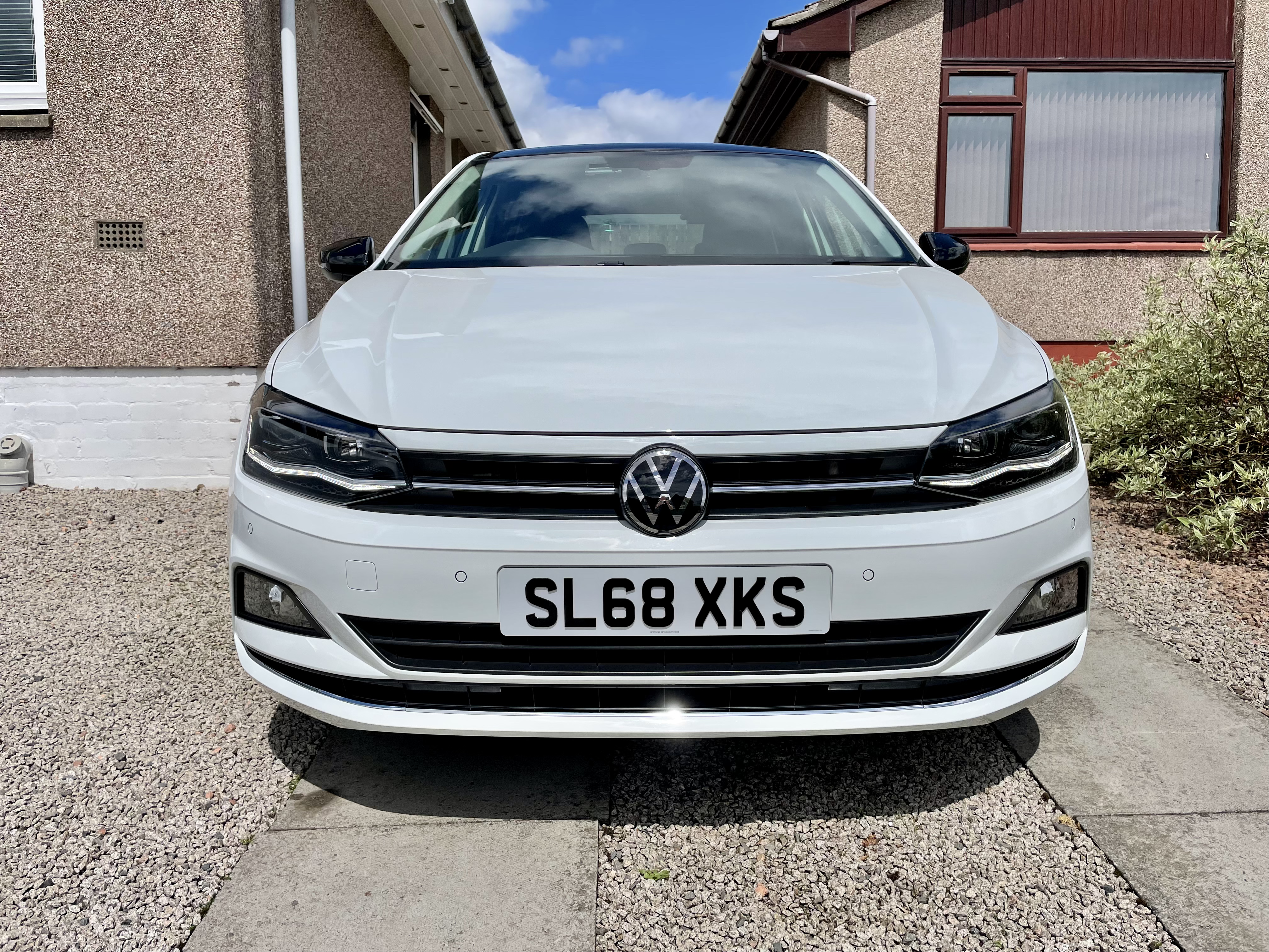

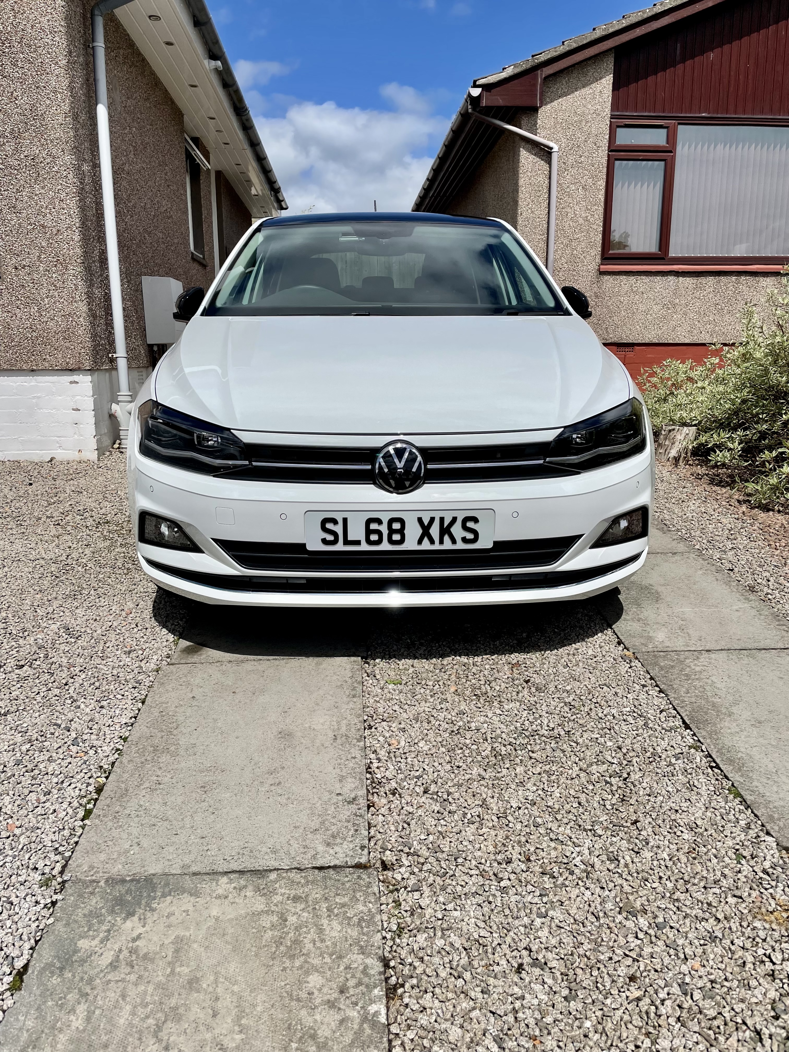

Today I retro fitted the genuine LED headlights to my polo.
These things are awesome 🤩

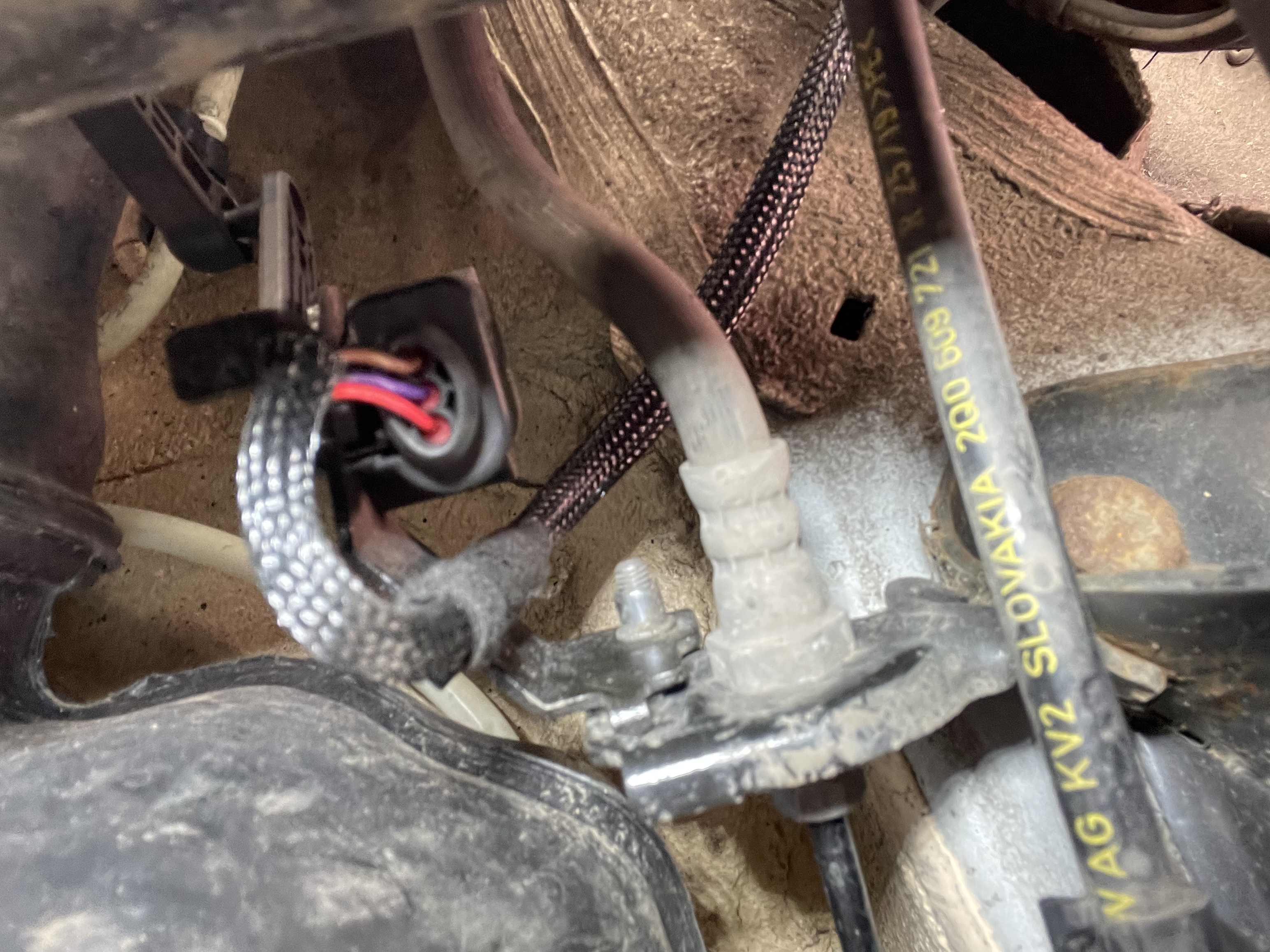

Hello, I have a 2019 Polo GTI that was factory spec'd with the standard halogen lights, i am trying to upgrade them to the DRL LED headlights that come with the GTI plus. I have bought the genuine VW DRL LED headlights that were made in March 2019 although when i tried to switch them the cable connector did not fit. Any idea on where i can get an adapter for the connection and will i need to rewire the cables & recode for the upgraded headlights?
Scotty_boy vw
Posts: 133
Location: Dundee
Re: LED headlamp retrofit
Post by Scotty_boy vw »
AndrewBarnett99 wrote: Thu Aug 05, 2021 2:15 pm Hello, I have a 2019 Polo GTI that was factory spec'd with the standard halogen lights, i am trying to upgrade them to the DRL LED headlights that come with the GTI plus. I have bought the genuine VW DRL LED headlights that were made in March 2019 although when i tried to switch them the cable connector did not fit. Any idea on where i can get an adapter for the connection and will i need to rewire the cables & recode for the upgraded headlights?
Hi andrew send me a PM and i can get you in touch with my mate who did all my looms for my LED RetroFit

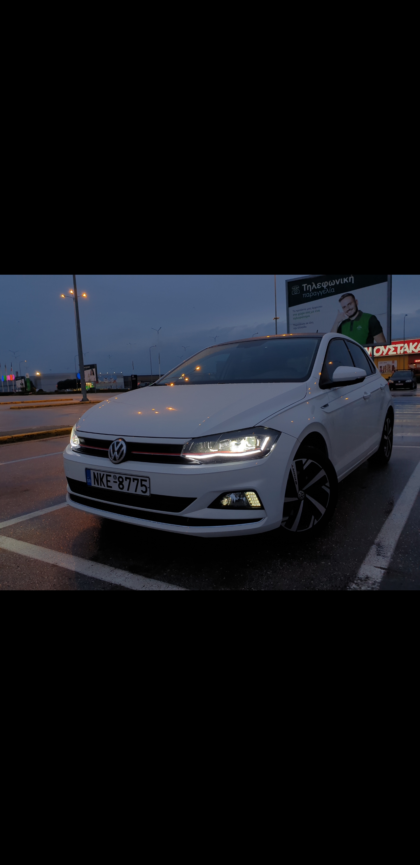

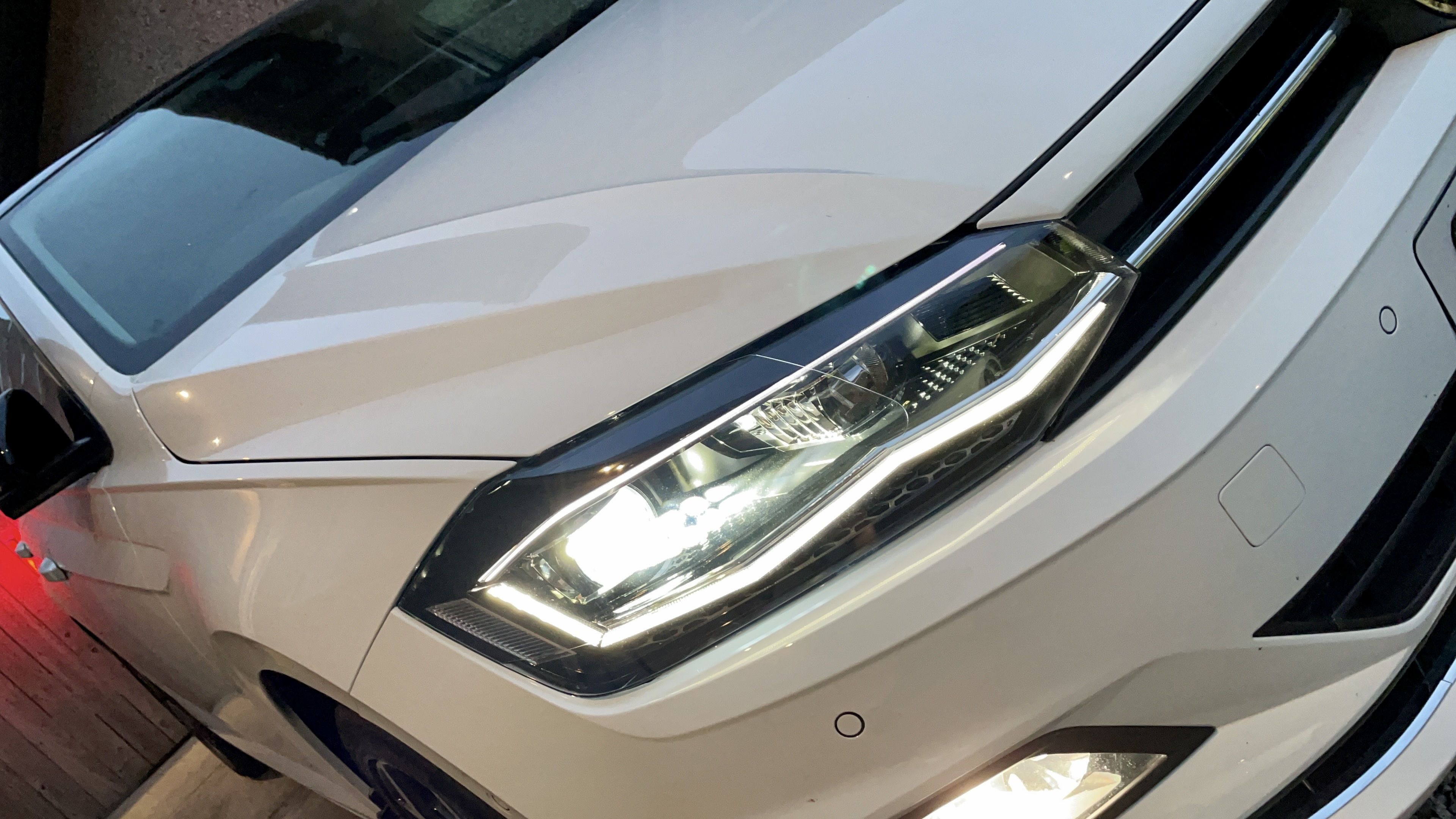

After about 6 months, my headlamps, I bought from aliexpress, work flawlessly! Their light is bright and strong.
Recently I noticed that in your headlights, both DRLs (the upper strip and the bottom strip) keep being lighten up after some time. In my headlamps, they light up when I turn the lights on, bit after some seconds (not even a minute) the upper DRL strip turns off. So, the car looks like this:
So, it differs from the original LED Headlamps. Do your DRL upper strips also turn off after a minute, or they keep being turned on?
It is not a problem, as it turns on as it should with a blue tint at the start and then becomes clear white.
