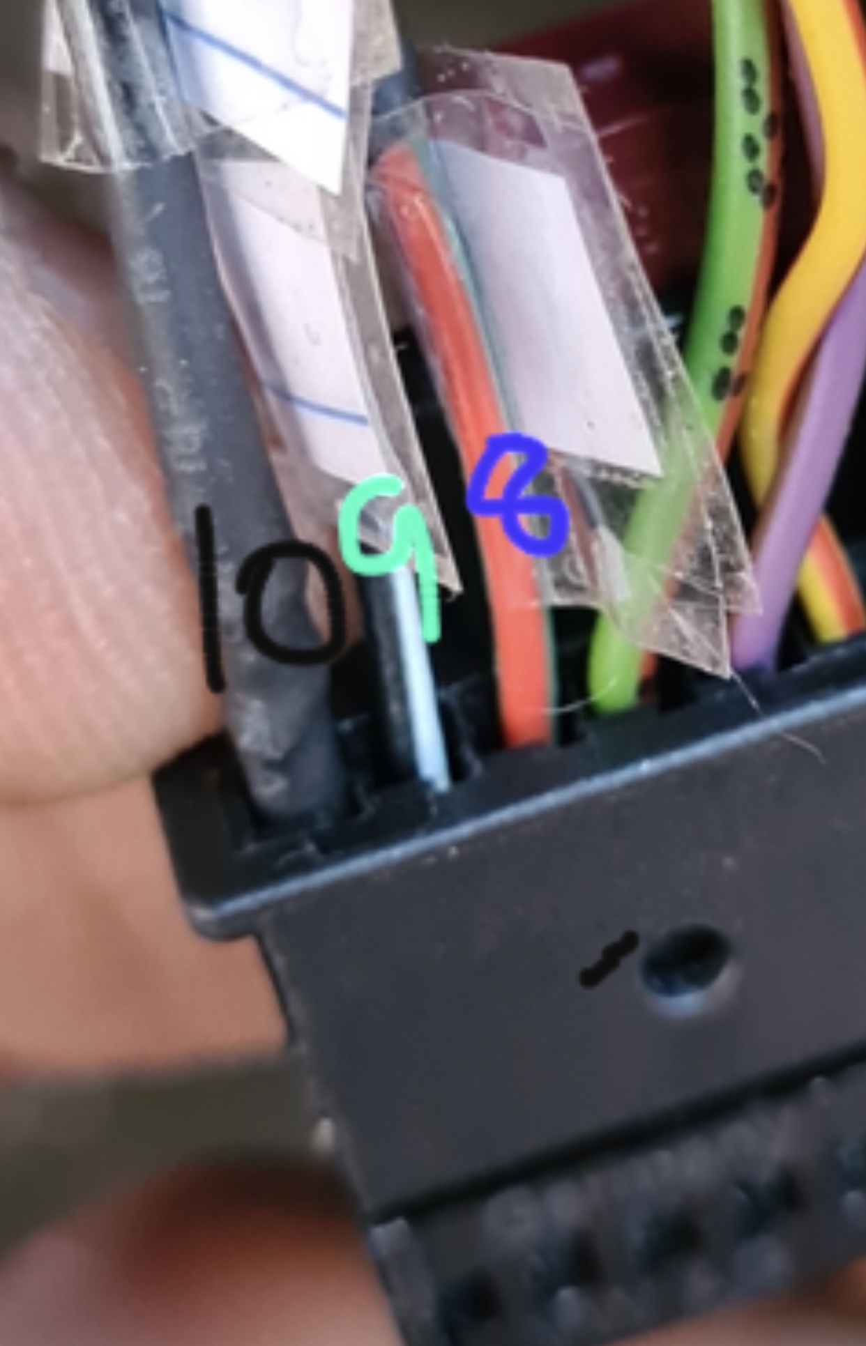

Hi sr, what number of pins were used in the wiring of your installation, thank you very much for the contribution
giannis20vt
Posts: 425
Location: Greece
Re: Giannis20vt's Polo 6c 1.0MPI
Post by giannis20vt »
Atalv wrote: Sat Mar 12, 2022 6:05 am Hi sr, what number of pins were used in the wiring of your installation, thank you very much for the contribution
the schematic is:
The contacts are all MQS (micro quadlock system). pin type: 000979009

TCP & TPMS buttons
I decided to fit buttons for TCS and TPMS set. Both of them to the center console.
I bought those buttons from Aliexpress.
The connectors and the wiring
Image Image
The schematic:
Testing the wiring and the buttons.
The illumination looking good.
Next step is the fitting.
I had to remove the RCD, the center console and the
Image Image
A mess...
On the top there are the 2 connectors from Hazard warning lights and Heated rear window.
According to the schematic, the illumination wires should are No3 and No6 and should be connected to No3 and No6 of the Heated rear window connector.
And the final result :
Image Image
I haven't connect the other cables yet, i have to drive 2 of them to the engine compartment and another one to SC30.
So long those buttons are for decoration purposes only. I have to do the rest of the wiring and some coding with VCDS.
