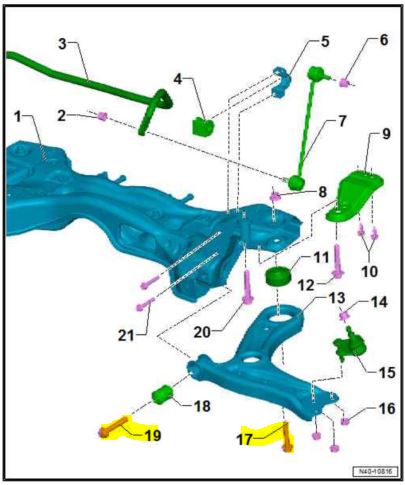

Hi all,
I'm looking to replace the bushes on the front lower wishbones on my 2017 6C but I can't seem to find the part numbers for new bolts that go through the bushes to the control arms. My understanding is the the bolts that connect the wishbone to the subframe are torque to yield so ideally I would replace them when I replace the bushes but I can't seem to find online
Does anyone the part numbers for these bolts or where I can find them?
See the image below for the bolts I am talking about - They are 17 and 19 and I've highlighted them in yellow
Any help is appreciated

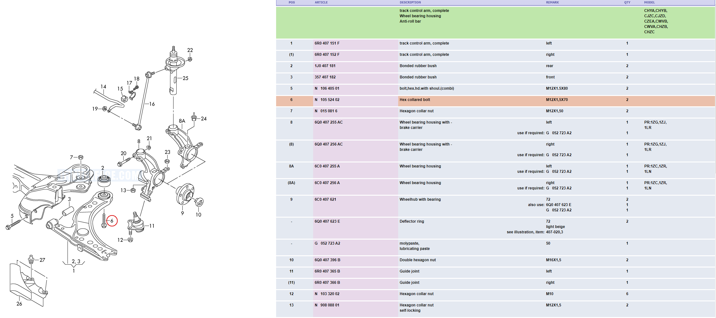

Bolt for rear bush:
N 105 524 02
Bolt for front bush:
N 106 405 01
Torque spec for both is 70Nm +90°
Hop that helps :)
