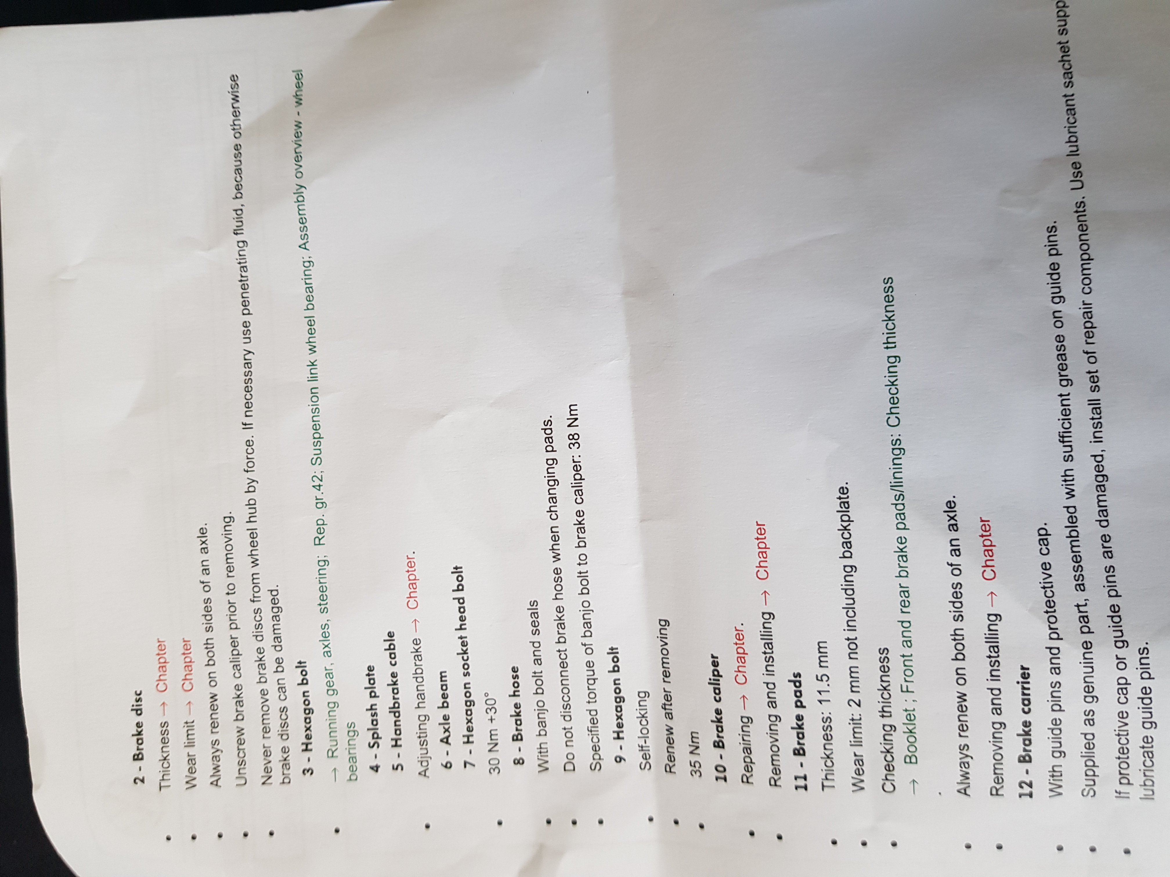

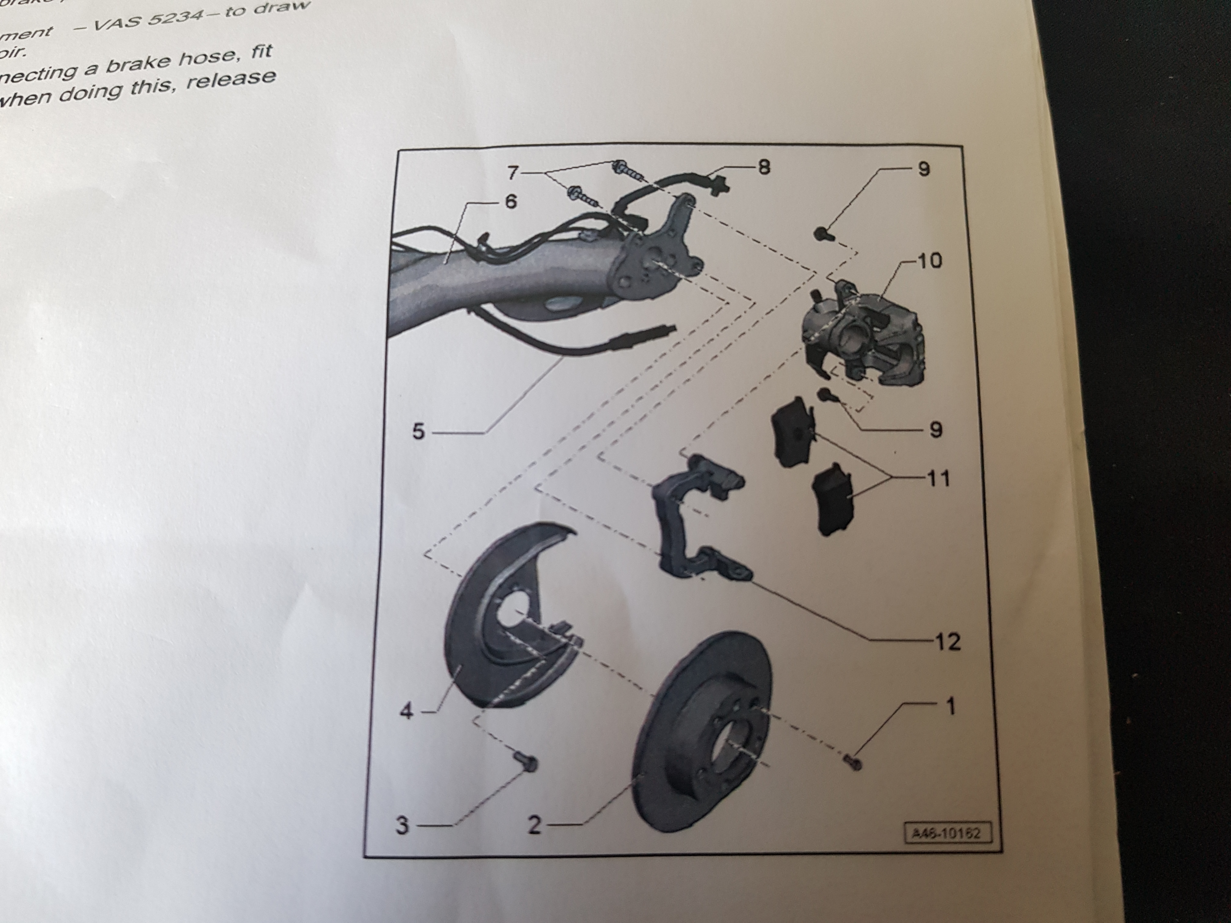

After seeing me friend at VW they gave me a print out, the caliper bolts get changed on removal, and torque to 35nm the caliper bracket to wheel is 30nm +30 deg and nothing saying about changing them bolts.
No:-7 Caliper Bracket
No:-9 Caliper bolts
What I need is a tool to do the +30deg, one I have seems crap, any ideas?
No:-9 Caliper bolts

That 30Nm +30 degrees is what I found in the official VW workshop manual as well, it just seems a very low torque value, but if the existing bolts come out easily then it must be okay.
I discovered "no need to replace bolts" as well, which sounds weird when these bolts are getting the initial torque then an angular measurement - but as I said that torque is quite low for that size of bolt, so maybe little or no weakening of these bolts occurs. I'd still replace these bolts if the heads look a bit nasty as if they look nasty now, they might give trouble taking off next time, I never like to leave any traps for future owners, maybe me being stupid.
Getting the 30 degrees bit correct, I'd mark the "zero degrees" position and guestimate where 30 degrees is - and mark it, 90 degrees is easy, so half that and just tighten up to just before that, or if you are really good at that sort of thing, mark out the 30 and 60 degree points.

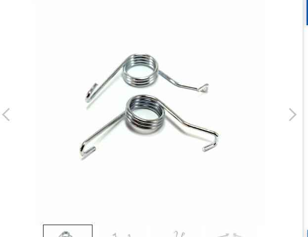

Hi all, I know this is a old post, but well relevant to this topic.
What I am after is a VW OEM code for some springs that go on the rear Caliper, I Installed then on my old Golf 2004 GTI and I am looking do the same on the polo, it helps with the hand break return, by default there not a part number for the golf or polo. but is part of another I just cant remember witch. so hoping someone on here will know what I mean and after.
A picture of what I'm, after just a VW OEM code

Have a look in my Polo build topic, first page, they are written there.
- Posts: 6093
Re: Rear caliper
Twice I've added them to Polos, and in each case I found that the MK1 VW Sharan ones were the best fit and tension in terms of adding in just enough extra "return" force on the hand brake lever. Unfortunately check the number or its latest iteration as I'm away from home and have not found my memory stick in my luggage.

I fitted these springs a year or two back. Bought mine on eBay. Here’s the link
https://www.ebay.co.uk/itm/261853826244

LH Handbrake return spring 7M0 615 295 (from 1998 Sharan)
RH Handbrake return spring 7M0 615 296 (from 1998 Sharan)
From my records in August 2015.
