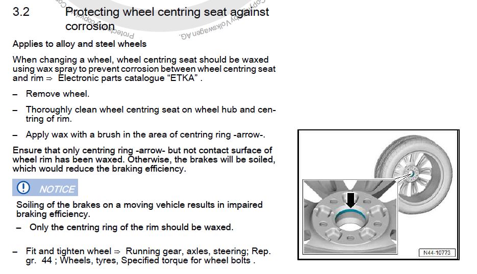

ho8882000
- Posts: 158
- Joined: Fri Sep 20, 2019 9:06 am
- Drives: 2019 (AW)
- Location: South Africa
Re: Alloy wheels corroded to hub
The following is from the VW Polo (AW) workshop manual, doing this can avoid the same problem happen again in the future:
