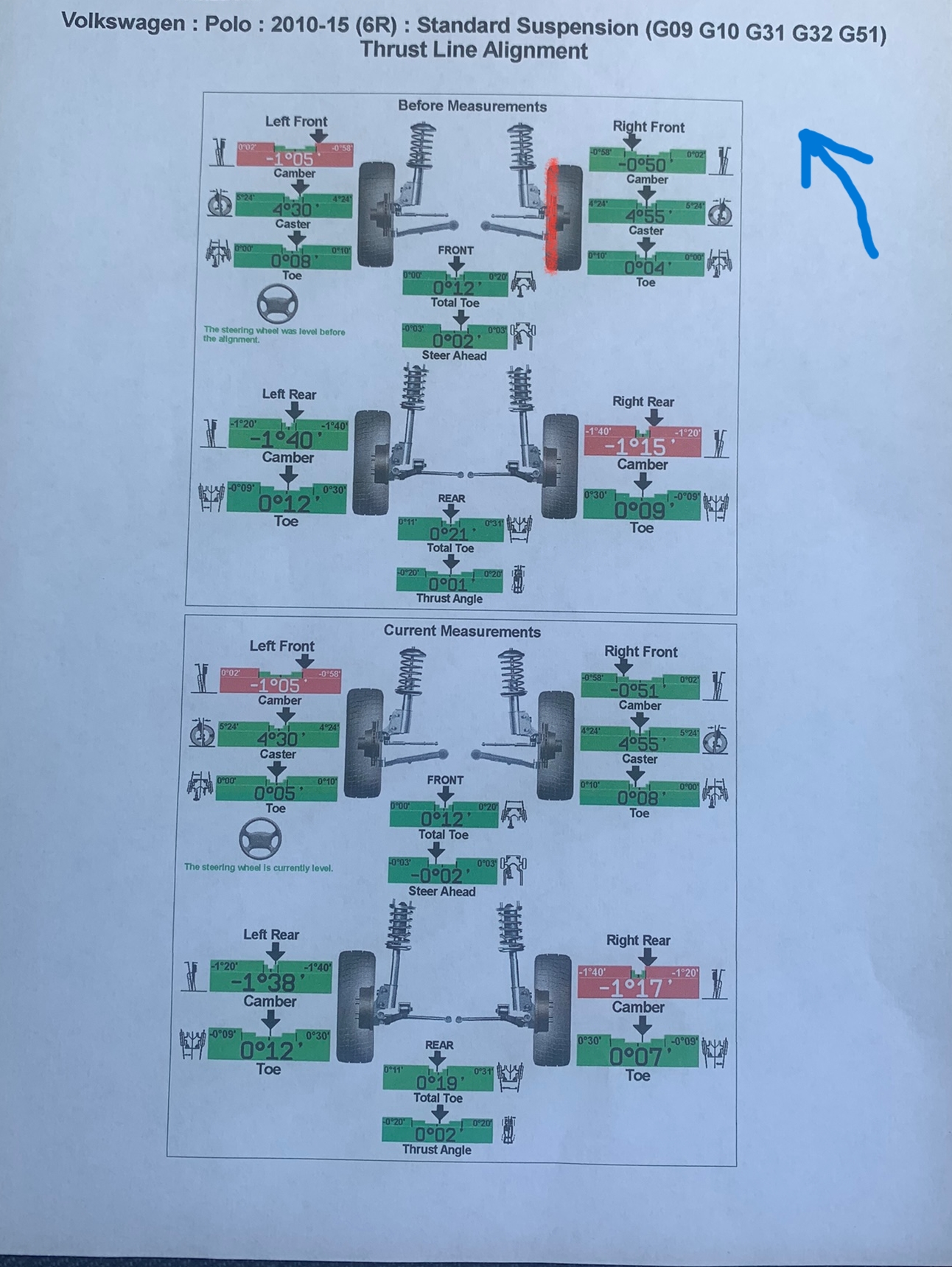

Hi everyone, hope someone can advise, my polo drove perfectly staright before i had an MOT, and the guy said it needed an inner track rod end replacing.
I asked for him to try and restore the threads as before, he said it will need tracking afterwards anyway.
Immediatley after the MOT i noticed the car doesnt drive straight, and goes to the left. So i had the tracking done,
It did improve some,so i thought it might settle down after. However after several months, its still not right, and after a few months the driver side tyre has worn on the inside.
Heres a printout of the tracking as it was now.
tracking kwik fit may 2022.jpg (1.03 MiB) Viewed 1786 times

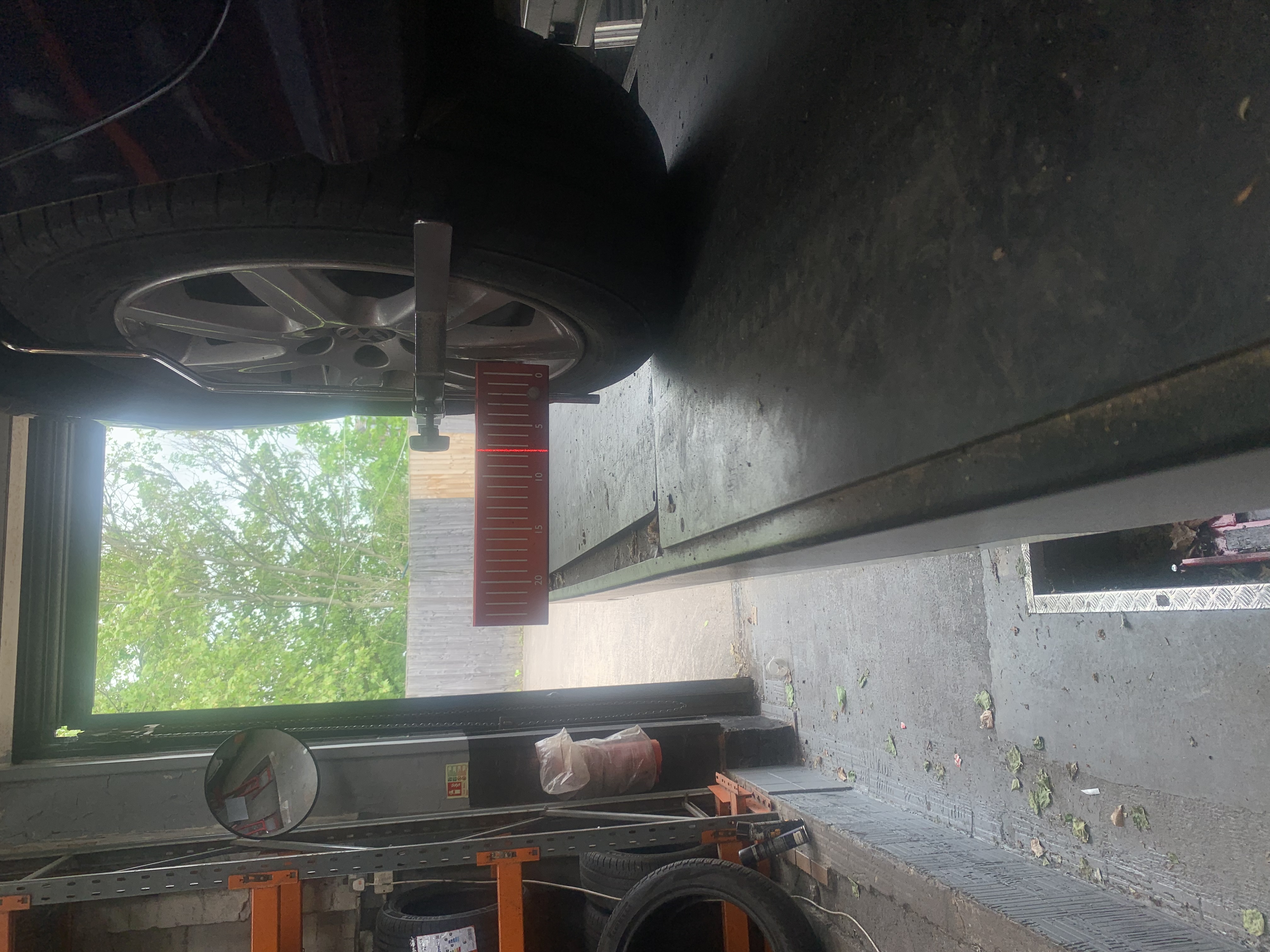

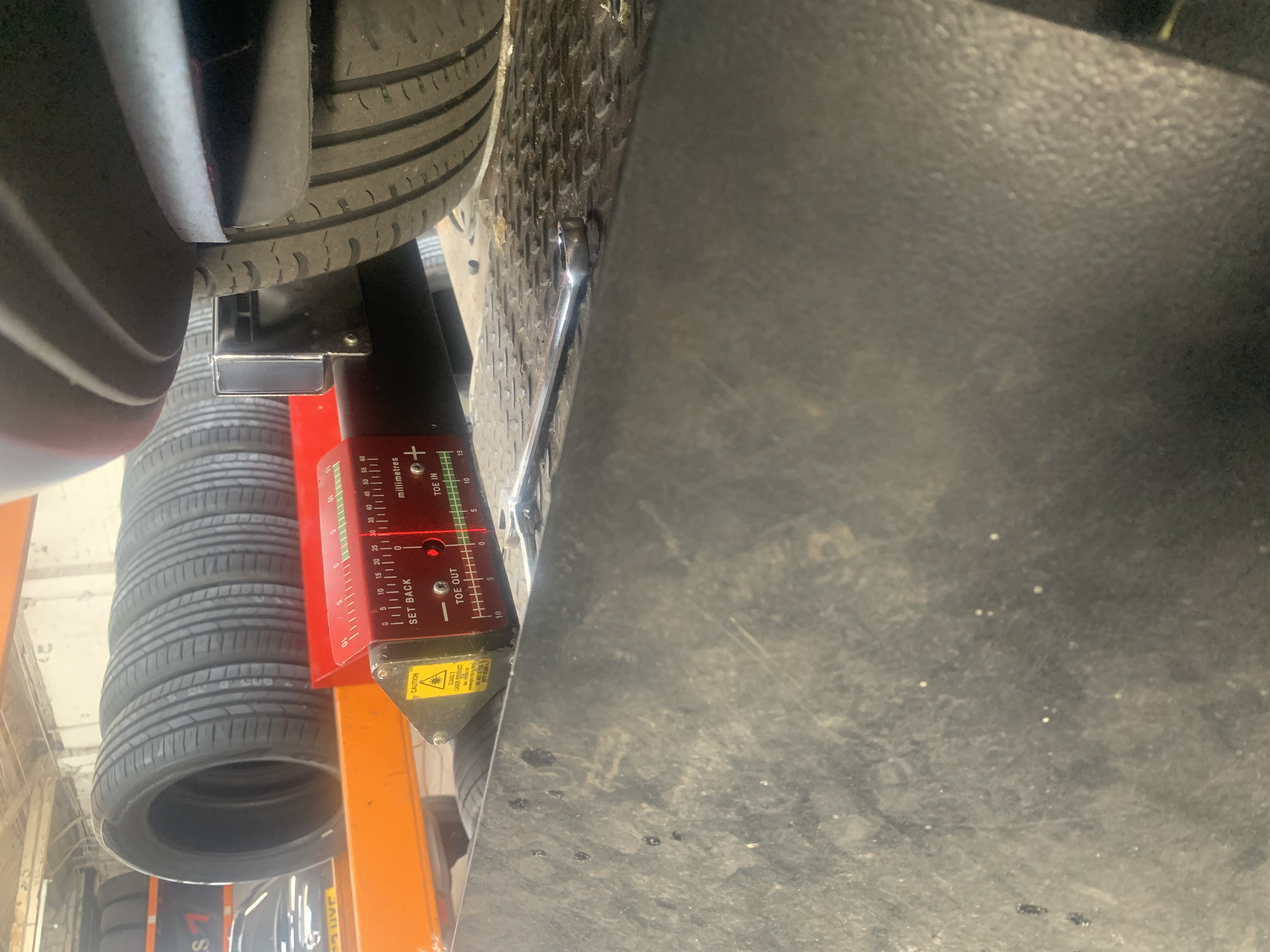

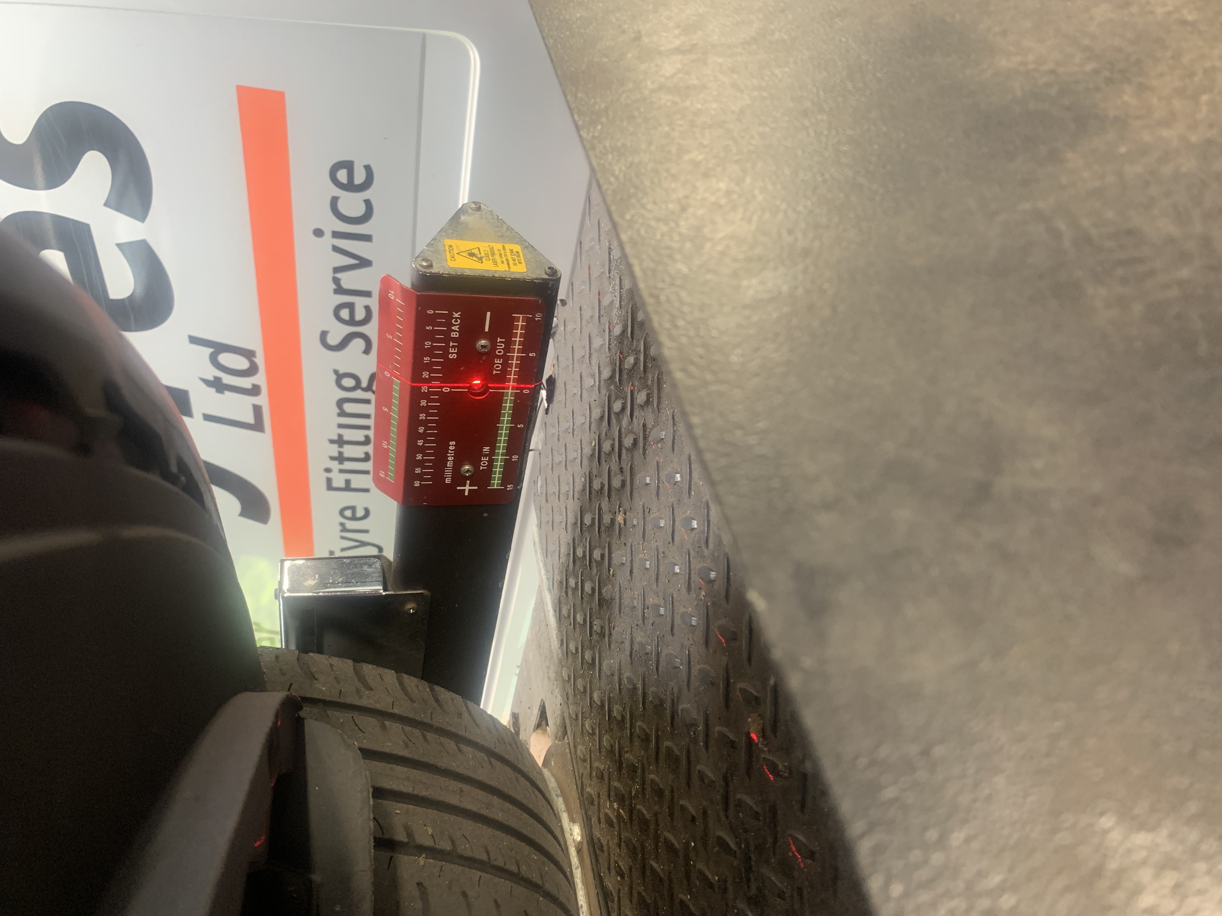

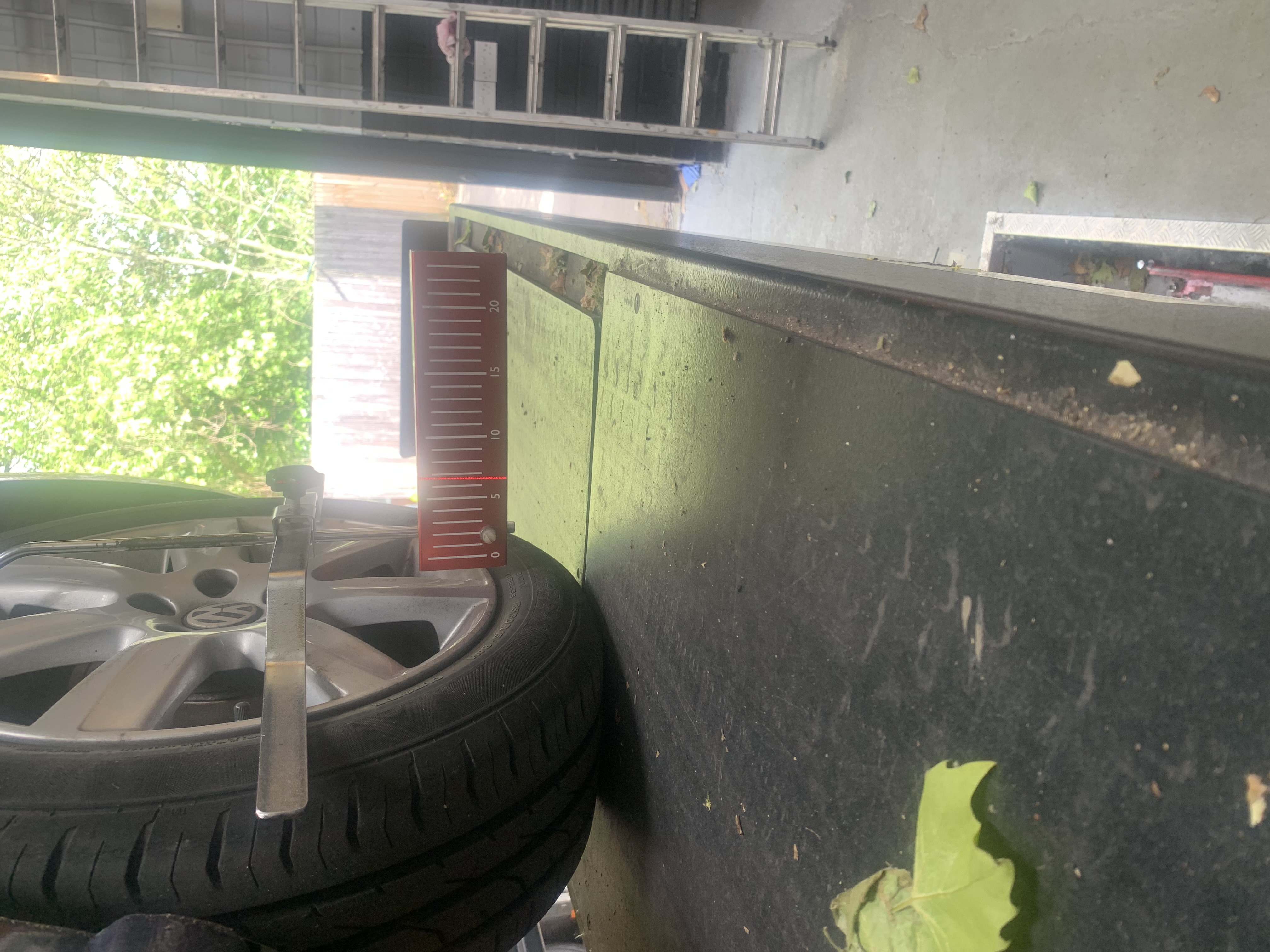

I had taken it for the tracking to an independent tyre shop after the mot, then i had asked them to check it again (because it was still going to the left although not as bad before they adjusted it) They said it was okay and didnt change anything. heres the pics of the settings, it shows driver tyre 2mm toe in ( worn on inside since mot), passenger tyre 1mm toe out, rear drivers side 7.5mm, rear passengers side 6.5mm. After this i took it to kwik fit who also said it was okay.

they are both even and when on the tracking machine the laser reading was on 7.5mm and 6.5mm, whatever that means.

As per your pictures the two rear reading on that type of machine (not really 4 wheel alighment) should be the same with the steering wheel straight ahead and clamped .
other wise it will pull to one side , the rear flags are only telling the operator where the front wheels are pointing , plus the rear bar should be in the centre of the wheel

Also notice the front wheels are not on a spin plate, but would not matter for checking. But as the last person said the back wheel markers need to be the same to show the front is straight. Sometimes i would just kink the streening wheel very slightly right if not straight then clamp, as a car will wonder left a little due to road camber. Once the backs are lined up, you can then +and - both fronts to get the correct reading.
Also is the tracking tow in out 0, have no access to a chart. But sure prob be a +1

I think you have something worn out on the car. You camber is not in spec and that will for sure make the tire wear out faster.
Id check front bushing and shock, and on the rear the shock.

I suspect that +1 is within spec for your car though that may be the cause of the pull. It's just unfortunate. I agree too with amer that perhaps there's wear and tear on another component but the steering not being held properly could also be the cause.
Third time lucky somewhere else? And tell them that it pulls left as it is and hopefully they'll make you a new customer and sort out your problem. I repeat though, that probably the current setting is appropriate so you don't need to worry about your tyres wearing from the tracking...
