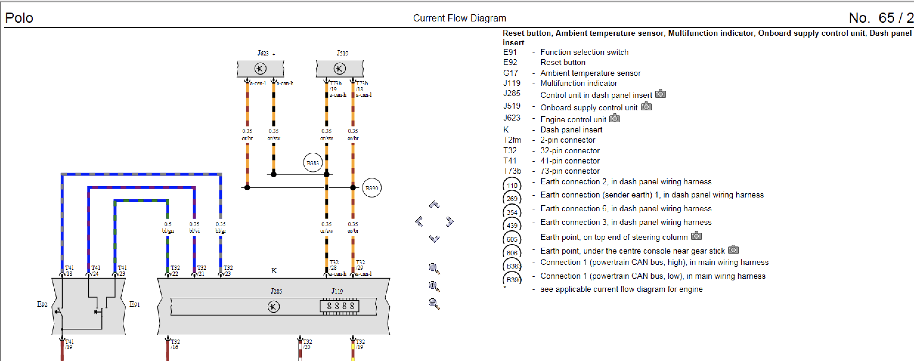

My car did not come with a MFSW or the wiper switch that includes the Trip and OK/RESET buttons, so I couldn’t view mpg or anything besides time and outside temp on my MFD.
I’ve just swapped the stalk assembly for one with the buttons, but they don’t work as I assume I’ll have to enable something in VCDS.
Could anyone tell me what it is I need to enable?
Or also is there any other wiring that I would have to do to enable the buttons?

Yes you do need to add three wires to your instrument cluster and code it with vcds.

Is there a guide out there?
Re: Enabling Trip and OK/RESET buttons VCDS
You will need to run the three blue accented wires on the image and enable byte 1 bit 3 in the cluster long coding.
