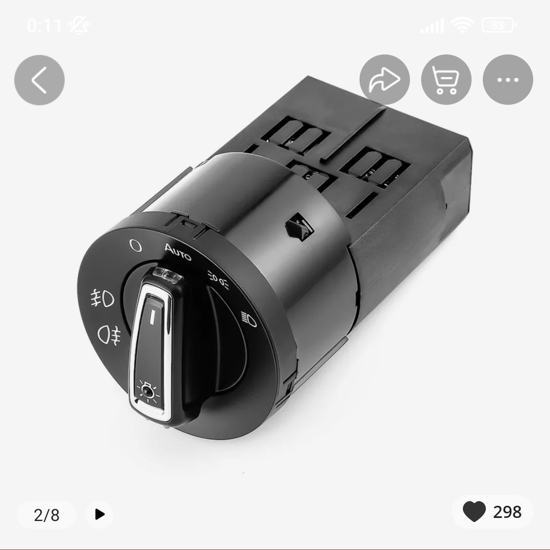

I have seen this kit that is removable and put, has anyone tried it? I guess they will not be of good quality for the price it has.
I would appreciate some guidance on how to do it since I don't want to put something that doesn't work well.

Installation is easy, just unplug the your light switch, pop the new one and program it ( read the manual that comes with the switch).
If it has a detached light sensor just route the sensor on to dashboard.

i have installed one of them. THere are several versions, you have to be very carefull when you choose the item.
Mine works fine, it handles the lights very well. The only problem is the warning sign for forgotten lights, at night, when you turn off the engine and open the driver's door. And that's because it has a leaving home function and keeps the lights on for about 30 seconds.

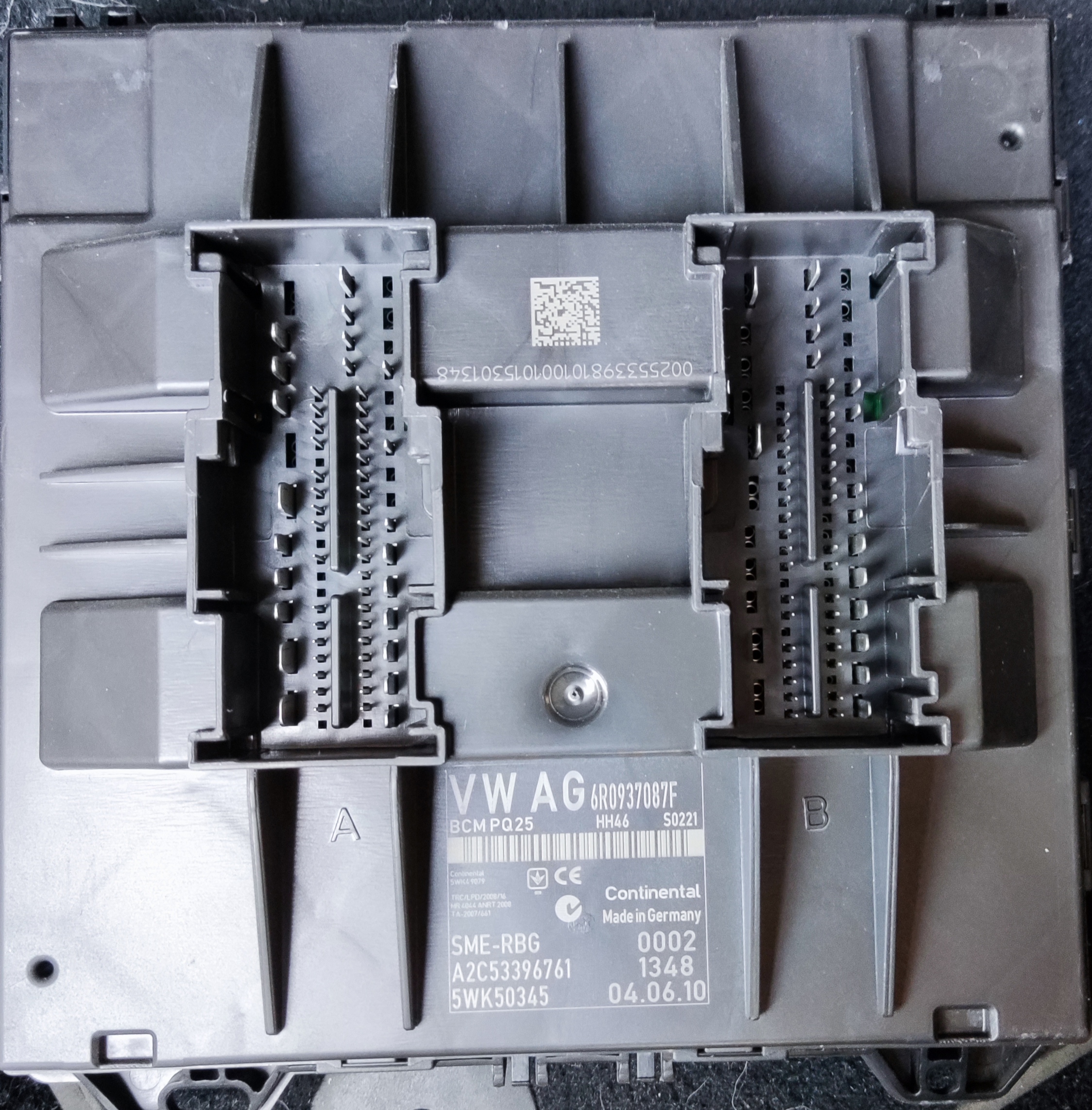

Do you know if with this BCM I could retrofit some OEM automatic lights?
- IMG_20220905_230239.jpg (1.77 MiB) Viewed 1497 times
