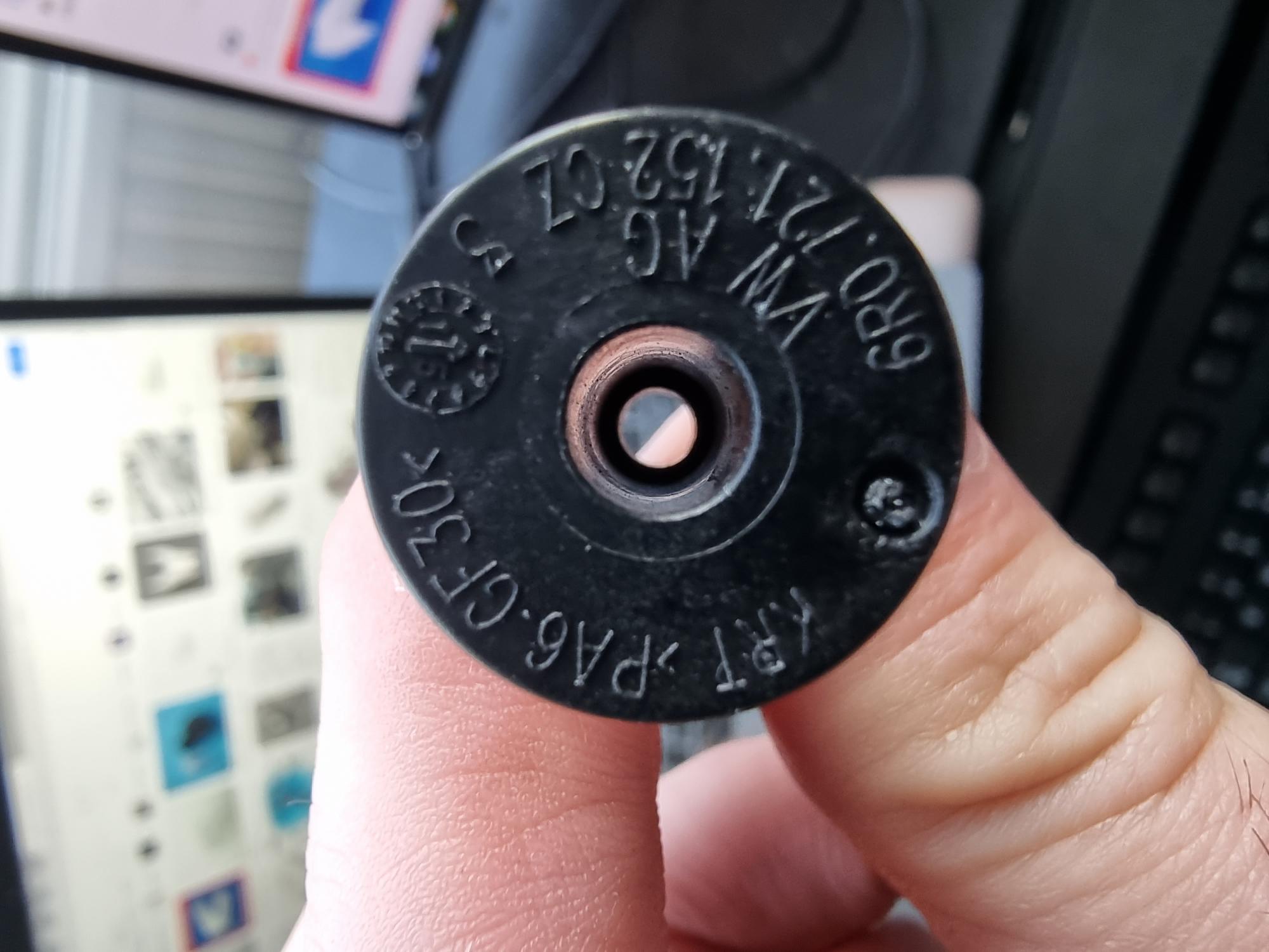

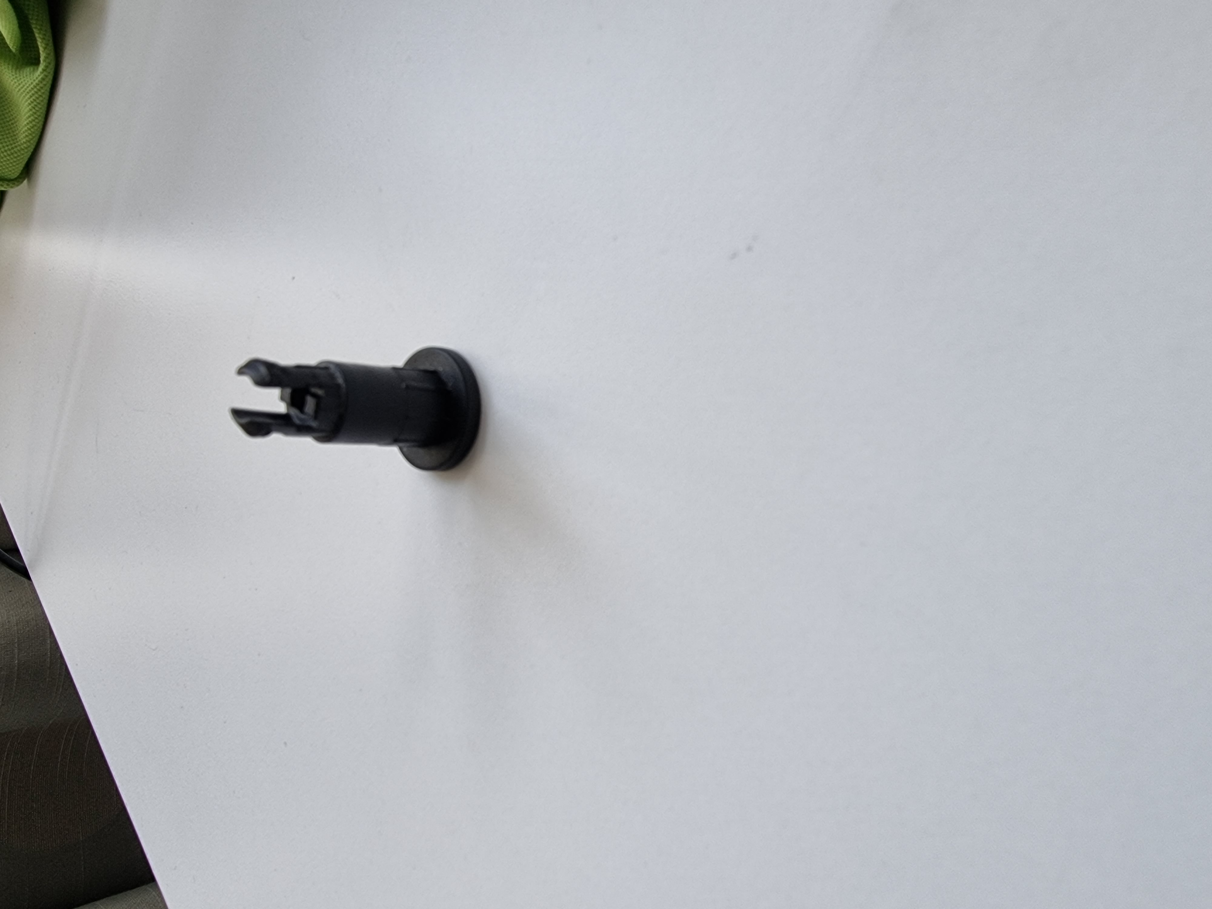

This part (images attached) has fallen of my wifes GT Blue Motion 2016 - it must be off the clutch pedal mechanism as we found it on the footwell and the pedal has sprung up higher than the other pedals. It still works but obviously Id like to fix it...but I cant see where it might go. Any ideas greatly received!

Just google the part nr: https://www.ebay.com/itm/202299868072

From that diagram, it looks like the other pivot (item 4) is the one that locates the clutch pedal to its bracket and the pedal pivots on, this pivot looks like it is used to fix the clutch primary cylinder's push rod to the pedal.
If I were you, while things seem to still be working, I'd find a workshop to either refit that pivot back in or buy new parts and fit them into place.
