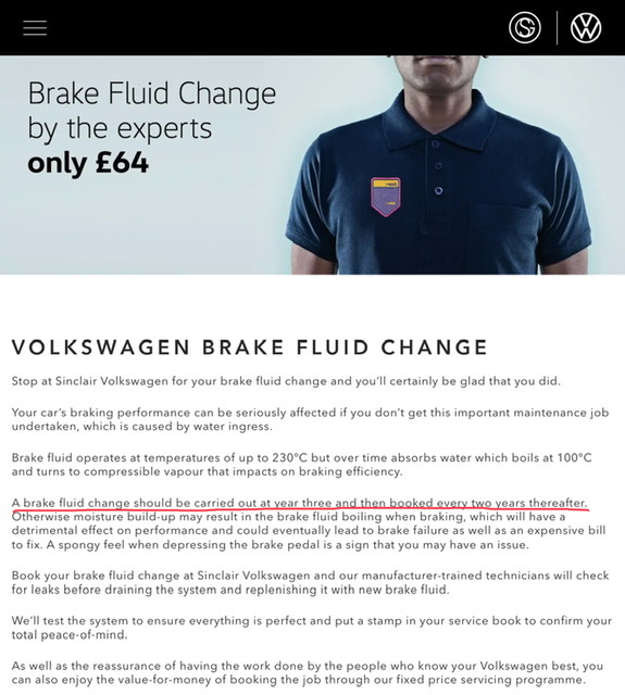

LEEA123 wrote: Sun Nov 13, 2022 6:10 pm my car is only two years old, so if the fluid is three years now then why try to sell me it on my second-year service, I just don't get that, looks like maybe up selling to me.
I think I would challenge the dealer and ask them why they’re trying to get you to pay for the first brake fluid change at two years when it’s not due until year three. It would be interesting to hear how they respond 🤔.
VW appear to have conveniently removed the fluid change intervals from their website, but it’s still on some dealer-specific websites. This is from Sinclair VW website;

I thought that since maybe 2019 or 2020, for all new cars reg'd from that point onwards, the given recommendation for all VW Group marques was now, change brake fluid every 2 years even from new.
