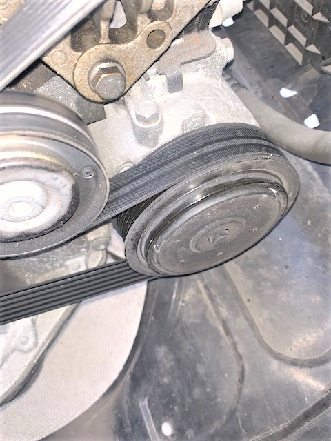

Hi everyone,
i bought a 2014 polo match 1.2 couple of years ago, im looking for some help to diagnose & hopefully fix my AC, as it doesnt blow cold air, and never has, the blower all works fine otherwise. What ive done so far is, i dont hear a click when operating the ac button, and so when i look at the compressor, the whole pulley including all the central area is always spinning even when the ac is switched off, Im wondering if mine has a clutch or not to explain this. i have taken a pic below. i guess i could meter the electrics supply/ control plug, not sure where that is yet, thanks in advance :)

That compressor type does not have an electro magnetic clutch, the compressor is always driven, but operating at a very low displacement, that keeps enough oil running round the system to stop any rubber elements drying out and causing leaks.

Edit:- there is a cable that connects to that compressor it is to alter the effective compressor displacement so you could check that it is okay, though I would be getting a scan carried out on that AC system using VCDS for instance.

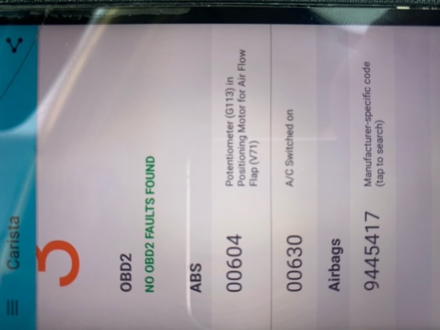

todays a bit warmer 10'C so i had a look at the AC fault, i dont think its working, i did feel the high and low pipes and they were warm and coldish, but i dont think cold enough. I ve got a Carista app, and it gave these codes ( i have hopefully fixed the airbag switch, pins not soldered inside it !) I did clear all the codes after i repaired the airbag switch, and i heard the motor flap or something move inside the vent areas. I ran the AC for 30 minutes, and theres no error code yet, and it doesnt really blow cold, maybe slightly, but not sure. A few days ago, the halfords guy connected a refrigerant can with pressure gauge, and i saw it was in the green zone.

I would have expected that any problems relating to the fridge gas pressure sensor to be picked up by a proper scan tool, I'm not sure how smart Carista is when scanning the HVAC system, though with my wife's 2015 6C Polo, I did get a a low fridge gas pressure fault logged when using VCDS, though with that scan tool I can also check the standing pressure and it showed that the fridge pressure was near enough zero.
Did that Halfords person check the fridge pressure when the AC was being asked to run, if not, maybe they only checked the system standing pressure which would still give a "green" reading if there was still some liquid R134A left in the system, but as soon as you started demanding any work from the chiller, the pressure would change and not get high enough to switch on the evaporator cooling fan. As far as I know, the evaporator cooling fan does not get switched on directly by the AC system being ON, it will also need the gas pressure to be high enough to run, as running it at all times the AC was ON could end up with running pressures being too low for that system to be running efficiently.
