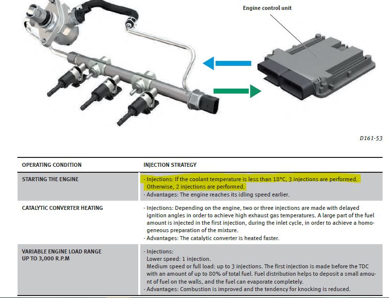

I have a EA211 1.6 MPi naturally aspirated 4 cylinder petrol engine in my Polo, it also idle roughly within the first minute of starting the engine (When coolant temperature is below 18C), this is more noticeable in winter (I am in South Africa, where it is not as cold as UK). But once the coolant is at normal operating temperature (90C), the rough idling shouldn't be happening.
According to the SEAT document - "EA211 AND EA888 FAMILY ENGINES SELF STUDY PROGRAMME No. 161", during idling the EA211 series petrol engine's injection system will inject 3 times when the coolant temperature is below 18C and only 2 times when coolant temperature is above 18C, I guess the initial rough idling we experience comes from the 3 x injection mode (coolant temperature below 18C):
EA211 - Injection.JPG (79.8 KiB) Viewed 94328 times
cold start idle is around 1600rpm but it quickly comes down to 1000, this is more noticeable at traffic lights and stops when the engine is at 90
