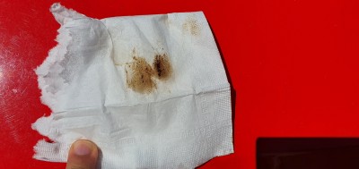

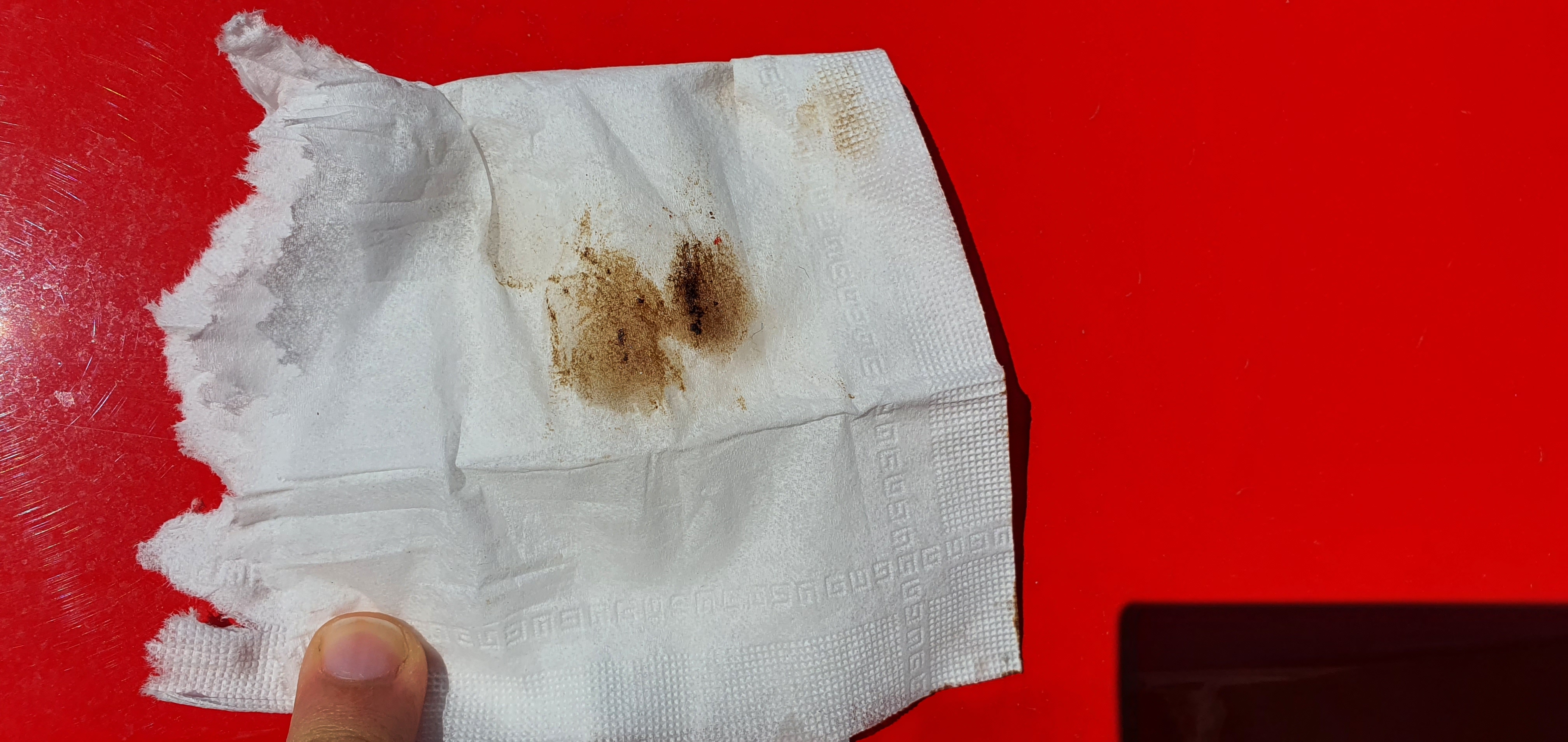

I figured if it was fuel id smell it, mmm, maybe it is fluid from the washers, ill test tomorrow and try put some of it on a paper towel and pot pics.

Seems like oil, almost like engine oil.

Is it not just that colour because it has been in contact with one of the sound damping material, there is absolutely no reason why anything like engine oil or any other oil could get there from some part of the car.
Could this not just be that something has been spilt in there some time ago, and maybe even have soaked into the foam cushion material of the rear seat base?

This is new oil, cleaned a few week ago and checked yesterday and it new oil, are the seats oiled by any chance, also would there be oil in the dampners?

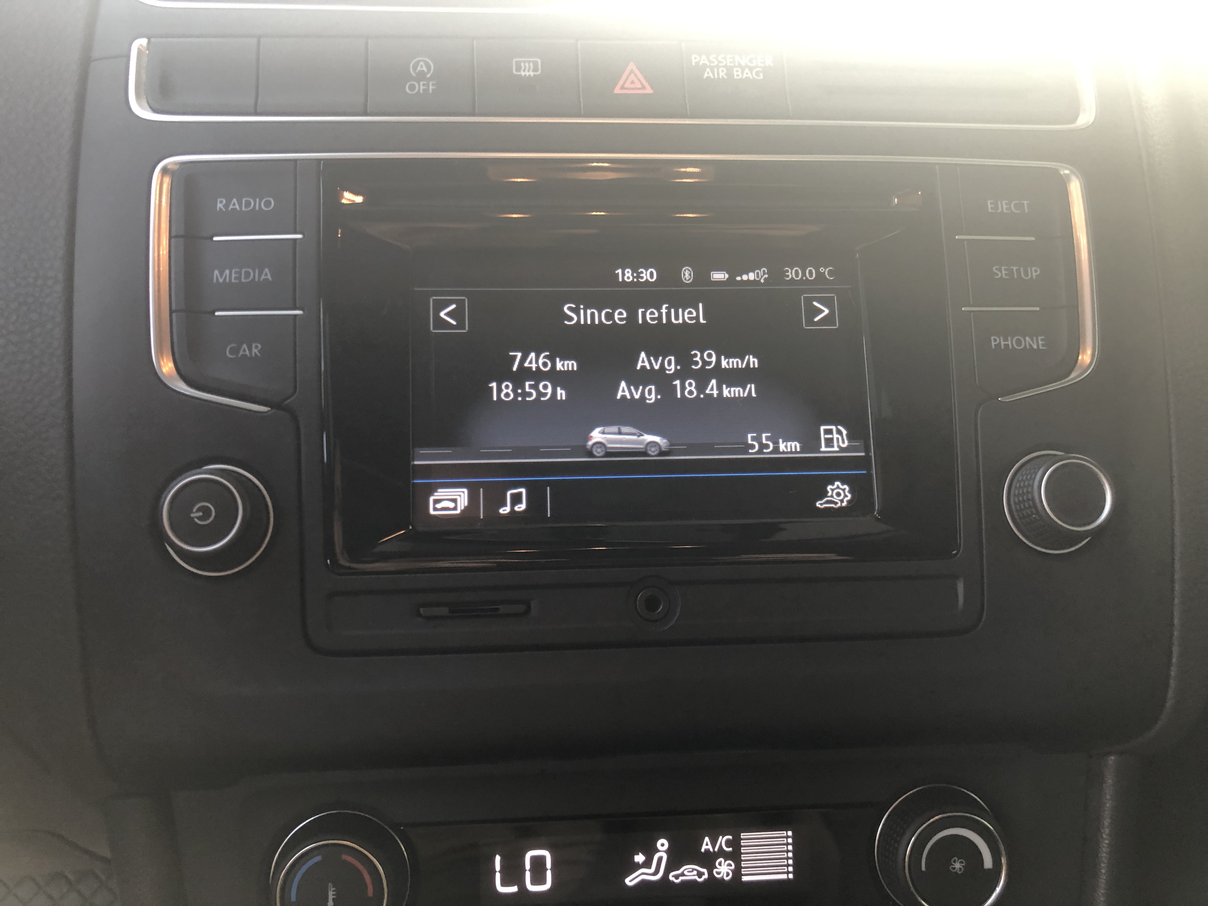

I completely forgot about this thread. Haven’t posted on this forum for a while. But during Covid, when I was an essential worker I actually used my polo more often than I used it regularly (now has 76k km
I then had 215/45 16 tires (Falken ze914) and used to aggressively hypermile (cruised on 80-90 kph behind busses and trucks). Managed 750 km for a tank! Now I have 17 inch tires and more sporty Michelin pilot sport 4’s a dsg tune (which hold more revs and gets to boost earlier which is very nice), plus a lot more traffic so I’m lucky to get 550-ish
