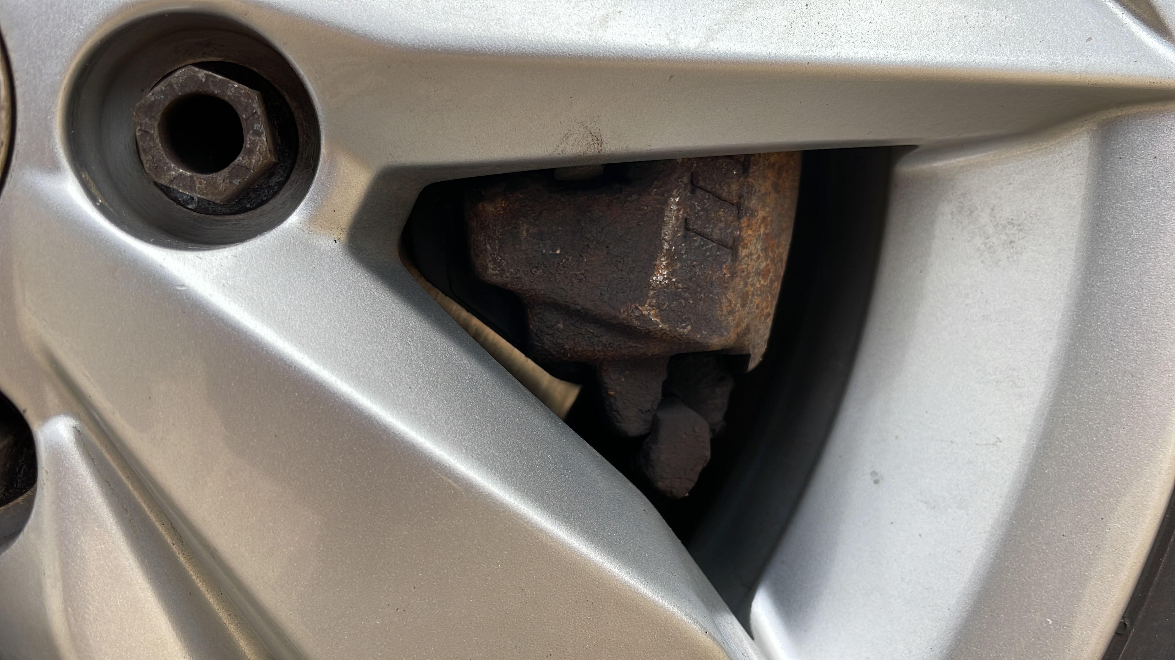

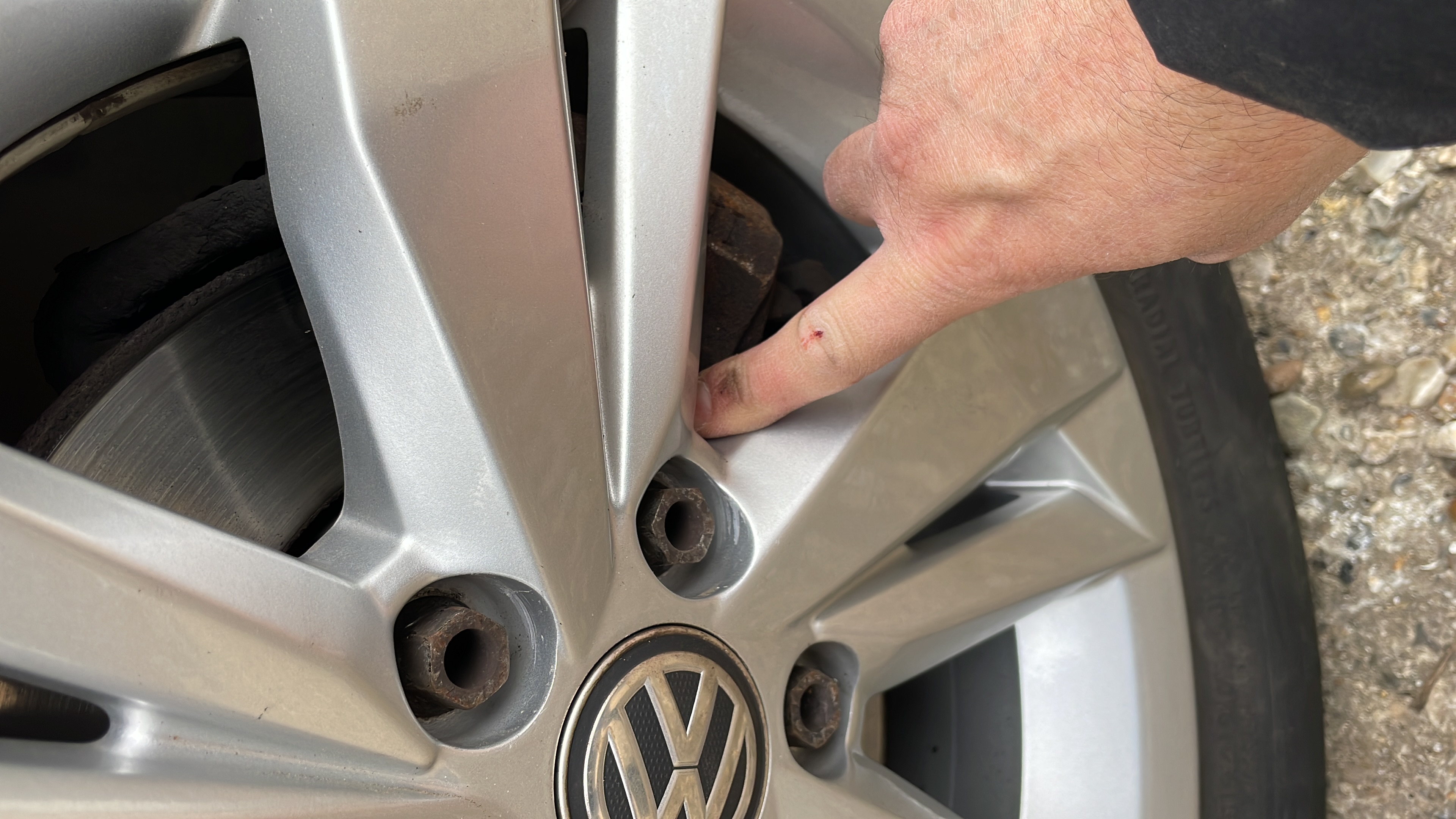

front wheels - again very snug -but caliper seems to be in way - as in the wheel wont go round as touching the caliper.

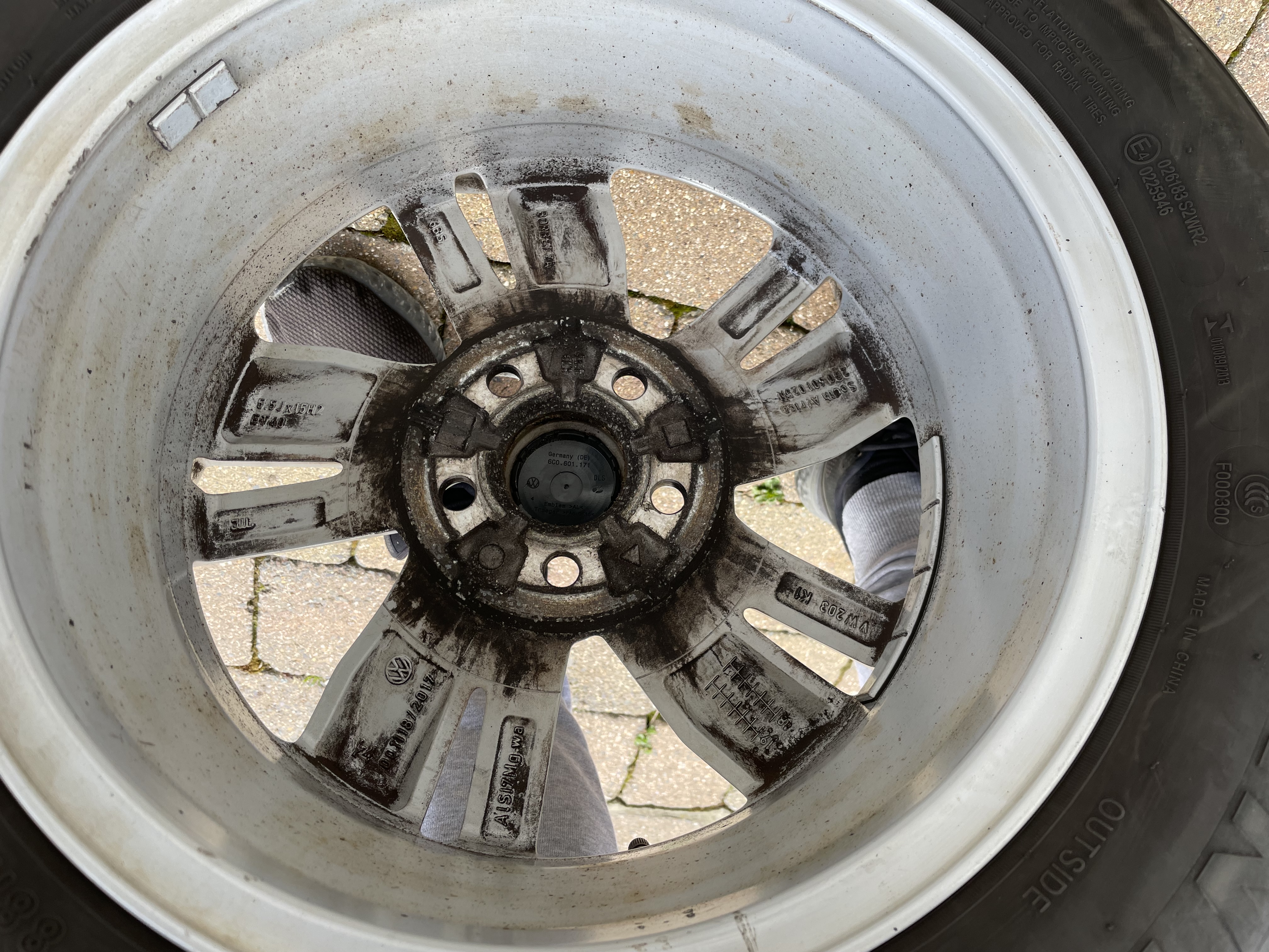

Attached is a pic of the wheels showing the calliper practically touching the wheel since put back to joe it was another pic showing the inside of the 15” wheel
A Friend mentioned a spacer and longer bolts on the front wheels should do the job?

So its properly the ET number that is wrong with your new set of wheels, check the ET number on the steelies that you removed and check the difference .
If your set on fitting those wheels you could just fit a wheel spacer and longer bolts ,this will move the wheel away from the brakes and also look better

They definitely look to be genuine VW alloys. However, they’re not from a 6R or 6C model Polo - from the part number (2G0 601 025N) they’re the standard ‘Sassari’ alloys from a 2018-2022 (AW) model Polo SE - see picture below;
If the brake callipers on the AW model Polo are a different design to the callipers on your car (I don’t know if they are), that probably explains why you have possible clearance issues.

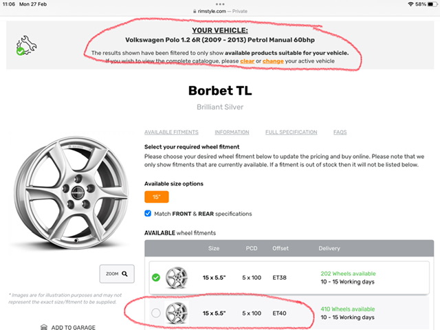

I’ve checked on one of the alloy wheel retailer websites (Rimstyle.com) to see if they confirm 5.5J x15 ET40 alloys are an appropriate size for your car and they do confirm they’ll fit - see screenshot below. However, the design of some alloy wheel’s spokes may mean that not all 5.5J x15” ET40 alloys will fit your car and could give brake callipers clearance issues.
You could fit spacers and longer bolts; if you do this, make certain any replacement bolts are of the correct thread and that they have a radius / ball head so the bolt head profile matches the profile of the bolt hole in the wheels. Also, fitting different sized / spec alloys and / or wheel spacers is a modification for insurance purposes, so you’d need to inform your insurance company and they may increase your premium (some insurance companies are more mod-friendly than others).
Be aware that the tyre in the first picture you posted is fitted the wrong way round on the wheel - the outside of the tyre is on the inside of the wheel so needs to be refitted (worth checking the others too).

SRGTD wrote: Mon Feb 27, 2023 12:01 pm Be aware that the tyre in the first picture you posted is fitted the wrong way round on the wheel - the outside of the tyre is on the inside of the wheel so needs to be refitted (worth checking the others too).
Good spot sir :D

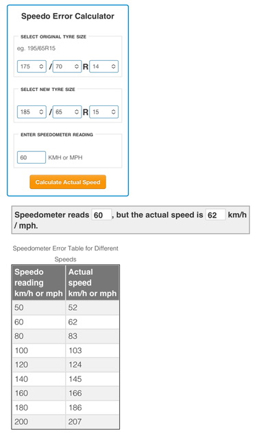

@parkie23; the overall rolling radius of the wheels / tyres you’re planning on fitting to your car should be the same as the rolling radius of your existing wheel / tyre set up, otherwise your speedo reading will be incorrect. I’m assuming that on your 14 steel wheels your tyres are 175/70 R14; if so, then to maintain the same overall rolling radius with 15” alloys, you’ll need 185/60 R15 tyres, which is what VW fitted to the to 15” alloys on the 6R / 6C Polo.
VW fitted 185/65 R15 tyres to the Sassari alloys on the AW model Polo SE. These have a larger rolling radius than your existing wheel / tyre set up so will result in your speedo understating the true speed of your car (see below), which is illegal in the UK. Therefore, you will need to budget for a new set of 185/60 R15 tyres - that’s assuming the Sassari alloys you’re planning on fitting have 185/65 R15 tyres fitted on them (as per factory spec for the AW model Polo SE).
https://www.tyresizecalculator.com/tyre ... calculator

You will need a wheel spacer. Maybe 2mm spacer will work and probably you could keep your factory wheel bolts. Double check it.

Out of the 4 wheels only the one on show has the tyre on wrong way round
Spacers are ordered and also longer wheel bolts
The tyres on the new alloys are 185/65/R15. Guess no good and will need to get 185/60 r15
