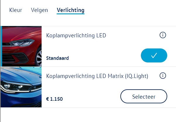

AFAIK all polo AW have LED headlights.
Only difference is normal LED or matrix IQ LED
Schermafbeelding 2023-03-21 142021.jpg (39.79 KiB) Viewed 7994 times
Translation:
Headlight LED (standard)
Headlight LED Matrix (IQ.Light)

Maarten wrote: Tue Mar 21, 2023 1:18 pm AFAIK all polo AW have LED headlights.
Translation:
In the UK, all facelift (BZ) Polos have LED headlights but with the pre-facelift (AW) model, only the GTI+ model had LED headlamps as standard; they were an extra cost option on all other trim levels other than the entry level ‘S’ model where they weren’t available.
@RealInsky; your forum signature shows your car as a 2021 Polo in Comfortline trim. If those details are correct, then a 2021 model Polo will be a facelift car in which case as @Maarten has said, your car should already have LED headlights.

Yes I should have been more clear, my suspicion was that TS had a FL version.
The pre FL had also halogen lights
Thanks for your correction @srgtd :wink: :D
